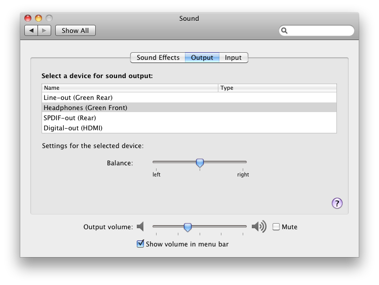

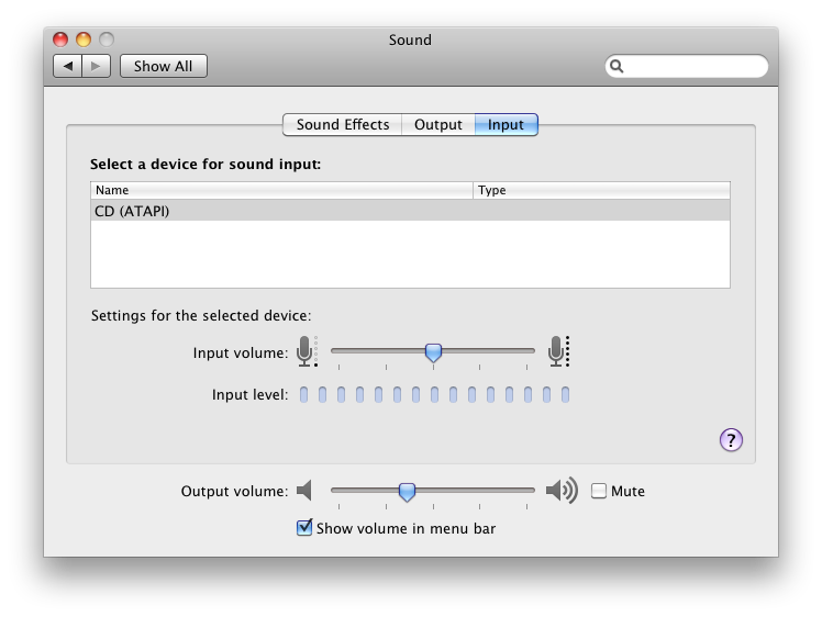

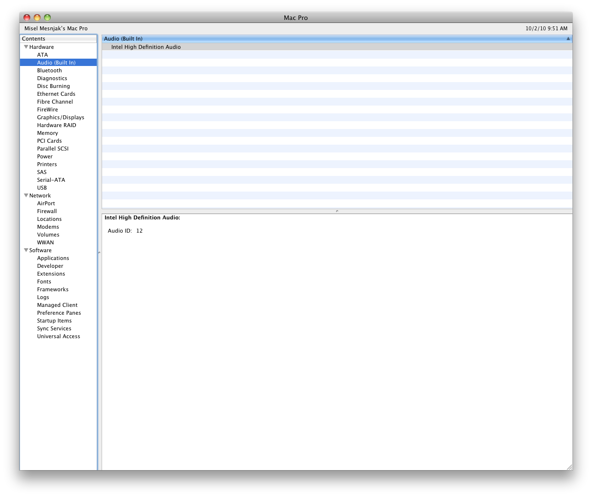

mmesh Posted October 2, 2010 Share Posted October 2, 2010 try itback up and remove Applehda.kext OK. I tried it. I now have working headphone output (front of the case) but no working input (microphone doesn't show in the list and CD is the only item - see the attached screenshots). if you use the HDEFneeds the legacy Look it http://www.insanelymac.com/forum/index.php...t&p=1325322 OK. I'll look into it. Thanks! P.S. The editor is great - I made patches for the SBRG -> LPCB , _T_0 -> T_0 , _T_1 -> T_1 renaming Patches.zip Link to comment https://www.insanelymac.com/forum/topic/223205-dsdt-editor-and-patcher/page/15/#findComment-1557937 Share on other sites More sharing options...

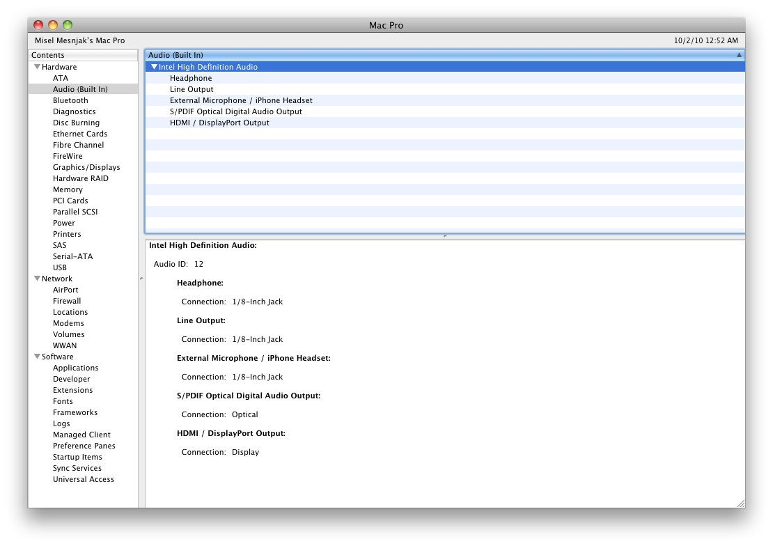

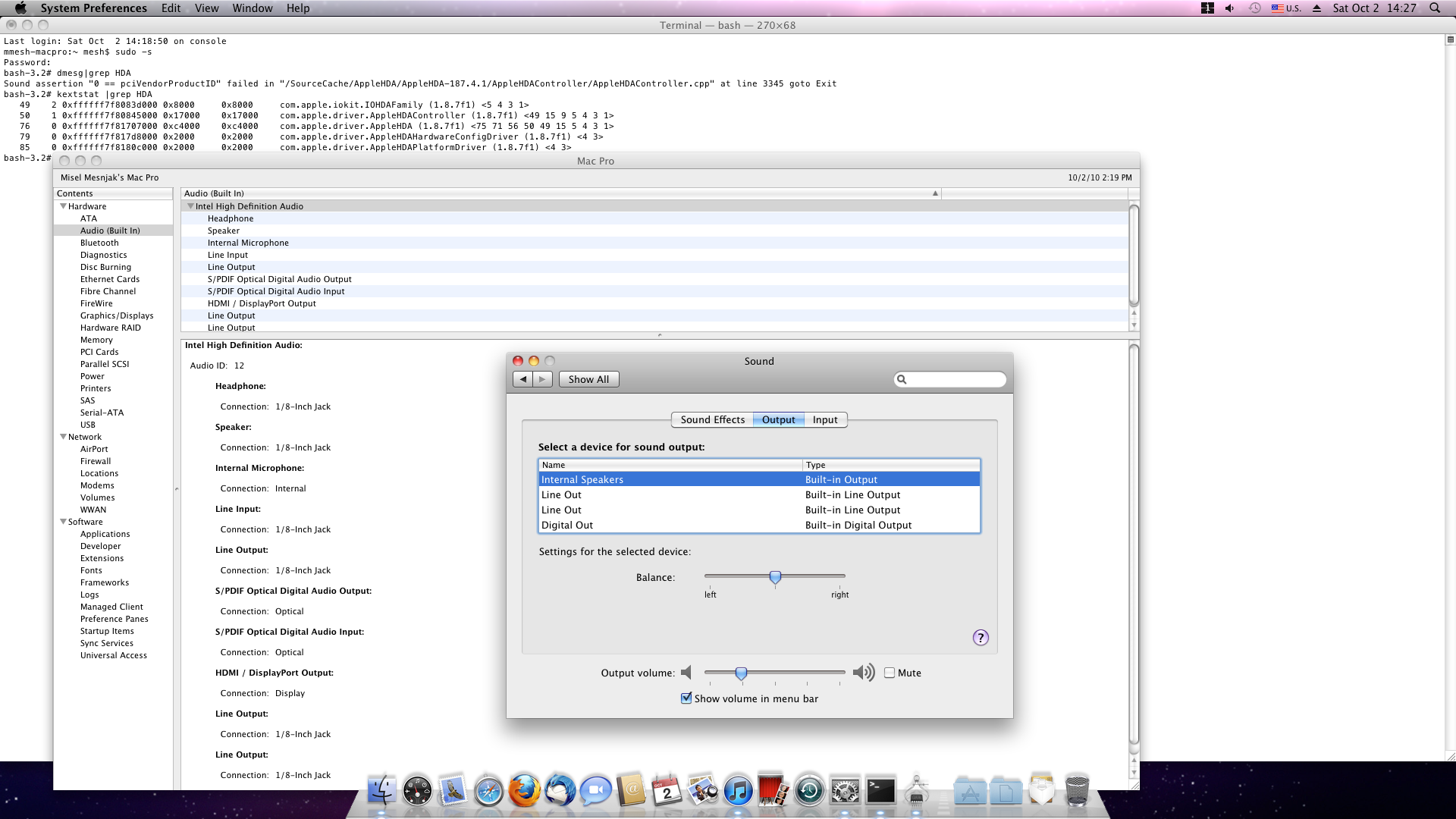

mmesh Posted October 2, 2010 Share Posted October 2, 2010 is the best solution Well... I'm almost there I used HDEF and AD2000B patch for the DSDT , AD2000b.kext in /E/E from the link You provided and bin patched version(for AD2000B) of AppleHDA.kext in /S/L/E Now I have the situation You can see in the attached screenshot... I have working audio out and microphone in on the back green and pink ports. What I was really hoping is that I could use front (on the case) headphones(green) and mic(pink) ports and alternatively use HDMI out (on GTX 470). What is confusing to me is that I have almost all sound in/out ports listed in System Profiler but don't have all listed in System Preferences->Sound Link to comment https://www.insanelymac.com/forum/topic/223205-dsdt-editor-and-patcher/page/15/#findComment-1558015 Share on other sites More sharing options...
kizwan Posted October 2, 2010 Share Posted October 2, 2010 What is confusing to me is that I have almost all sound in/out ports listed in System Profiler but don't have all listed in System Preferences->Sound All in & out listed in the System Profiler just cosmetic. The list was parsed from the ConfigData & PinConfigurations you set in the DSDT. What you see in System Preferences are actually the real audio in & out your computer have. Link to comment https://www.insanelymac.com/forum/topic/223205-dsdt-editor-and-patcher/page/15/#findComment-1558023 Share on other sites More sharing options...

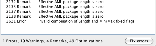

pdave54 Posted October 7, 2010 Share Posted October 7, 2010 Am wanting to use DSDT for GMA950 (Device ID: 0x2772) with vanilla kexts I understand I have to apply DTGP patch as well as the GMA950 Desktop patch. Is that correct? I tried to compile an unpatched dsdt.aml but have run into a problem. Compile has an error Line 2621 is 0x0AC00000, // Length I apply "Fix Errors" button and the line changes to 0x7ac00000, // Length After the fix, still will not compile and gives the same error . Any idea how to fix this please. dsdt.dsl.zip Link to comment https://www.insanelymac.com/forum/topic/223205-dsdt-editor-and-patcher/page/15/#findComment-1560293 Share on other sites More sharing options...

pdave54 Posted October 7, 2010 Share Posted October 7, 2010 DWordMemory (ResourceProducer, PosDecode, MinNotFixed, MaxFixed, NonCacheable, ReadWrite, 0x00000000, // Granularity 0x00000000, // Range Minimum 0xEFFFFFFF, // Range Maximum 0x00000000, // Translation Offset 0x00000000, // Length ,, _Y02, AddressRangeMemory, TypeStatic) DWordMemory (ResourceProducer, PosDecode, MinNotFixed, MaxFixed, NonCacheable, ReadWrite, 0x00000000, // Granularity 0x84000000, // Range Minimum 0xFEBFFFFF, // Range Maximum 0x00000000, // Translation Offset 0x7ac00000, // Length ,, _Y03, AddressRangeMemory, TypeStatic) DWordMemory (ResourceProducer, PosDecode, MinNotFixed, MaxNotFixed, NonCacheable, ReadWrite, 0x00000000, // Granularity 0xFFA80800, // Range Minimum 0xFFA80BFF, // Range Maximum 0x00000000, // Translation Offset 0x00000400, // Length ,, _Y04, AddressRangeMemory, TypeStatic) dsdt.dsl.zip Link to comment https://www.insanelymac.com/forum/topic/223205-dsdt-editor-and-patcher/page/15/#findComment-1560330 Share on other sites More sharing options...

oldnapalm Posted October 7, 2010 Author Share Posted October 7, 2010 DWordMemory (ResourceProducer, PosDecode, MinNotFixed, MaxFixed, NonCacheable, ReadWrite, 0x00000000, // Granularity 0x00000000, // Range Minimum 0xEFFFFFFF, // Range Maximum 0x00000000, // Translation Offset 0x00000000, // Length ,, _Y02, AddressRangeMemory, TypeStatic) DWordMemory (ResourceProducer, PosDecode, MinNotFixed, MaxFixed, NonCacheable, ReadWrite, 0x00000000, // Granularity 0x84000000, // Range Minimum 0xFEBFFFFF, // Range Maximum 0x00000000, // Translation Offset 0x7ac00000, // Length ,, _Y03, AddressRangeMemory, TypeStatic) DWordMemory (ResourceProducer, PosDecode, MinNotFixed, MaxNotFixed, NonCacheable, ReadWrite, 0x00000000, // Granularity 0xFFA80800, // Range Minimum 0xFFA80BFF, // Range Maximum 0x00000000, // Translation Offset 0x00000400, // Length ,, _Y04, AddressRangeMemory, TypeStatic) dsdt.dsl.zip I don't understand, in this case the compiler expects length to be 0x00000000. Any ideas? Maybe because of arguments MinNotFixed and MaxFixed? Change length manually from 0x7ac00000 to 0x00000000 and it will compile without errors. Link to comment https://www.insanelymac.com/forum/topic/223205-dsdt-editor-and-patcher/page/15/#findComment-1560563 Share on other sites More sharing options...
Time2Retire Posted October 7, 2010 Share Posted October 7, 2010 I don't understand, in this case the compiler expects length to be 0x00000000. Any ideas? Maybe because of arguments MinNotFixed and MaxFixed? Change length manually from 0x7ac00000 to 0x00000000 and it will compile without errors. Using 0x00000000 won't do much good. Replacing "MinNotFixed" with "MinFixed" however will solve the error (length should be correctly specified, as is) Fix the parameter and you are done. Link to comment https://www.insanelymac.com/forum/topic/223205-dsdt-editor-and-patcher/page/15/#findComment-1560574 Share on other sites More sharing options...
kirasir Posted October 7, 2010 Share Posted October 7, 2010 Maximum – Minimum = Lenth +1 Link to comment https://www.insanelymac.com/forum/topic/223205-dsdt-editor-and-patcher/page/15/#findComment-1560639 Share on other sites More sharing options...
pdave54 Posted October 7, 2010 Share Posted October 7, 2010 I don't understand, in this case the compiler expects length to be 0x00000000. Any ideas? Maybe because of arguments MinNotFixed and MaxFixed? Change length manually from 0x7ac00000 to 0x00000000 and it will compile without errors. Thank you oldnapalm. Changing the length manually allow me to compile. System boots fine with un-patched dsdt.aml Applied DTGP & GMA950 Desktop patches and again had to change the same line manually to compile. Unfortunately on boot with patched dsdt.aml I get a plain grey screen when it gets to the log-in screen. With an the earlier AppleIntelIntegratedFramebuffer 1.4.20 video acceleration & resolutions are fine, whether I have a DSDT or not. Defeats the purpose somewhat. With the latest AppleIntelIntegratedFramebuffer 1.6.18 - Without dsdt, I have acceleration but no resolution choices With dsdt - Grey screen patcheddsdt.aml.zip IORegistryExplorer_output.zip com.apple.Boot.plist Graphics Mode 1024x768x32 GraphicsEnabler y Kernel legacy_kernel Kernel Flags arch=i386 PciRoot 1 Timeout 5 info.plist frame buffer 1.4.20 CFBundleDevelopmentRegion English CFBundleExecutable AppleIntelIntegratedFramebuffer CFBundleGetInfoString AppleIntelIntegratedFramebuffer 1.4.20.28 CFBundleIdentifier com.apple.driver.AppleIntelIntegratedFramebuffer CFBundleInfoDictionaryVersion 6.0 CFBundleName com.apple.driver.AppleIntelIntegratedFramebuffer CFBundlePackageType KEXT CFBundleShortVersionString 1.4.20 CFBundleSignature ???? CFBundleVersion 4.2.0 IOKitPersonalities AppleIntelIntegratedFramebuffer CFBundleIdentifier com.apple.driver.AppleIntelIntegratedFramebuffer IOClass AppleIntelIntegratedFramebuffer IOMatchCategory IOFramebuffer IOPCIClassMatch 0x03000000&0xff000000 IOPCIMatch 0x00008086&0x0000ffff IOProbeScore 80000 IOProviderClass IOPCIDevice IOSourceVersion 1.4.20.28 OSBundleLibraries com.apple.iokit.IOGraphicsFamily 1.3 com.apple.kernel.iokit 1.3 OSBundleRequired Safe Boot info.plist frame buffer 1.6.18 CFBundleDevelopmentRegion English CFBundleExecutable AppleIntelIntegratedFramebuffer CFBundleGetInfoString AppleIntelIntegratedFramebuffer 1.6.18.18 CFBundleIdentifier com.apple.driver.AppleIntelIntegratedFramebuffer CFBundleInfoDictionaryVersion 6.0 CFBundleName com.apple.driver.AppleIntelIntegratedFramebuffer CFBundlePackageType KEXT CFBundleShortVersionString 1.6.18 CFBundleSignature ???? CFBundleVersion 6.1.8 IOKitPersonalities AppleIntelIntegratedFramebuffer CFBundleIdentifier com.apple.driver.AppleIntelIntegratedFramebuffer IOClass AppleIntelIntegratedFramebuffer IOMatchCategory IOFramebuffer IOPCIClassMatch 0x03000000&0xff000000 IOPCIPrimaryMatch 0x25828086 0x25928086 0x27728086 0x27A28086 IOProbeScore 80000 IOProviderClass IOPCIDevice IOSourceVersion 1.6.18.18 NSHumanReadableCopyright Copyright © 1999-2009 Apple Inc. All rights reserved. OSBundleLibraries com.apple.iokit.IOACPIFamily 1.2 com.apple.iokit.IOGraphicsFamily 1.3 com.apple.iokit.IOPCIFamily 1.1 com.apple.kpi.bsd 8.0.0 com.apple.kpi.iokit 8.0.0 com.apple.kpi.libkern 8.0.0 com.apple.kpi.mach 8.0.0 com.apple.kpi.unsupported 8.0.0 OSBundleRequired Safe Boot Link to comment https://www.insanelymac.com/forum/topic/223205-dsdt-editor-and-patcher/page/15/#findComment-1560725 Share on other sites More sharing options...
oldnapalm Posted October 7, 2010 Author Share Posted October 7, 2010 @kirasir actually it's "length = max - min + 1". @pdave54 that's strange, for desktop GMA950 the DSDT patch should be enough, using default kexts. I saw the gray screen issue in laptop GMA950, solved with the "AAPL,HasPanel" property. I know you have a desktop, but you may try it anyway. "AAPL,HasPanel", Buffer (0x04) { 0x01, 0x00, 0x00, 0x00\n } GMA950_pdave54.txt How many video outputs does your card have? BTW, the package size in "GMA 950 desktop" patch was wrong, it was 0x1A, should be 0x06, but I believe it was not the problem. EDIT: please see dutchhockeypro's post about the compilation error. Link to comment https://www.insanelymac.com/forum/topic/223205-dsdt-editor-and-patcher/page/15/#findComment-1560755 Share on other sites More sharing options...
