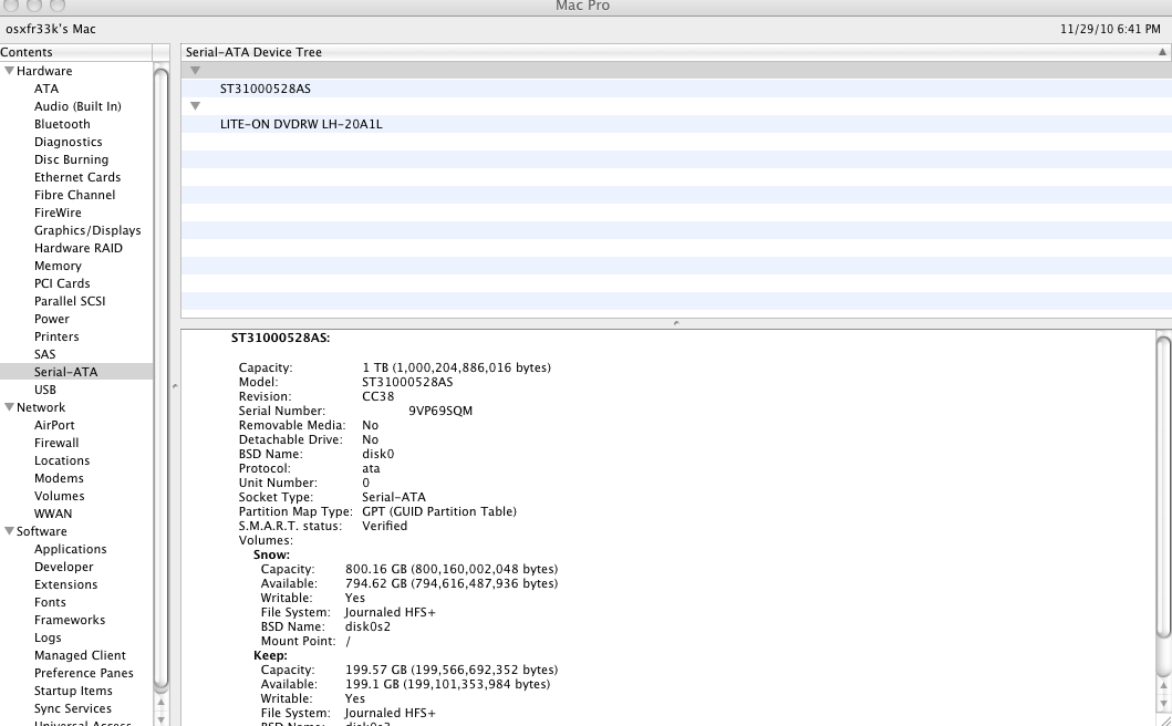

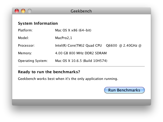

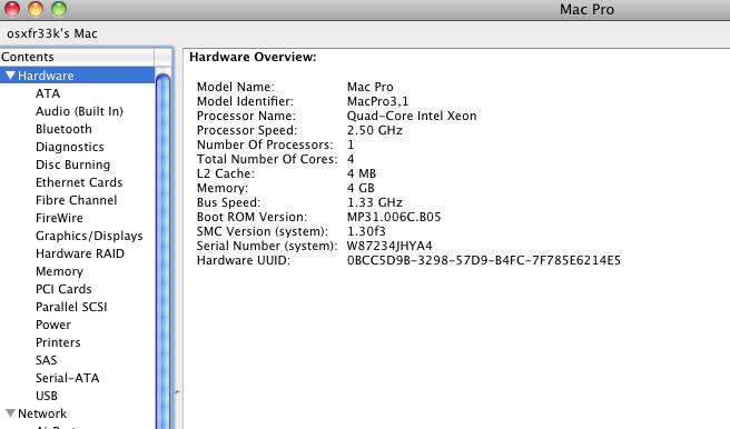

oSxFr33k Posted November 30, 2010 Share Posted November 30, 2010 @MaLd0n, Hey thanks so much again for this great project you have released. Auto Patcher and DSDT editor are the next huge leaps in OSX86 since the inception of the Chameleon Boot Loader. I don't know what the issue is but I thought the DSDT auto patcher fixed ICH7 Serial-ATA in System profiler for the GA-G41-ES2L? I don't have CSTinfo either on the MB? See Ioreg. I am not using smbios.plist for any of my systems since the new chameleon seems to take care of this. Here are a couple of screenshots showing you this and a screenshot of the Hardware. I have also attached the DSDT I just patched with the latest Auto Patcher along with Ioreg, kextstat and kernel.log DSDT_IOREG_KEXTSTAT_and_Kernel.log.zip Link to comment https://www.insanelymac.com/forum/topic/223205-dsdt-editor-and-patcher/page/24/#findComment-1593807 Share on other sites More sharing options...
MaLd0n Posted November 30, 2010 Share Posted November 30, 2010 @MaLd0n,Hey thanks so much again for this great project you have released. Auto Patcher and DSDT editor are the next huge leaps in OSX86 since the inception of the Chameleon Boot Loader. I don't know what the issue is but I thought the DSDT auto patcher fixed ICH7 Serial-ATA in System profiler for the GA-G41-ES2L? I don't have CSTinfo either on the MB? See Ioreg. I am not using smbios.plist for any of my systems since the new chameleon seems to take care of this. Here are a couple of screenshots showing you this and a screenshot of the Hardware. I have also attached the DSDT I just patched with the latest Auto Patcher along with Ioreg, kextstat and kernel.log I use SMBIOS macpro2, 1 Chameleon show me how to hackintosh smbios.plist.zip this motherboard is very compatible, but no AHCI try a legacy, but I do not know This is cosmetic And if you use HD and DVD SATA You do not need kext works natively "CSTInfo" = 19136773 "PerformanceStateArray" = (,,,) My brother has an identical motherboard hackintosh 98% fakesmc -> 2% perfect Link to comment https://www.insanelymac.com/forum/topic/223205-dsdt-editor-and-patcher/page/24/#findComment-1593818 Share on other sites More sharing options...
oSxFr33k Posted November 30, 2010 Share Posted November 30, 2010 @MaLd0n, Yes HD and DVD Drive are SATA. SO weird. And your brother has CSTinfo in Ioreg under SMC right? I have to look over my CMOS settings. I enabled C1E C2/C4 all of them. I have tried combinations and that has not helped. The only thing I am not using is the smbios.plist. Sorry I accidently posted here and meant in the other thread. Have you looked over my attachments and everything looks ok? Thanks Link to comment https://www.insanelymac.com/forum/topic/223205-dsdt-editor-and-patcher/page/24/#findComment-1593842 Share on other sites More sharing options...
MaLd0n Posted November 30, 2010 Share Posted November 30, 2010 And your brother has CSTinfo in Ioreg under SMC right? Yep ioreg -lw0 | grep CSTInfo if it returns a value then you have c-state data loading. Link to comment https://www.insanelymac.com/forum/topic/223205-dsdt-editor-and-patcher/page/24/#findComment-1593857 Share on other sites More sharing options...
