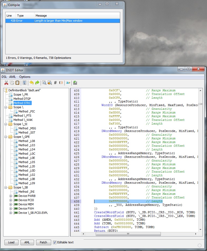

fbifido Posted October 11, 2010 Share Posted October 11, 2010 To: El Coniglio & oldnapalm Just like to know a few think: When you load a dsl file you see: [+] Scope _PR Method PRIO Method RDMA Method _PIC Method OSFL Method MCTH Method GPRW Method OSYS [+]Scope _SB [+]Scope _SB [+]Scope _SB [+]Scope _SB [+]Scope _SB.PCI0 [+]Scope _TZ [+]Scope _SB.PCI0 [+]Scope _SB Method _PTS Method _WAK Method PTS Method WAK 1. Does all motherboards have the same setup and above as in the name use (eg _PR)? 2. Can you all show a picture of all the Scope & Method 3. Why are there so many “Scope _SB”? 4. Can you have 1 Scope _SB and have all the other Scope _SB fall under it? The first [+] Scope _SB.PCI0 has a Method _OSC and The second [+] Scope _SB.PCI0 has [+] Device GFX0 I was wondering if all fix can be based on the dsdt label that’s if all the dsdt labels on all the motherboards are the same. I notes that my dsdt have 2 Scope \_GPE Link to comment https://www.insanelymac.com/forum/topic/223205-dsdt-editor-and-patcher/page/17/#findComment-1563004 Share on other sites More sharing options...
oldnapalm Posted October 12, 2010 Author Share Posted October 12, 2010 1. Does all motherboards have the same setup and above as in the name use (eg _PR)? 2. Can you all show a picture of all the Scope & Method 3. Why are there so many “Scope _SB”? 4. Can you have 1 Scope _SB and have all the other Scope _SB fall under it? The editor shows items in tree exactly as they are in DSDT. Each BIOS has its own DSDT structure. Some names are the same in various mobos (_PR, _SB, _GPE, ...) but some are not (SBRG, LPCB, ...), read namespace (5.3) of ACPI specification for detailed info. That's the way your DSDT is organized, you could reorganize it, but I'm not sure if it would still work. I was wondering if all fix can be based on the dsdt label that’s if all the dsdt labels on all the motherboards are the same. The problem is that they are not the same on all mobos, that's why we included options to patch by label, _ADR and _HID. Link to comment https://www.insanelymac.com/forum/topic/223205-dsdt-editor-and-patcher/page/17/#findComment-1563055 Share on other sites More sharing options...

fbifido Posted October 12, 2010 Share Posted October 12, 2010 from GB EP43 DS3L cartri.net realse 0.8 (EP43DS3L.08) i can ask him about the orientation of the Scopes, but every thing is on lock and keys with his project now, untill he completes it. with bootloader in bios and no need for dsdt. maybe he needs to make a bootrom, like put the loader into a etherboot wrapper like gPXE, and put it in his GB mac bios. dsdl2.zip Link to comment https://www.insanelymac.com/forum/topic/223205-dsdt-editor-and-patcher/page/17/#findComment-1563405 Share on other sites More sharing options...
oldnapalm Posted October 12, 2010 Author Share Posted October 12, 2010 If you are using a modified BIOS I guess you shouldn't need to edit DSDT, since it's already modified for Mac OS. By the screenshot I think you are using and old version of the editor (no "fix errors" button in compile window). Link to comment https://www.insanelymac.com/forum/topic/223205-dsdt-editor-and-patcher/page/17/#findComment-1563407 Share on other sites More sharing options...

fbifido Posted October 12, 2010 Share Posted October 12, 2010 warning message "Possible operator timeout is ignoreg" cause by "Acquire (MUTE, 0x0FFF)" and "Acquire (MUTE, 0x03E8)" change the "0x0FFF" and "0x3E8" to "0xFFFF" Link to comment https://www.insanelymac.com/forum/topic/223205-dsdt-editor-and-patcher/page/17/#findComment-1563472 Share on other sites More sharing options...

fbifido Posted October 12, 2010 Share Posted October 12, 2010 no error no warnings 0 remarks 239 Optimizations can you check this file for me. thanks inluded: ECS G41T-M v2 RAW.dsl - un mod dsdt file ECS G41T-M v2.dsl - mod dsdt file ecs_g41t_m_v2.rar Link to comment https://www.insanelymac.com/forum/topic/223205-dsdt-editor-and-patcher/page/17/#findComment-1563491 Share on other sites More sharing options...
oldnapalm Posted October 12, 2010 Author Share Posted October 12, 2010 @fbifido Your changes look fine, but I don't know if all patches you applied are really needed (LPC, SATA). Patch for "Possible operator timeout is ignored" into_all all code_regex (Acquire\s\(MUTE,\s0x)....\) replace_matched begin %1FFFF) end @surfstu What did you change in your DSDT? I see you added method DTGP but it's not used. It has several compiling errors (with latest IASL) that can be auto fixed by the editor. If you post a picture of the KP screen it may be easier to find the cause than looking at the DSDT. Link to comment https://www.insanelymac.com/forum/topic/223205-dsdt-editor-and-patcher/page/17/#findComment-1563508 Share on other sites More sharing options...

fbifido Posted October 13, 2010 Share Posted October 13, 2010 @fbifido Your changes look fine, but I don't know if all patches you applied are really needed (LPC, SATA). Patch for "Possible operator timeout is ignored" into_all all code_regex (Acquire\s\(MUTE,\s0x)....\) replace_matched begin %1FFFF) end ??????? (Acquire\s\(MUTE,\s0x)....\) ???????? i tried copy and paste this code but got error message how do you tell dsdt editor using patch to search for "string1" and replace with "string2"? Sorry, I messed the version numbers, forgot to increment in last release. Please download from post #1 again. About the reserved names remarks, mmesh made a patch here, I will add to the package in next release http://www.insanelymac.com/forum/index.php...t&p=1557937 "found BUFFER, requires Package" should be auto fixed in latest version. Can you make one change on the first post? 1. under download just add "Last Update: Date (dd/mm/yyyy)" Link to comment https://www.insanelymac.com/forum/topic/223205-dsdt-editor-and-patcher/page/17/#findComment-1563953 Share on other sites More sharing options...

oldnapalm Posted October 13, 2010 Author Share Posted October 13, 2010 ??????? (Acquire\s\(MUTE,\s0x)....\) ???????? i tried copy and paste this code but got error message how do you tell dsdt editor using patch to search for "string1" and replace with "string2"? Did you copy and paste all the code? Try loading from file, I tried with your DSDT and it works. Possible_operator_timeout_is_ignored.txt For a single string replacement you can use into_all all code_regex string1 replaceall_matched begin string2 end The "Possible operator timeout is ignored" patch above will replace any value (used as second argument for Acquire (MUTE, 0x????)) by 0xFFFF. Can you make one change on the first post? 1. under download just add "Last Update: Date (dd/mm/yyyy)" Done. Link to comment https://www.insanelymac.com/forum/topic/223205-dsdt-editor-and-patcher/page/17/#findComment-1563977 Share on other sites More sharing options...
fbifido Posted October 13, 2010 Share Posted October 13, 2010 Greatwork like a charm i just got it, i had to type it out in one line. Did you copy and paste all the code? Try loading from file, I tried with your DSDT and it works.Possible_operator_timeout_is_ignored.txt For a single string replacement you can use into_all all code_regex string1 replaceall_matched begin string2 end The "Possible operator timeout is ignored" patch above will replace any value (used as second argument for Acquire (MUTE, 0x????)) by 0xFFFF. Done. Thank you. Link to comment https://www.insanelymac.com/forum/topic/223205-dsdt-editor-and-patcher/page/17/#findComment-1563983 Share on other sites More sharing options...
