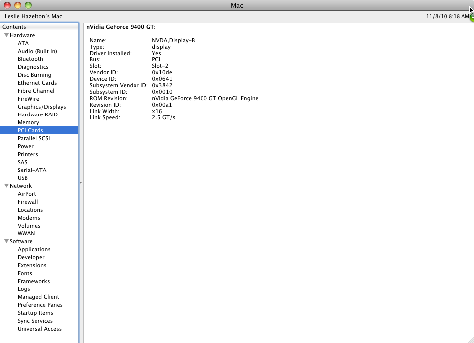

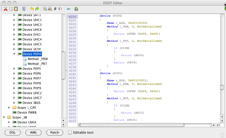

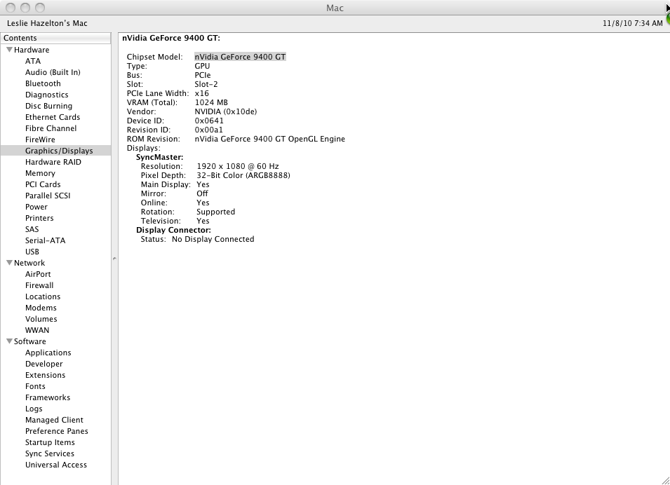

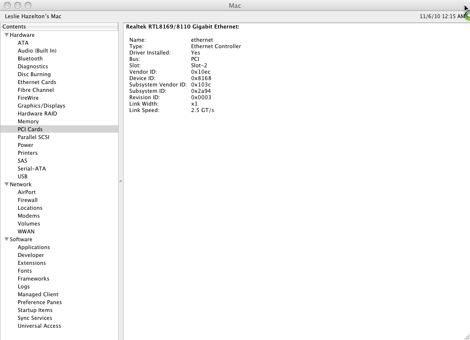

BladeRunner Posted November 8, 2010 Share Posted November 8, 2010 First, many thanks and much gratitude to MaLd0n for the Auto-Patch he made for me. My system runs better and has fewer legacy/patched kext since installing it. I have added additional patches for my nVidia GeForce 9400 GT (moded GFX 9800 patch) and ethernet (moded LAN0) cards. Actually, the ethernet adapter is integrated into the system board and the display adapter is a PCIe plugin. With these last two dsdt patches I quit using the "Graphics Enabler" and "Ethernet Built-in" injections supplied by Chameleon2. Where I could use some help now is in getting the remainder of my PCIe adapter cards recognized in the System Profiler. The adapters are all recognized and functioning in OS X. I understand that having them show in System Profiler is mainly cosmetic. Still, It seams like they should be recognized there. For example, my OS X is installed on a hardware raid 1 volume connected by an eSATA adapter in a PCIe x1 slot. However, System Profiler does not show the pci card for the raid controller. Unique dsdt patches for each pci card would work, but the best solution - if there is one - would be for the pci cards to be recognized without that. Any help or guidance would be greatly appreciated. dsdt_ioreg.zip Link to comment https://www.insanelymac.com/forum/topic/223205-dsdt-editor-and-patcher/page/22/#findComment-1578724 Share on other sites More sharing options...
Time2Retire Posted November 8, 2010 Share Posted November 8, 2010 ... Where I could use some help now is in getting the remainder of my PCIe adapter cards recognized in the System Profiler. You can add Name (_SUN, 0xnn) for slot info, and experiment with some new properties in _DSM: "device_type", "HW Type Info", "model", "HW Model Info", "name", "HW Name Info" I hope this helps. Link to comment https://www.insanelymac.com/forum/topic/223205-dsdt-editor-and-patcher/page/22/#findComment-1578740 Share on other sites More sharing options...
BladeRunner Posted November 8, 2010 Share Posted November 8, 2010 You can add Name (_SUN, 0xnn) for slot info, and experiment with some new properties in _DSM: "device_type", "HW Type Info", "model", "HW Model Info", "name", "HW Name Info" I hope this helps. Thanks. It's a start and, more than I had before. Will give it a try. Link to comment https://www.insanelymac.com/forum/topic/223205-dsdt-editor-and-patcher/page/22/#findComment-1578777 Share on other sites More sharing options...
