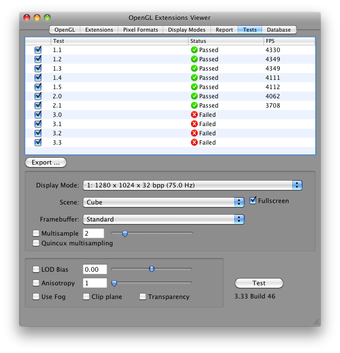

Gringo Vermelho Posted November 17, 2010 Share Posted November 17, 2010 Mine with the 10.6.5 nvidia drivers on a 9800GTX+, C2D E8500, P45/ICH10R, MacPro3,1 model identifier, Chameleon GraphicsEnabler, 1280x1024x32: So far confirmed working with the latest drivers are GTX 460, 465 (w/HDMI), 470, 480 (w/HDMI sound even). That accounts for all GF100 and GF104 chip cards. No one has confirmed the GTX 580 as working, but its device ID is present in NVDAGF100Hal.kext. Link to comment https://www.insanelymac.com/forum/topic/214219-fermigtx-480gtx-470/page/43/#findComment-1585422 Share on other sites More sharing options...

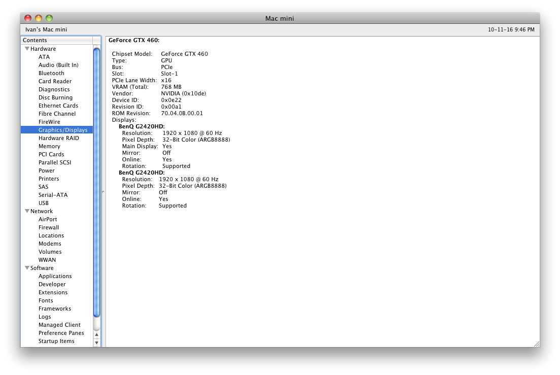

ivan300 Posted November 17, 2010 Share Posted November 17, 2010 Here is what I did to get my 460 working Installed 10.6.3 using nawcoms modcd Updated to 10.6.5 (i had to use vnc to update the usb kext as im on the legacy kernel) With GraphicsEnabler=Yes The Nvidia Driver said my system is unsupported. So i right clicked on the driver and selected show package contents. Inside there will be three installers. I ran all three one at the time and rebooted Link to comment https://www.insanelymac.com/forum/topic/214219-fermigtx-480gtx-470/page/43/#findComment-1585451 Share on other sites More sharing options...
