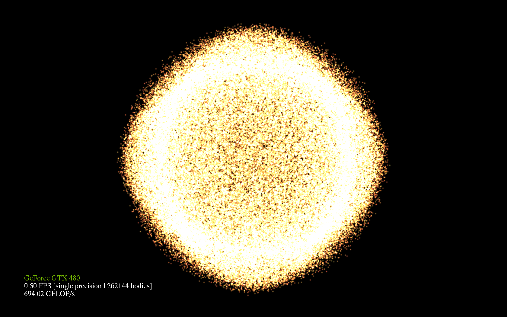

cmf Posted November 22, 2010 Author Share Posted November 22, 2010 Any news about the amount of working CUDA Cores?I have the GTX 480 and get only 240 CUDA Cores with Flam4CUDA. Thanks, Rodrigo. probably the programs fault. cuda deviceqry reports the correct amount of cores: Device 0: "GeForce GTX 480" CUDA Driver Version: 3.20 CUDA Runtime Version: 3.20 CUDA Capability Major/Minor version number: 2.0 Total amount of global memory: 1610153984 bytes Multiprocessors x Cores/MP = Cores: 15 (MP) x 32 (Cores/MP) = 480 (Cores) Total amount of constant memory: 65536 bytes Total amount of shared memory per block: 49152 bytes Total number of registers available per block: 32768 Warp size: 32 Maximum number of threads per block: 1024 Maximum sizes of each dimension of a block: 1024 x 1024 x 64 Maximum sizes of each dimension of a grid: 65535 x 65535 x 1 Maximum memory pitch: 2147483647 bytes Texture alignment: 512 bytes Clock rate: 1.40 GHz Concurrent copy and execution: Yes Run time limit on kernels: Yes Integrated: No Support host page-locked memory mapping: Yes Compute mode: Default (multiple host threads can use this device simultaneously) Concurrent kernel execution: Yes Device has ECC support enabled: No Device is using TCC driver mode: No oh, and: Link to comment https://www.insanelymac.com/forum/topic/214219-fermigtx-480gtx-470/page/48/#findComment-1588942 Share on other sites More sharing options...
