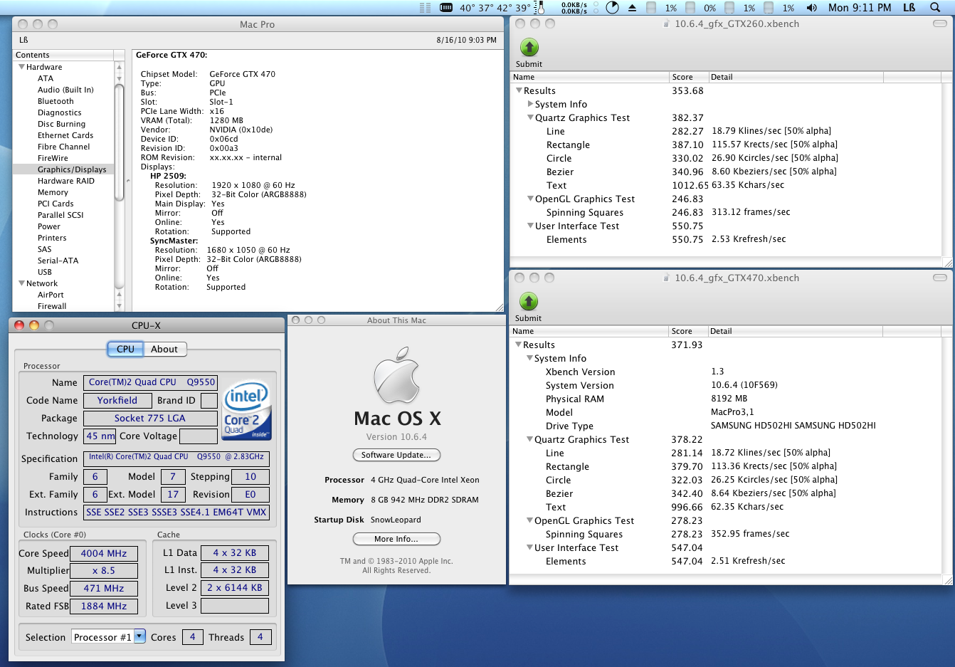

elbasofolous Posted August 17, 2010 Share Posted August 17, 2010 vjkevlar, please look at the screenshots on post one, then compare the xbench score in the ss to your own. if I understand correctly, IF you manage to get qe/ci and resolution functional, there is still vsync and powermizer(as in, the board doesnt step up the clock when the os needs it to) to think of. It looks like gtx480 is the most cut-and-dry solution, but not worth it if its for osx only as you may only be running at the lowest powermizer profile(for instance, my gtx260 smashes the 480's score in the xbenches ive seen). to answer your other questions - on my evga 470, idles are around 70, loads never above 81, and fan always around 40-50%. was it hard to get working? Ill let u know when I get it working(fingers crossed for fishinrocks95 method)... and it appears that nobody has zero hiccups yet(forumers, correct me if im wrong) - from reading the thread alone you can be sure that an upgrade is not going to gain you anything especially if you are relying on it for VJing (likely will take a performance hit until better support comes along) hope this helps also would like to note(not singling out vjkevlar), it is accumulation of posts like this that cause threads to become blown up and thus a tough read for everyone - please read what's here before making additions Link to comment https://www.insanelymac.com/forum/topic/214219-fermigtx-480gtx-470/page/22/#findComment-1531763 Share on other sites More sharing options...
