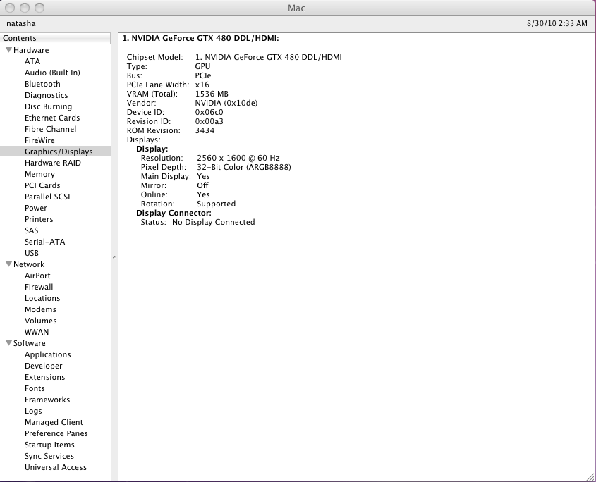

aqua-mac Posted August 30, 2010 Share Posted August 30, 2010 Can you post the info from the graphics part of system profiler. I have 3 GTX 480's installed take a look here: Does yours say rotation supported? Link to comment https://www.insanelymac.com/forum/topic/214219-fermigtx-480gtx-470/page/25/#findComment-1539856 Share on other sites More sharing options...
ky13 Posted August 30, 2010 Share Posted August 30, 2010 Can you post the info from the graphics part of system profiler. I have 3 GTX 480's installed take a look here: Does yours say rotation supported? Wow, quite the braggart. =) I don't get *any* 480 devices to show up. All I get is: Display: Type: GPU Bus: PCIe PCIe Lane Width: x16 VRAM (Total): 64 MB Vendor: NVIDIA (0x10de) Device ID: 0x06c0 Revision ID: 0x00a3 Displays: Display: Resolution: 1600 x 1200 Pixel Depth: 32-Bit Color (ARGB8888) Main Display: Yes Mirror: Off Online: Yes Link to comment https://www.insanelymac.com/forum/topic/214219-fermigtx-480gtx-470/page/25/#findComment-1539872 Share on other sites More sharing options...
aqua-mac Posted August 30, 2010 Share Posted August 30, 2010 You are probably going to have to use GFX strings. Unpack the 2 files with this post onto your desktop (take them out of the folder and place directly onto your desktop) Open up the terminal (Utilities folder) Copy/paste into the terminal window: cd ~/desktop THEN HIT RETURN then copy/paste into terminal window: ./gfxutil -f display and hit return again. This will reveal the path to your PCIe slot with your graphics card in. Post the path back here and I will make the strings for you. They are different for every motherboard. It should look something like this: DevicePath = PciRoot(0x0)/Pci(0x3,0x0)/Pci(0x0,0x0)/Pci(0x0,0x0)/Pci(0x0,0x0) GFX_strings.zip Link to comment https://www.insanelymac.com/forum/topic/214219-fermigtx-480gtx-470/page/25/#findComment-1539879 Share on other sites More sharing options...

aqua-mac Posted August 30, 2010 Share Posted August 30, 2010 Upload your com.apple.boot.plist from your extra folder and I will modify it for you. 10.6.4 does not make any difference to strings, they will work for any .update Link to comment https://www.insanelymac.com/forum/topic/214219-fermigtx-480gtx-470/page/25/#findComment-1539888 Share on other sites More sharing options...
ky13 Posted August 30, 2010 Share Posted August 30, 2010 Upload your com.apple.boot.plist from your extra folder and I will modify it for you. 10.6.4 does not make any difference to strings, they will work for any .update Here it is. com.apple.Boot.plist.zip Link to comment https://www.insanelymac.com/forum/topic/214219-fermigtx-480gtx-470/page/25/#findComment-1539889 Share on other sites More sharing options...
aqua-mac Posted August 30, 2010 Share Posted August 30, 2010 Now replace the one in your extra folder with this one below. Look in your System/Extensions folder and make sure you don't have nvinject.kext or any other form of graphics injector kext. com.apple.Boot.plist.zip Link to comment https://www.insanelymac.com/forum/topic/214219-fermigtx-480gtx-470/page/25/#findComment-1539893 Share on other sites More sharing options...

ky13 Posted August 30, 2010 Share Posted August 30, 2010 Now replace the one in your extra folder with this one below. Look in your System/Extensions folder and make sure you don't have nvinject.kext or any other form of graphics injector kext. Replacing my /Extra/com.apple.Boot.plist with the one you gave me worked perfectly. It even booted in 2650x1600. Link to comment https://www.insanelymac.com/forum/topic/214219-fermigtx-480gtx-470/page/25/#findComment-1539905 Share on other sites More sharing options...
