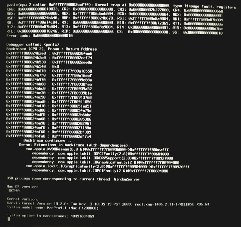

ErmaC Posted March 18, 2010 Share Posted March 18, 2010 Okay now I am 100% convinced is my graphics card, because, I just checked PROCESSOR INDEPENDENT New image drive w P6TdeluxeInstaller Installed booted w GraphicsEnabler =n and guess what... there was no screen image ( as expected) however my sounds was playing the intro video sound, Meaning my USB was working, and I am certain it just gets disabled in X mode all I need to do is get a compatible GraphicsCard for my config, d you have any suggestion? Now i'm at work... Some post ago dgobe post a list of compatible gfx native wuth the bootloader... Fabio Link to comment https://www.insanelymac.com/forum/topic/208724-guide-new-snow-leopard-retail-on-asus-p6t-deluxe-v1v2/page/18/#findComment-1431030 Share on other sites More sharing options...

qbe Posted March 19, 2010 Share Posted March 19, 2010 Okay now I am 100% convinced is my graphics card my friend has 3870 and he had very hard time making it work in snow leopard. it worked in regular leopard, but he couldnt make it in snow leopard. i guess you are out of luck, unless there is something new going on (he tried half a year ago) for new card, gtx260 is used a lot on forums or get older second hand 8800gt. as long as you get the two-DVI version, you are fine. if you dont want problems, stay away from the dvi/vga/hdmi-combo cards, really. Link to comment https://www.insanelymac.com/forum/topic/208724-guide-new-snow-leopard-retail-on-asus-p6t-deluxe-v1v2/page/18/#findComment-1431284 Share on other sites More sharing options...
ErmaC Posted March 19, 2010 Share Posted March 19, 2010 my friend has 3870 and he had very hard time making it work in snow leopard. it worked in regular leopard, but he couldnt make it in snow leopard. i guess you are out of luck, unless there is something new going on (he tried half a year ago) for new card, gtx260 is used a lot on forums or get older second hand 8800gt. as long as you get the two-DVI version, you are fine. if you dont want problems, stay away from the dvi/vga/hdmi-combo cards, really. dbe you are right! So as described qbe... before buy a new card... try if yours 2x38xx works with OSX version 10.5.x (Leopard). Fabio Link to comment https://www.insanelymac.com/forum/topic/208724-guide-new-snow-leopard-retail-on-asus-p6t-deluxe-v1v2/page/18/#findComment-1431381 Share on other sites More sharing options...

dutchmarcus Posted March 19, 2010 Share Posted March 19, 2010 my friend has 3870 and he had very hard time making it work in snow leopard. it worked in regular leopard, but he couldnt make it in snow leopard. i guess you are out of luck, unless there is something new going on (he tried half a year ago) for new card, gtx260 is used a lot on forums or get older second hand 8800gt. as long as you get the two-DVI version, you are fine. if you dont want problems, stay away from the dvi/vga/hdmi-combo cards, really. I really appreciate you giving me this feedback, I am looking into buying a new card. Club 3D CGNX-G9824G, Green edition DVI Asus ENGTX260 GL+/2DI (Retail, TV-Out, 2x DVI) I guess both of these should work double DVI, any suggestion on these choices? @Fabio, I prefer to make it work on snow, I am used to it by now, and have the disk Link to comment https://www.insanelymac.com/forum/topic/208724-guide-new-snow-leopard-retail-on-asus-p6t-deluxe-v1v2/page/18/#findComment-1431425 Share on other sites More sharing options...

dutchmarcus Posted March 19, 2010 Share Posted March 19, 2010 I really appreciate you giving me this feedback, I am looking into buying a new card. Club 3D CGNX-G9824G, Green edition DVI Asus ENGTX260 GL+/2DI (Retail, TV-Out, 2x DVI) I guess both of these should work double DVI, any suggestion on these choices? @Fabio, I prefer to make it work on snow, I am used to it by now, and have the disk Yah that' great w the new Graphics cards I am able to install on run it normally, however upon restart after installed my WIFI adapter I got the screen (press power etc), meaning it's incompatible. I am re-installing fresh Is there something I can do to work around it this since the adapter it's a new one sitecom 352 micro ( MAC compatible) 300N wifi adapter? Thanks Link to comment https://www.insanelymac.com/forum/topic/208724-guide-new-snow-leopard-retail-on-asus-p6t-deluxe-v1v2/page/18/#findComment-1431586 Share on other sites More sharing options...
