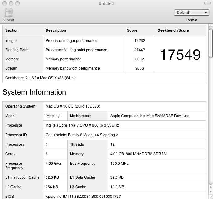

Golden Brown Posted May 31, 2010 Share Posted May 31, 2010 Geekbench: Default = 8726 OC = 11661 Link to comment https://www.insanelymac.com/forum/topic/199818-snow-leopard-install-for-asus-p6x58d-premium/page/10/#findComment-1478844 Share on other sites More sharing options...
noespam Posted May 31, 2010 Share Posted May 31, 2010 Geekbench: Default = 8726 OC = 11661 Do you have SpeedStep enabled in the BIOS for your overclock? Post #73 had issues as well with low GeekBench scores. That's how I discovered NullCPUPowerManagement was the key to getting better scores on my setup. Anyway, the machine is performing well and I'm at about the same score as you. Still, it bothers me not knowing why I have to load the NullCPU kext when others don't. Update ===== I figured out why my GeekBench OC scores were low. I am using the newest 10.3.1 vanilla mach_kernel since I used [url="http://www.insanelymac.com/forum/topic/279450-why-insanelymac-does-not-support-tonymacx86/"]#####[/url]-Supported booter instead of boot-132. boot-132 was not working for me. Anyway, there are performance implications if things are not patched in the DSDT or NullCPU is not installed. See Darwin 10.3.1 kernel Link to comment https://www.insanelymac.com/forum/topic/199818-snow-leopard-install-for-asus-p6x58d-premium/page/10/#findComment-1478857 Share on other sites More sharing options...
Golden Brown Posted May 31, 2010 Share Posted May 31, 2010 I do have SpeedStep Enabled The only thing I changed was my AI Clocking to manual, BLCK = 191, DRAM Bus = 1527 Other than that everything else is auto. Resolved the RAM Issues (Was using another Chameleon boot by accident) But now my Geekbench is 11387 (dropped 300) Im going to try NullCPUPowerManagment, and see if my score improves. EDIT: With NullCPUPower = 11680 (Recovered my ground and gained a few points ) Link to comment https://www.insanelymac.com/forum/topic/199818-snow-leopard-install-for-asus-p6x58d-premium/page/10/#findComment-1478868 Share on other sites More sharing options...
noespam Posted May 31, 2010 Share Posted May 31, 2010 I do have SpeedStep EnabledThe only thing I changed was my AI Clocking to manual, BLCK = 191, DRAM Bus = 1527 Other than that everything else is auto. Resolved the RAM Issues (Was using another Chameleon boot by accident) But now my Geekbench is 11387 (dropped 300) Im going to try NullCPUPowerManagment, and see if my score improves. EDIT: With NullCPUPower = 11680 (Recovered my ground and gained a few points ) Usually when OCing to 4.0Ghz, you don't want to leave anything to chance by using Auto or having SpeedStep on. Have you stress tested it? I usually run LinX at full memory for at least 25 passes in Win7 x64. I wouldn't worry too much the difference between 11387 and 11680. GeekBench scores fluctuate. Link to comment https://www.insanelymac.com/forum/topic/199818-snow-leopard-install-for-asus-p6x58d-premium/page/10/#findComment-1478875 Share on other sites More sharing options...
user01100 Posted May 31, 2010 Share Posted May 31, 2010 I do have SpeedStep EnabledThe only thing I changed was my AI Clocking to manual, BLCK = 191, DRAM Bus = 1527 Other than that everything else is auto. Resolved the RAM Issues (Was using another Chameleon boot by accident) But now my Geekbench is 11387 (dropped 300) Im going to try NullCPUPowerManagment, and see if my score improves. EDIT: With NullCPUPower = 11680 (Recovered my ground and gained a few points ) People that are using Null kext (noespam, you etc), when that kext is loaded you're are actually not running apple native (stock) power management extensions. AppleIntelCPUPowerManagement.kext is blocked, AppleIntelCPUPowerManagementClient.kext, AppleHPET.kext are not loading too. Just a remark. You can simply check this in system profiler>Extensions. Link to comment https://www.insanelymac.com/forum/topic/199818-snow-leopard-install-for-asus-p6x58d-premium/page/10/#findComment-1478892 Share on other sites More sharing options...

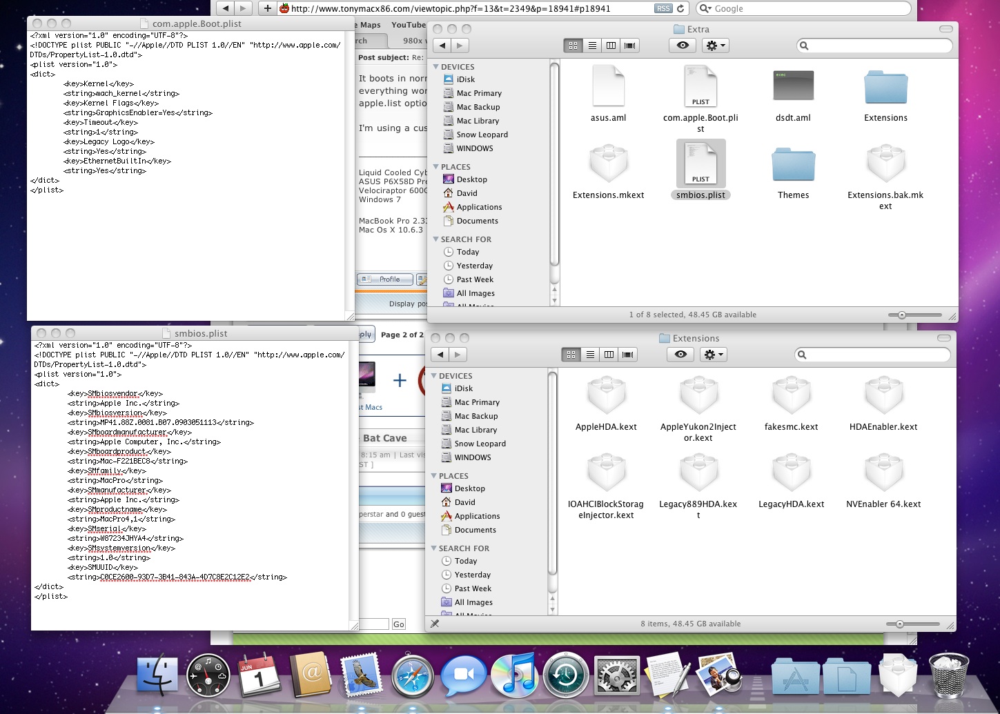

djsuperstarla Posted June 1, 2010 Share Posted June 1, 2010 Most of everything works except for audio and 64bit... Attaching the extra folder Link to comment https://www.insanelymac.com/forum/topic/199818-snow-leopard-install-for-asus-p6x58d-premium/page/10/#findComment-1479902 Share on other sites More sharing options...
kup Posted June 1, 2010 Share Posted June 1, 2010 10.6.3 or .2 ? Have you added the AppleHDA linked by User_01? If so, try removing LegacyHDA and rebuild the .mkext and see if it fixes it. Link to comment https://www.insanelymac.com/forum/topic/199818-snow-leopard-install-for-asus-p6x58d-premium/page/10/#findComment-1480088 Share on other sites More sharing options...
user01100 Posted June 1, 2010 Share Posted June 1, 2010 Most of everything works except for audio and 64bit...Attaching the extra folder Of course it doesn't! First, AppleHDA.kext doesn't have its place in E/E (Extra/Extensions). Second, if it isn't the binary patched version from (10.6.3) or a stock (vanilla) version from 10.6.2 or below, will not work anyway. Third, 2 legacy for audio in E/E, that's not going to help either; remove the Legacy889 one and keep the other (if is the one from kup's pack), and the HDAEnabler too. Fourth, if you actually did some reading in this thread, you could have seen that someone else already asked this (regarding your problem). ---pages in this thread that must be seen --7,8,9 --- before you're asking something; otherwise we'll be responding to the same questions over and over again; i think is pointless for a helping thread, this way... p.s.- i think you actually don't need the NVEnabler kext too (this depends on your video card); the com.apple.Boot.plist in Extra already has the graphics enabler feature set to yes; and if you're using the booter from kup's pack then you're set -you need only 5 kexts in Extra, 1 in S/L/E (system>library>extensions) for a working 10.6.3 Link to comment https://www.insanelymac.com/forum/topic/199818-snow-leopard-install-for-asus-p6x58d-premium/page/10/#findComment-1480119 Share on other sites More sharing options...
kup Posted June 1, 2010 Share Posted June 1, 2010 Oh wow yeah. lol I totally missed those extra kexts. :/ I really do wish people would read before asking questions that have been answered numerous times. Cheers for having the patience that I'm starting to lack, User_01. Link to comment https://www.insanelymac.com/forum/topic/199818-snow-leopard-install-for-asus-p6x58d-premium/page/10/#findComment-1480124 Share on other sites More sharing options...
user01100 Posted June 1, 2010 Share Posted June 1, 2010 Oh wow yeah. lol I totally missed those extra kexts. :/ I really do wish people would read before asking questions that have been answered numerous times. Cheers for having the patience that I'm starting to lack, User_01. Takes less time to post something, then doing some research first and then, after you're pretty sure you can find the answer, is better to ask. Link to comment https://www.insanelymac.com/forum/topic/199818-snow-leopard-install-for-asus-p6x58d-premium/page/10/#findComment-1480137 Share on other sites More sharing options...

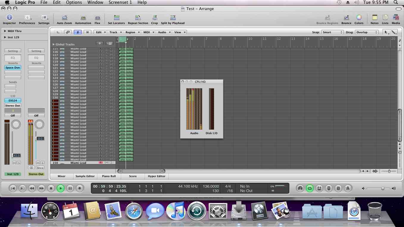

djsuperstarla Posted June 2, 2010 Share Posted June 2, 2010 My M-Audio Profire is working, anyways will try to fix the onboard audio as well... By the way I wanted to try the power of this CPU beast so I installed Logic Pro 9 opened 150 instances of ESX24 and Space Designer, 32 samples, minimum latency. I hit the play button and it worked!!! In the meantime I was downloading 1Mb/s full bandwidth and installing other softwares... Link to comment https://www.insanelymac.com/forum/topic/199818-snow-leopard-install-for-asus-p6x58d-premium/page/10/#findComment-1480331 Share on other sites More sharing options...
djsuperstarla Posted June 2, 2010 Share Posted June 2, 2010 Ok audio fully functioning. While my firewire card is plugged I keep getting very annoying sounds like crackles sometimes high pitched it's not very loud but I can hear it. Anybody had the same issue? I installed iMac1,1 from [url="http://www.insanelymac.com/forum/topic/279450-why-insanelymac-does-not-support-tonymacx86/"]#####[/url], used the command -force64 and it allowed me to run GeekBench64 Geebench score: 17549 vs 15000 in 32bit although under about this mac say 64-bit Kernel and Extensions: No How do I fix this? Link to comment https://www.insanelymac.com/forum/topic/199818-snow-leopard-install-for-asus-p6x58d-premium/page/10/#findComment-1480369 Share on other sites More sharing options...
