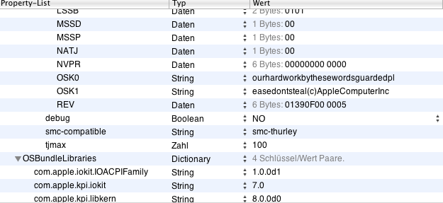

d00d Posted September 29, 2010 Author Share Posted September 29, 2010 Fellas, How do you convert 1.39f11 for fakesmc please? http://prasys.info/2009/11/editing-fakesmc/ Link to comment https://www.insanelymac.com/forum/topic/196771-ga-ex58-and-ga-x58a-dsdt-native-power-management-modifications/page/43/#findComment-1556453 Share on other sites More sharing options...
sch8mid Posted September 29, 2010 Share Posted September 29, 2010 http://prasys.info/2009/11/editing-fakesmc/ did that , as you described some weaks ago @ your first post this is a screen of fakesmc : and this is how systemprofiler looks like : What went wrong ?, sorry no clue best armin Link to comment https://www.insanelymac.com/forum/topic/196771-ga-ex58-and-ga-x58a-dsdt-native-power-management-modifications/page/43/#findComment-1556493 Share on other sites More sharing options...
d00d Posted September 29, 2010 Author Share Posted September 29, 2010 did that , as you described some weaks ago @ your first post this is a screen of fakesmc : and this is how systemprofiler looks like : What went wrong ?, sorry no clue best armin The Info.plist file that you show in the editor isn't the one being loaded, and if you want it to show 1.39f11, use <01390f00 0011>. Link to comment https://www.insanelymac.com/forum/topic/196771-ga-ex58-and-ga-x58a-dsdt-native-power-management-modifications/page/43/#findComment-1556554 Share on other sites More sharing options...

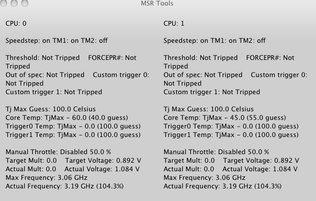

kdawg Posted September 29, 2010 Share Posted September 29, 2010 Here's another multiplier question. Does anyone see any other p-state multipliers in Mark-i other then the min and max for their core i7 processors? For my 930 all I ever see is 11 and 21. Just wondering if Mark-i picks up the in between ones. My p-states appear in the ioreg and my CSTInfo=0x1240105. Link to comment https://www.insanelymac.com/forum/topic/196771-ga-ex58-and-ga-x58a-dsdt-native-power-management-modifications/page/43/#findComment-1556706 Share on other sites More sharing options...

kdawg Posted September 29, 2010 Share Posted September 29, 2010 Hey, Dawg!You did not even told us the news on your hardware ahn? Just a PS: CSTINFO is in a 7 digit algarism muuuuch likely an ioreg without the hex option So maybe if you research about this number in HEX ( 12 EC 29 - you may have 2 zeros before or afftar if its a 4-byte wise declaration) you might find more on your researches. Good luck! , "Orange icon getaway" Yeah I just recently got the X58. Figured it was time to graduate. I've been laying low otherwise. Link to comment https://www.insanelymac.com/forum/topic/196771-ga-ex58-and-ga-x58a-dsdt-native-power-management-modifications/page/43/#findComment-1556854 Share on other sites More sharing options...
FKA Posted September 29, 2010 Share Posted September 29, 2010 mmmhhh: no multiplierchange .... what went wrong ? Hay mate Try with voodoomonitor, works for me 32 and 64. Kext in S/L/E VoodooMonitor.zip D Link to comment https://www.insanelymac.com/forum/topic/196771-ga-ex58-and-ga-x58a-dsdt-native-power-management-modifications/page/43/#findComment-1556861 Share on other sites More sharing options...
kdawg Posted September 29, 2010 Share Posted September 29, 2010 Hay mate Try with voodoomonitor, works for me 32 and 64. Kext in S/L/E VoodooMonitor.zip D Will do. Thanks! Link to comment https://www.insanelymac.com/forum/topic/196771-ga-ex58-and-ga-x58a-dsdt-native-power-management-modifications/page/43/#findComment-1556866 Share on other sites More sharing options...
sch8mid Posted September 30, 2010 Share Posted September 30, 2010 Hey, Dawg!You did not even told us the news on your hardware ahn? Just a PS: CSTINFO is in a 7 digit algarism muuuuch likely an ioreg without the hex option So maybe if you research about this number in HEX ( 12 EC 29 - you may have 2 zeros before or afftar if its a 4-byte wise declaration) you might find more on your researches. Good luck! , Hi cartri companero carioca nice to see you here Where is my X58 -UD 5 Rev. 2.0 BIOS ? had to steal my DSDT from kdawg venceremos a @ FkA thanks -gonna try it this evening Link to comment https://www.insanelymac.com/forum/topic/196771-ga-ex58-and-ga-x58a-dsdt-native-power-management-modifications/page/43/#findComment-1556982 Share on other sites More sharing options...
kdawg Posted September 30, 2010 Share Posted September 30, 2010 Hay mate Try with voodoomonitor, works for me 32 and 64. Kext in S/L/E VoodooMonitor.zip D Strange all it does is crash my system. I get a KP. I removed ringaccess.kext of course. I went back to look at the console and I see a buttload of this. 9/28/10 6:04:06 AM [0x0-0x18f18f].ru.mark.mark-i[1823] REG=73 v=1.168000 9/28/10 6:04:06 AM [0x0-0x18f18f].ru.mark.mark-i[1823] REG=72 v=1.152000 9/28/10 6:04:06 AM [0x0-0x18f18f].ru.mark.mark-i[1823] REG=73 v=1.168000 9/28/10 6:04:06 AM [0x0-0x18f18f].ru.mark.mark-i[1823] REG=72 v=1.152000 9/28/10 6:04:06 AM [0x0-0x18f18f].ru.mark.mark-i[1823] REG=74 v=1.184000 9/28/10 6:04:06 AM [0x0-0x18f18f].ru.mark.mark-i[1823] REG=74 v=1.184000 9/28/10 6:04:06 AM [0x0-0x18f18f].ru.mark.mark-i[1823] REG=76 v=1.216000 9/28/10 6:04:06 AM [0x0-0x18f18f].ru.mark.mark-i[1823] REG=75 v=1.200000 9/28/10 6:04:06 AM [0x0-0x18f18f].ru.mark.mark-i[1823] REG=88 v=1.408000 9/28/10 6:04:06 AM [0x0-0x18f18f].ru.mark.mark-i[1823] REG=73 v=1.168000 9/28/10 6:04:06 AM [0x0-0x18f18f].ru.mark.mark-i[1823] REG=75 v=1.200000 9/28/10 6:04:06 AM [0x0-0x18f18f].ru.mark.mark-i[1823] REG=74 v=1.184000 Obviously v is voltage but what does REG represent? Link to comment https://www.insanelymac.com/forum/topic/196771-ga-ex58-and-ga-x58a-dsdt-native-power-management-modifications/page/43/#findComment-1557026 Share on other sites More sharing options...
