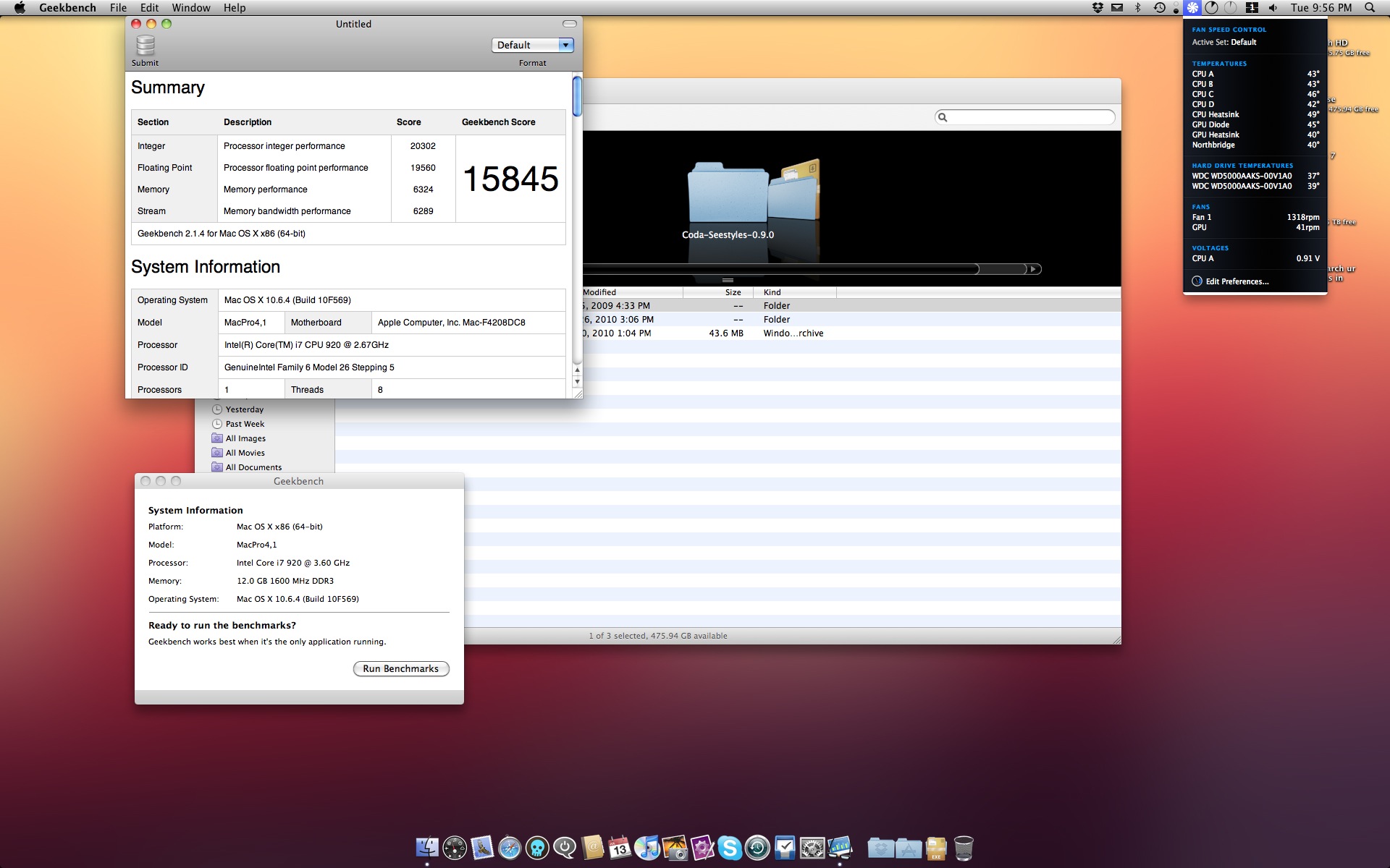

d00d Posted July 11, 2010 Author Share Posted July 11, 2010 D00D , what kind of cooling system do you use to achieve these idle temps? Idle temperature comparison: Idle CPU temperatures at 4.3 GHz (turbo disabled) and 19 C ambient; 42-46 C Idle CPU temperatures at 4.3 GHz (turbo disabled) with a speed step MacPro4_1.plist, and 19 C ambient; 42-46 C Idle CPU temperatures at 4.3 GHz (turbo disabled) with a speed step MacPro4_1.plist, DVID, and 19 C ambient; 35-39 C I have the Intel Stock CPU fan and a system Fan on the back of the mid tower case. I use your DSDT file from this post and verified speed stepping is working using imark-i. @ idle my cpu temps are around 53-55 C. BCLK is set to 160 and multiplier set to 20 giving me a 3.2Ghz i920 I believe I have all the proper BIOS settings as referenced in this post. I'm using a Lian Li PC-X1000 case that has three 14cm intake fans in the front and two 14cm exhaust fans in the rear, Noctua NH-D14 CPU heatsink using two 14cm Noiseblocker NB-BlackSilentPro PK-3 fans voltage controlled on CPU_FAN by the BIOS, and Indigo Xtreme Engineered Thermal Interface. Link to comment https://www.insanelymac.com/forum/topic/196771-ga-ex58-and-ga-x58a-dsdt-native-power-management-modifications/page/39/#findComment-1508731 Share on other sites More sharing options...
