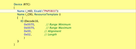

magnifico Posted August 21, 2010 Share Posted August 21, 2010 Hi Dood. Help dood. .i have modified RTC for the reset of the cmos… but I often have the problem that reset. .where mistake? Thanks for your help Link to comment https://www.insanelymac.com/forum/topic/196771-ga-ex58-and-ga-x58a-dsdt-native-power-management-modifications/page/40/#findComment-1534363 Share on other sites More sharing options...
d00d Posted August 24, 2010 Author Share Posted August 24, 2010 Hi Dood.Help dood. .i have modified RTC for the reset of the cmos… but I often have the problem that reset. .where mistake? Thanks for your help If that's the RTC device in your DSDT, it's been horribly mangled.Use the original instead and only change the two instances of 0x04 to 0x02. Link to comment https://www.insanelymac.com/forum/topic/196771-ga-ex58-and-ga-x58a-dsdt-native-power-management-modifications/page/40/#findComment-1536462 Share on other sites More sharing options...

magnifico Posted August 27, 2010 Share Posted August 27, 2010 If that's the RTC device in your DSDT, it's been horribly mangled.Use the original instead and only change the two instances of 0x04 to 0x02. Ok...thank's.. Link to comment https://www.insanelymac.com/forum/topic/196771-ga-ex58-and-ga-x58a-dsdt-native-power-management-modifications/page/40/#findComment-1538004 Share on other sites More sharing options...
