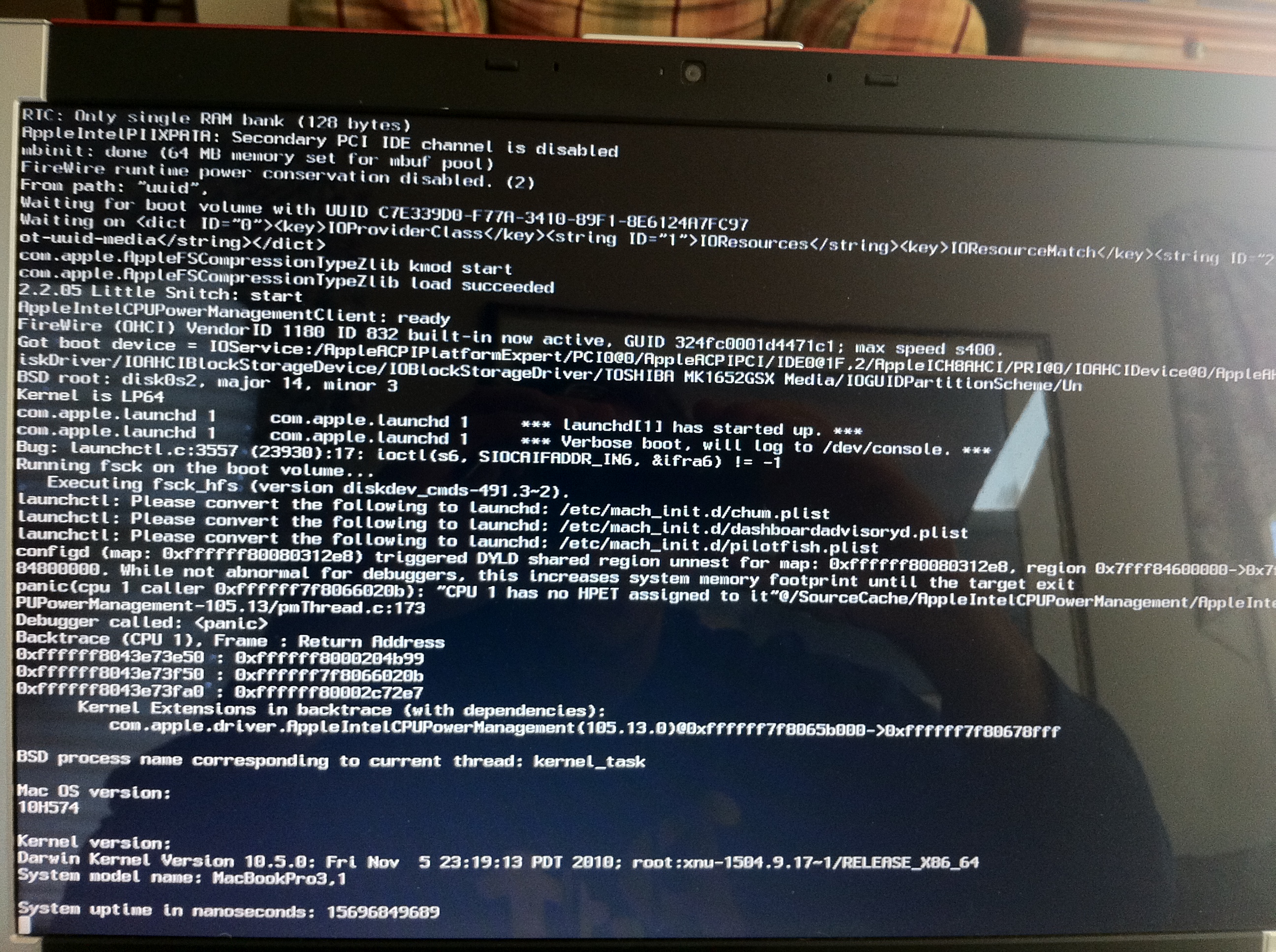

danofun Posted November 24, 2010 Share Posted November 24, 2010 Looking for a little bit of help after upgrading to 10.6.5. I was running fine on 10.6.4 and after an apparently successful upgrade to 10.6.5 I have only been able to boot via the Chameleon boot disk. Attached is an image of the errors I receive during boot in verbose mode and the boot fails with at frozen gray boot screen. My setup is a m1530 T7250 with 8600M GT Chameleon 2.0 RC5 r643 via unofficial installer with a custom DSDT (Brett's DSDT has failed as well.) Any help you can provide is greatly appreciated. Thank you! Link to comment https://www.insanelymac.com/forum/topic/190780-guide-making-a-dsdtaml-for-dell-xps-m1330-xps-m1530-and-xps-m1730/page/23/#findComment-1590367 Share on other sites More sharing options...
DarwinX Posted November 24, 2010 Share Posted November 24, 2010 This appears to be a regular AICPM kernel panic. Perhaps the AICPM kext was missing from your system but then reinstalled by the update. Use any AICPM disabler kext to bypass this issue. Installing such a kext might be tricky without a running backup OS X partition. Looking for a little bit of help after upgrading to 10.6.5. I was running fine on 10.6.4 and after an apparently successful upgrade to 10.6.5 I have only been able to boot via the Chameleon boot disk. Attached is an image of the errors I receive during boot in verbose mode and the boot fails with at frozen gray boot screen. My setup is a m1530 T7250 with 8600M GT Chameleon 2.0 RC5 r643 via unofficial installer with a custom DSDT (Brett's DSDT has failed as well.) Any help you can provide is greatly appreciated. Thank you! Link to comment https://www.insanelymac.com/forum/topic/190780-guide-making-a-dsdtaml-for-dell-xps-m1330-xps-m1530-and-xps-m1730/page/23/#findComment-1590396 Share on other sites More sharing options...
immo Posted November 24, 2010 Author Share Posted November 24, 2010 Looking for a little bit of help after upgrading to 10.6.5. I was running fine on 10.6.4 and after an apparently successful upgrade to 10.6.5 I have only been able to boot via the Chameleon boot disk. Attached is an image of the errors I receive during boot in verbose mode and the boot fails with at frozen gray boot screen. My setup is a m1530 T7250 with 8600M GT Chameleon 2.0 RC5 r643 via unofficial installer with a custom DSDT (Brett's DSDT has failed as well.) Any help you can provide is greatly appreciated. Thank you! It looks to me that for whatever reason the DSDT is not being found (without the HPET patch, you get that missing HPET error). Permissions problem? The DSDT should be installed in /Extra/DSDT.aml (case sensitive). You don't have an extra OS-X partition on the same computer do you? If so, try putting the DSDT.aml in the Extra folder on that partition. Use Brett's as it's known to work. If you can boot with the boot disk, try running Kext Utility. You can also try using the DSDT=/Extra/DSDT.aml (or wherever). Immo Link to comment https://www.insanelymac.com/forum/topic/190780-guide-making-a-dsdtaml-for-dell-xps-m1330-xps-m1530-and-xps-m1730/page/23/#findComment-1590476 Share on other sites More sharing options...
danofun Posted November 24, 2010 Share Posted November 24, 2010 immo and DarwinX, Your fast and informative replies are greatly appreciated! For some reason, I was indeed having permission issues and the DSDT was not being read. I'm still having issues with my custom DSDT but after correcting the permissions I am able to boot properly with Brett's DSDT on Chameleon 2.0 RC5 r643. I have removed AppleHDA.kext and have sound once again with VoodooHDA.kext in /S/L/E. For some reason I have never been able to get FakeSMC.kext to work properly in either /E or /S/L/E. My Extra folder contains (I'm not sure if they are all necessary): AppleACPIPS2Nub.kext OSXRestart.kext PlatformUUID.kext VoodooBattery.kext VoodooPS2Controller.kext VoodooSDHC.kext In the next few days I'll try and get my custom DSDT working again as the system runs hotter now and I've lost HDMI video that was previously achieved in 10.6.4 by following hotcorez guide. Thanks again for your contributions in regard to my issues and the community at large! Link to comment https://www.insanelymac.com/forum/topic/190780-guide-making-a-dsdtaml-for-dell-xps-m1330-xps-m1530-and-xps-m1730/page/23/#findComment-1590686 Share on other sites More sharing options...
