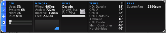

Claudio A. Posted July 25, 2010 Share Posted July 25, 2010 Ok, I have installed the last version from mozodojo and now is working, my C and P states are correctly parsed, but I don´t really understand which is the problem with my CPU temp, while I am writing this the temp is 73 aprox. .. So I was waiting to have something like 50.. In my smbios.plist I have selected MacBookPro5,1 but I have a Intel Core 2 Duo T7250 2.0Ghz, I do not know if this may be the problem.... When I use for example, Macbook3,1 Which is more accurate with respecto to my CPU, the temp goes down to 60 but Coolbook shows that speedstep is not working . If someone can give me some advice to see what is happening i Will really appreciate that. Thanks a lot, special thanks to oSxFr33k, the new version of chamaleon is working ok. Claudio. Link to comment https://www.insanelymac.com/forum/topic/190780-guide-making-a-dsdtaml-for-dell-xps-m1330-xps-m1530-and-xps-m1730/page/18/#findComment-1518552 Share on other sites More sharing options...
oSxFr33k Posted July 25, 2010 Share Posted July 25, 2010 Claudio A., I had the same problem in my D830. I found duplicate script in my /l/p/sc/com.apple.Boot.plist. Make sure only this is in that file: <key>Kernel Flags</key> <string></string> Make sure there are not any other instances of com.apple.Boot.plist anywhere but in your /extra Also remove those last two lines of script in the com.apple.Boot.plist they are unecessary as long as smbios.plist is in /extra or s/l/e <key>SMBIOS</key> <string>rd(0,0)/Extra/smbios.plist</string> That broke my P and C states, it ran to hot. Use VoodooMonitor and iSTAT pro and nothing else. Voodoo Monitor is showing how perfect everything is working now. I see the voltages(Freq) change according to load. Temps are in the 40's Link to comment https://www.insanelymac.com/forum/topic/190780-guide-making-a-dsdtaml-for-dell-xps-m1330-xps-m1530-and-xps-m1730/page/18/#findComment-1518679 Share on other sites More sharing options...

oSxFr33k Posted July 26, 2010 Share Posted July 26, 2010 Ok, I have installed the last version from mozodojo and now is working, my C and P states are correctly parsed, but I don´t really understand which is the problem with my CPU temp, while I am writing this the temp is 73 aprox. .. So I was waiting to have something like 50.. In my smbios.plist I have selected MacBookPro5,1 but I have a Intel Core 2 Duo T7250 2.0Ghz, I do not know if this may be the problem.... When I use for example, Macbook3,1 Which is more accurate with respecto to my CPU, the temp goes down to 60 but Coolbook shows that speedstep is not working . If someone can give me some advice to see what is happening i Will really appreciate that. Thanks a lot, special thanks to oSxFr33k, the new version of chamaleon is working ok. Claudio. Try Voodoo Monitor. I won't let you change voltages but will show you the Speed Step working. VoodooMonitor.zip Link to comment https://www.insanelymac.com/forum/topic/190780-guide-making-a-dsdtaml-for-dell-xps-m1330-xps-m1530-and-xps-m1730/page/18/#findComment-1519117 Share on other sites More sharing options...
ab___73 Posted July 26, 2010 Share Posted July 26, 2010 Cool News! Great job, especially Slice! Thanks to oSxFr33k and Thanks to all! How can we be sure that C-States is working? I tried this command i found on an osx86 site but it did not report anything as it should : sudo ioreg -lw0 | grep CSTInfo I now don't have the lpc warning and istat is showing the cpu, hd and gpu temps. Any advice? If you don't get CSTInfo in IOREG, then i suspect, C-States aren't functional. I've still got the LPC Register error. No Cigar for me -- AB Brett, AB___73 or whoever may know the answer to this one? Script Below: OperationRegion (BSKU, SystemMemory, 0xFFBC0100, One) Field (BSKU, ByteAcc, NoLock, Preserve) { , 1, BPHP, 3, Offset (0x01) } OperationRegion (GPE0, SystemIO, 0x042C, 0x04) Field (GPE0, ByteAcc, NoLock, Preserve) { , 1, GPEH, 1, , 7, PEEN, 1, , 1, PMEE, 1, Offset (0x03), PCIX, 1, Offset (0x04) } WHat is the purpose of this script? Your correct these functions do not add anything to our DSDT. Must have been some left over code copied from another DSDT. FYI: This code refers to the General Purpose Event and ours is located at PM_BASE+0x2C, so even we tried to use the script above we would have to change the SystemIO address to 0x102C. The SystemIO used in the script above must have came from a DSDT with a PM_BASE of 0x400 (Mac, or Desktop PC). On another topic: I've also found that our GPIO base address is 0x1080. this is located in position 0x48 of our lpc device. We need to change this in our DSDT, if we would like to use these fields properly. This info comes from the Intel ICH8 chipset reference, located at the intel website. -- AB Link to comment https://www.insanelymac.com/forum/topic/190780-guide-making-a-dsdtaml-for-dell-xps-m1330-xps-m1530-and-xps-m1730/page/18/#findComment-1519236 Share on other sites More sharing options...
oSxFr33k Posted July 26, 2010 Share Posted July 26, 2010 ab___73, Could CSTinfo be labelled as something else in the ioreg? I can confirm I have speed step working perfectly and my temps. are even lower than before about 10 degrees lower. I don't see pssInfo either in Ioreg yet I know for sure speed step is working. Could you post a snippit of the code so I can find it. I cannot find that part of the code with that address? Here is my code: } OperationRegion (GPIO, SystemIO, 0x0500, 0x3C) Field (GPIO, ByteAcc, NoLock, Preserve) { GU00, 8, GU01, 8, GU02, 8, GU03, 8, GIO0, 8, GIO1, 8, GIO2, 8, GIO3, 8, Link to comment https://www.insanelymac.com/forum/topic/190780-guide-making-a-dsdtaml-for-dell-xps-m1330-xps-m1530-and-xps-m1730/page/18/#findComment-1519259 Share on other sites More sharing options...

oSxFr33k Posted July 27, 2010 Share Posted July 27, 2010 I have tried it, and I have working P-States as according to CoolBook, no heat problem, but I am still getting the LPC error on boot (seems to be behaving quite close to the way it did before). You mentioned that the P-States and C-States are being correctly parsed. Where do you find this out? Also, the boot loader is showing in all text even though I have Boot Graphics set to yes. Are you getting this as well? Thanks. Immo Immo and overshoot From ab___73 post above it looks like CST is still not enabled. Since the update my temps dropped 10 degrees and VoodooMonitor showed the varying voltages so I assumed both CST and PSS were enabled. Its still a good update for cooler running XPS M1330, M1530 and my D830 machines. There something with the Dell Bios causing this LPC issue. It has to be Dell's Bios. Remember how some of the Dells had to have CPU=1 before chameleon came around. That was an issue that seemed to be notoriously targeted on certain Dell Laptops from what I remember. Something only Chameleon EFI could fix. We have to investigate this more. Maybe looking it how Linux handles LPC. @immo Make sure Quite Boot = Yes Link to comment https://www.insanelymac.com/forum/topic/190780-guide-making-a-dsdtaml-for-dell-xps-m1330-xps-m1530-and-xps-m1730/page/18/#findComment-1519974 Share on other sites More sharing options...
immo Posted July 28, 2010 Author Share Posted July 28, 2010 Immo and overshoot From ab___73 post above it looks like CST is still not enabled. Since the update my temps dropped 10 degrees and VoodooMonitor showed the varying voltages so I assumed both CST and PSS were enabled. Its still a good update for cooler running XPS M1330, M1530 and my D830 machines. There something with the Dell Bios causing this LPC issue. It has to be Dell's Bios. Remember how some of the Dells had to have CPU=1 before chameleon came around. That was an issue that seemed to be notoriously targeted on certain Dell Laptops from what I remember. Something only Chameleon EFI could fix. We have to investigate this more. Maybe looking it how Linux handles LPC. @immo Make sure Quite Boot = Yes That C-state problem sure isn't an easy one to solve! As you said, still a good update. I can't verify it since I don't have a readout, but I get the feeling that the fans are on more often/faster with the Mojodojo solution. Could this be why the temps are lower? As for the quiet boot option, that's not quite what I was looking for, as I have a multiboot set up, and if I use quiet boot I loose the ability to choose the OS. It's not a big deal, but I had a graphical GUI with Chameleon 4 from VoodooProjects, but I can't seem to get anything but a text GUI with Mojodojo. I'll play with it a little more when I get the chance. Thanks Immo Link to comment https://www.insanelymac.com/forum/topic/190780-guide-making-a-dsdtaml-for-dell-xps-m1330-xps-m1530-and-xps-m1730/page/18/#findComment-1520318 Share on other sites More sharing options...
