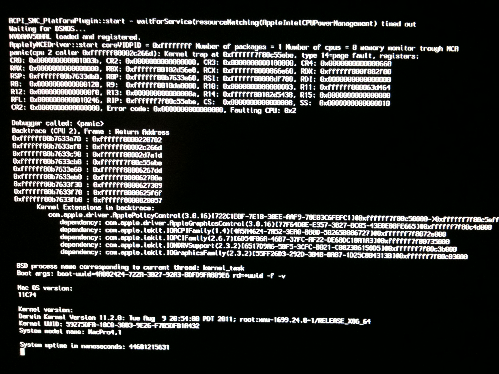

itdoesnotwork Posted October 12, 2011 Share Posted October 12, 2011 So this is what happened so far: 1. Running 10.7.1 2. Installed 10.7.2 via software update: during "copying files" a KP occured (Only "You have to restart..." even though I set debug flag) 3. After reset, it stopped booting right after stating kernel version. No reported errors - then keeps rebooting. 4. Installed 10.7.2 completely again booting into my spare drive and using combo update 5. KP at boot (see screenshot) 6. Was able to boot using the bootloader of my spare drive without errors. Kexts loaded in working bootloader: Kexts loaded in in non working bootloader: Well, I updated the script and installed Chimera 1.5.4, tried to boot with new kexts and still get same KP as shown in screenshot. However, I can boot 10.7.0 flawlessly, so it's definitely a 10.7.2 problem. Link to comment https://www.insanelymac.com/forum/topic/185097-guide-scripted-yosemitemavericks-install-on-gigabyte-mobos/page/151/#findComment-1759069 Share on other sites More sharing options...

digital_dreamer Posted October 14, 2011 Author Share Posted October 14, 2011 For those of you having boot issues that end in a ApplePolicyControl-related KP (com.apple.driver.ApplePolicyControl in backtrace), like shown in itdoesnotwork's KP shot above, try the suggestion in post #55 in the Mac OS X Lion 10.7.2 is Available! thread. This suggestion is simply to remove the ApplePolicyControl.kext from the AppleGraphicsControl.kext's Plugins folder in S/L/E. The System boot cache/kernelcache would need to be rebuilt after this. Additionally, it appears there have been changes in graphic drivers where the boot process ends with no desktop shown - the log just stops. Some users have noted that disabling the bootloader's GraphicsEnabler (GraphicsEnabler=No) gets them in. Of course, no QE/CI is enabled, either. regards, MAJ Link to comment https://www.insanelymac.com/forum/topic/185097-guide-scripted-yosemitemavericks-install-on-gigabyte-mobos/page/151/#findComment-1759660 Share on other sites More sharing options...
L3B3R Posted October 14, 2011 Share Posted October 14, 2011 For those of you having boot issues that end in a ApplePolicyControl-related KP (com.apple.driver.ApplePolicyControl in backtrace), like shown in itdoesnotwork's KP shot above, try the suggestion in post #55 in the Mac OS X Lion 10.7.2 is Available! thread. This suggestion is simply to remove the ApplePolicyControl.kext from the AppleGraphicsControl.kext's Plugins folder in S/L/E. The System boot cache/kernelcache would need to be rebuilt after this. Additionally, it appears there have been changes in graphic drivers where the boot process ends with no desktop shown - the log just stops. Some users have noted that disabling the bootloader's GraphicsEnabler (GraphicsEnabler=No) gets them in. Of course, no QE/CI is enabled, either. regards, MAJ Thanks DD, that at least helped me get in the system. Only issues: No iCloud login (using latest Chimera, and tried this) No App Store login No Mail No QE/CI Link to comment https://www.insanelymac.com/forum/topic/185097-guide-scripted-yosemitemavericks-install-on-gigabyte-mobos/page/151/#findComment-1759685 Share on other sites More sharing options...
