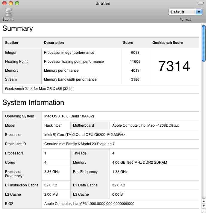

Just thought I would throw in my Geekbench! Lol, I was impressed... and this is the 32bit module running while i am in 64bit kernel :)
Not to mention this is far from near the top my system will clock to, pretty dang impressive
My score was a modest 7314
Not to bad
