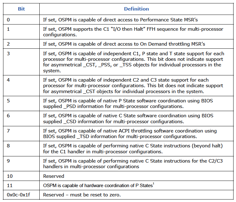

Master Chief Posted September 7, 2009 Share Posted September 7, 2009 OK I have a question -The following _cst package example: Name(_CST, Package() { 4, // There are four C-states defined here with three semantics // The third and fourth C-states defined have the same C3 entry semantics Package(){ResourceTemplate(){Register(FFixedHW, [color="#ff0000"]0, 0, 0)}, 1, 20, 1000[/color]}, Package(){ResourceTemplate(){Register(SystemIO, [color="#ff0000"]8, 0, 0x161)}, 2, 40, 750[/color]}, Package(){ResourceTemplate(){Register(SystemIO, [color="#ff0000"]8, 0, 0x162)}, 3, 60, 500[/color]}, Package(){ResourceTemplate(){Register(SystemIO, [color="#ff0000"]8, 0, 0x163)}, 3, 100, 250[/color]} }) Does anybody know what the data highlited in red corresponds to? With a view to adding correct data for a given CPU. Let's take the last one as example: 8 = 8 bits. 0 = index address 0. 0x163 = Register (must be unique per _CST object). Register(SystemIO, 8, 0, 0x163) // OSPM reads 8 bits, starting at index 0, from register 0x163 to go into this state. 3 = C-State aka C3. 100 = Latency in microseconds (worse case) to change C-State. 250 = Average power consumption in milliwatt (per core). Now assume that core 0 is in C3 (using 1000mw) but has a little less work to do, reducing the average power usage to say 750mw (in this case) for over 40us, that will make it changes into C2. Doing more work again however, increasing the power usage for 20us (in this case) will make it change back into C1 again. In other words; reducing the CPU core to a lower frequency takes a little more time, or else the OS would freeze too often. This example, with two C3 states, makes it more difficult for the OSPM because now it needs to make decisions about when to use which register i.e. in this case 0x162 or 0x163. But this is all from the top of my head (and I haven't checked it). Time to get some sleep now Link to comment https://www.insanelymac.com/forum/topic/181631-dsdt-vanilla-speedstep-generic-scope-_pr/page/3/#findComment-1255023 Share on other sites More sharing options...
FKA Posted September 7, 2009 Author Share Posted September 7, 2009 But this is all from the top of my head (and I haven't checked it). Time to get some sleep now Many thanks Chief D. looking at the guide it's not as easy as copy paste to my DSDT unlike other guides out there.. question, anyone care to explain the advantage of this compared to voodoopower? ive seen only few members posting so im assuming not that much or really no one cared about speedstep and just happy they have OSX running. Hi It's not that straight forward and will take some time to get to grips with. advantages|: using AppleIntelCPUPM, no need for disabler.kext, reported lower cpu temps, removes cst errors, closer to a vanilla build. D. Link to comment https://www.insanelymac.com/forum/topic/181631-dsdt-vanilla-speedstep-generic-scope-_pr/page/3/#findComment-1255365 Share on other sites More sharing options...

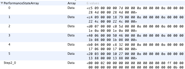

Master Chief Posted September 7, 2009 Share Posted September 7, 2009 Weird. It seems that I don't need to modify anything to get P-States working with Leopard. Snow Leopard however is a different cat, but that is about to change. Edit: I got it working with Snow Leopard. All I had to do was to change "MacPro3,1" in: /System/Library/Extensions/IOPlatformPluginFamily.kext/Contents/PlugIns/ACPI_SMC_PlatformPlugin.kext/Contents/info.plist into "P5K PRO" – because that is what System Profiler shows for this configuration – and that was it. I wonder if there's any bit of code in CPU-i to show C-States, because how else would I know if that works? Checking... Link to comment https://www.insanelymac.com/forum/topic/181631-dsdt-vanilla-speedstep-generic-scope-_pr/page/3/#findComment-1256334 Share on other sites More sharing options...
SA22C Posted September 8, 2009 Share Posted September 8, 2009 Weird. It seem that I don't need to modify anything to get P-States working with Leopard. Snow Leopard however is a different cat, but that is about to change. Edit: I got it working with Snow Leopard. All I had to do was to change "MacPro3,1" in: /System/Library/Extensions/IOPlatformPluginFamily.kext/Contents/PlugIns/ACPI_SMC_PlatformPlugin.kext/Contents/info.plist into "P5K PRO" – because that is what System Profiler shows for this configuration – and that was it. I wonder if there's any bit of code in CPU-i to show C-States, because how else would I know if that works? Checking... I nabbed the OP's tables and changed the p-states to match my CPU. I don't get the C-state error anymore on boot and my Hack now sleeps and shuts down normally. However, I see no evidence that the CPU is actually stepping. The frequency seems pegged at the max. I am unable to boot into 32-bit (I have no idea why, but I the GUI refuses to load in x32) so I can't use CPUi to test, but a sysctl -a | grep freq returns a current, min and max freq as the same value, leading me to believe that no stepping is taking place. I was also curious about the difference between the NPSS and SPSS states. What do I need to do differently between those two? Thanks. System is as follows: Asus P5K-E Intel Core 2 Duo E6400 Bios version 1305 My system supplies no SSDT tables of any kind, so I hacked in the provided SSDT dump in the OP. Link to comment https://www.insanelymac.com/forum/topic/181631-dsdt-vanilla-speedstep-generic-scope-_pr/page/3/#findComment-1256518 Share on other sites More sharing options...

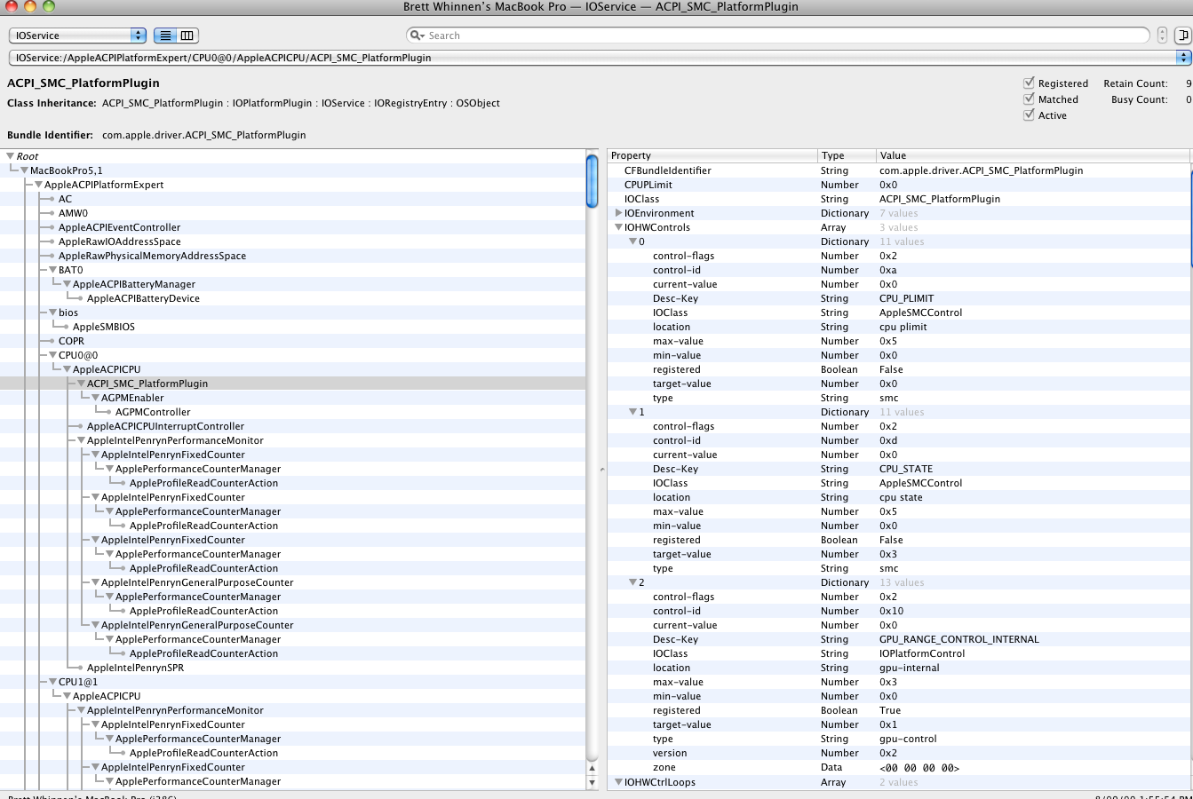

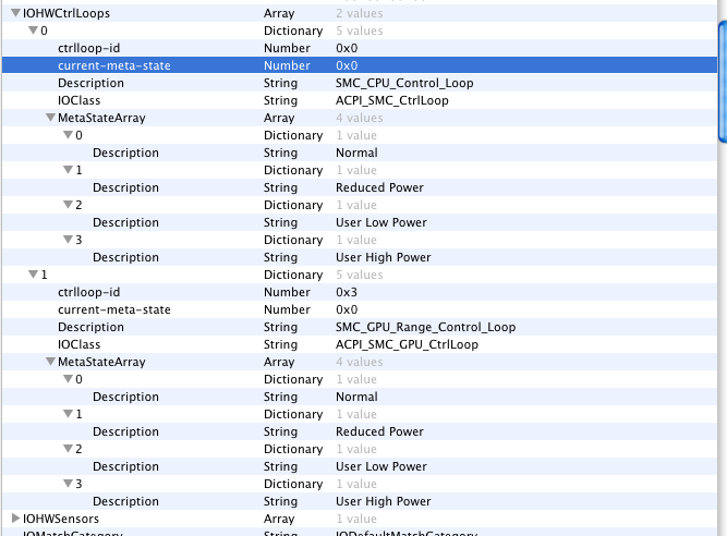

Brett Whinnen Posted September 8, 2009 Share Posted September 8, 2009 I'm getting the following in IOregexplorer... You can see that the Pstates are read in but not active? GPU is active though. And looks like the cstates aren't active either. This DSDT was working under 10.5.7 nicely, but SL 10A432 seems a different beastie. My _CST items are from the MacPro3,1 but if I change my smbios.plist to refer to this and also the ACPI_SMC_PlatformPlugin to reference that GPU scaling turns off... smbios.plist is now set to a MacBookPro5,1 which enables the GPU scaling. Does anyone have the _CST from the MBP5,1 handy at all? I cannot seem to find it in any of the MBP5,1 SSDT dumps around the place. Some screenshots. And still getting the C-states error: AppleACPICPU: ProcessorId=0 LocalApicId=0 Enabled AppleACPICPU: ProcessorId=1 LocalApicId=1 Enabled ACPI: System State [s0 S3 S4 S5] (S3) ACPI_SMC_PlatformPlugin::registerLPCDriver - WARNING - LPC device initialization failed: C-state power management not initialized Cheers, Brett PS this is fun in a sick kind of way Seeing what differences are made. Link to comment https://www.insanelymac.com/forum/topic/181631-dsdt-vanilla-speedstep-generic-scope-_pr/page/3/#findComment-1256643 Share on other sites More sharing options...
Master Chief Posted September 8, 2009 Share Posted September 8, 2009 ...And still getting the C-states error: ACPI: System State [s0 S3 S4 S5] (S3) ACPI_SMC_PlatformPlugin::registerLPCDriver - WARNING - LPC device initialization failed: C-state power management not initialized No error here. You probably just forgot something (no offense). Feel free to attach your vanilla dsdt.dsl and the modified one. Link to comment https://www.insanelymac.com/forum/topic/181631-dsdt-vanilla-speedstep-generic-scope-_pr/page/3/#findComment-1256681 Share on other sites More sharing options...
Brett Whinnen Posted September 8, 2009 Share Posted September 8, 2009 No error here. You probably just forgot something (no offense). Feel free to attach your vanilla dsdt.dsl and the modified one. Hahaha, no offence at all, I'm new to DSDT / SSDT so happy to take pointers from people with more experience. I will attach them a bit later this evening. Thanks in advance for having a look! Brett Attached: 1. acpi_dsdt.dsl is the OE extracted from Everest. acpi_dsdt.dsl.zip 2. DSDT-T9300.dsl is modified with _PSS for the T9300 and the other fixes for my Dell. DSDT_T9300.dsl.zip Thanks! Link to comment https://www.insanelymac.com/forum/topic/181631-dsdt-vanilla-speedstep-generic-scope-_pr/page/3/#findComment-1256734 Share on other sites More sharing options...

Master Chief Posted September 8, 2009 Share Posted September 8, 2009 Hahaha, no offence at all, I'm new to DSDT / SSDT so happy to take pointers from people with more experience. I will attach them a bit later this evening. Thanks in advance for having a look! Hi Brett, I looked at your files and immediately noticed something, which I expected to be honest. The problem is that you copied stuff, but it is not initialized. Not at all. Let's have a look at this: Scope (\) { Name (SSDT, Package (0x0C) { "CPU0IST ", 0xDFE72CB4, 0x02C8, "CPU1IST ", 0xDFE72F7C, 0xC4, "CPU0CST ", 0xDFE7264A, 0x05E5, "CPU1CST ", 0xDFE72C2F, 0x85 }) Name (CFGD, 0x013369F7) Name (PDC0, 0x80000000) Name (PDC1, 0x80000000) Name (SDTL, 0x00) } N.b. You don't need SSDT to get P-States working – I did not include it and everything appears to be working, and without the usual startup error yes. Edit: I don't need SSDT because my DSDT declares it like this: Processor (CPU1, 0x01, 0x00000810, 0x06) { OperationRegion (STBL, SystemMemory, 0xCFF8E0D0, 0x01D2) Which is basically the same, but quicker. Now have a look at PDC[0/1] because like I said, nowhere in your DSDT can I find anything that initializes these two, representing the capabilities so they are pretty important. This usually is the task of the OSPM capabilities interfaces called Processor Driver Capabilities and/or Operating System Capabilities - depending on the used ACPI version. But your DSDT doesn't include them! In other words; you either need to add _PDC(){} and/or _OSC(){} to get the job done, or init the PDCn yourself with the help of the attached table (key to get C-States going). Edit: I just had another quick look at this snippet (from FormerlyKnownAs et all): Scope (_PR.CPU0) { Name (HI0, Zero) Name (HC0, Zero) Name (TLD0, Zero) Method (_PDC, 1, NotSerialized) { CreateDWordField (Arg0, 0x08, CAP0) Store (CAP0, PDC0) If (LEqual (TLD0, Zero)) { If (LEqual (And (PDC0, 0x0A), 0x0A)) { If (And (CFGD, 0x02)) { OperationRegion (IST0, SystemMemory, DerefOf (Index (SSDT, One)), DerefOf (Index (SSDT, 0x02 ))) Load (IST0, HI0) } Store (One, TLD0) } } } } Now note this: CreateDWordField (Arg0, 0x08, CAP0) Store (CAP0, PDC0) Which tells me that Apple is only using/checking the revision ID, which for your info is the first argument (Arg0). That is if this snippet is really taken from a real Mac (Edit: Not, see next post). And here's the table I mentioned earlier: Link to comment https://www.insanelymac.com/forum/topic/181631-dsdt-vanilla-speedstep-generic-scope-_pr/page/3/#findComment-1257247 Share on other sites More sharing options...
FKA Posted September 8, 2009 Author Share Posted September 8, 2009 Which tells me that Apple is only using/checking the revision ID, which for your info is the first argument (Arg0). That is if this snippet is really taken from a real Mac. Hi Master Chief That is an SSDT IST table - as extracted from my Gigabyte MB. It's not Apple. D. Link to comment https://www.insanelymac.com/forum/topic/181631-dsdt-vanilla-speedstep-generic-scope-_pr/page/3/#findComment-1257306 Share on other sites More sharing options...
Master Chief Posted September 8, 2009 Share Posted September 8, 2009 Hi Master Chief That is an SSDT IST table - as extracted from my Gigabyte MB. It's not Apple. D. Me ducks. I should have noticed it as it was right in my face. Thing is; I just got my morning shower - still waiting for my cappuccino after breakfast - and thus things should go better in a few minutes. Ah lovely there it is. p.s. Any real Mac DSDT's floating around here? Got it. This should help – post #7 for the SSDT tables Update: My _PDC() {} and OSC() {} ASL code is almost the same as the MacPro3,1 but mine doesn't Load() the CST table. Link to comment https://www.insanelymac.com/forum/topic/181631-dsdt-vanilla-speedstep-generic-scope-_pr/page/3/#findComment-1257347 Share on other sites More sharing options...
