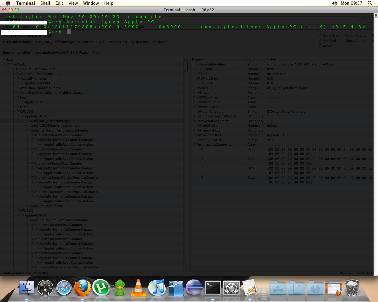

I cant figure out why i have AppleLPC loading with or without the injected device id in the DSDT i assume the orginal device ID must be in that extension because it loads clear as day with kextstat | grep AppleLCP also it shows in extensions in system profiler however the power saver option does not show restart after a power outage or whatever it is.
speedstep clearly works andi cant understand why i dont have this option in system preferences
can anyone help me out with it?

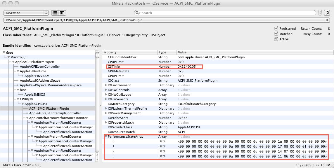

After much reading on this thread and the Gigabyte DSDT thread I wanted to share some success. I truly only know the basics of all this and have learned so much here. Since it was mainly a p-state and c-state victory, I thought I'd post here. First, all of the improvements in this DSDT are due to the advice of many through posts and PM's. I borrowed many of the suggestions from Blackosx's posted DSDT's, so you'll see his annotations throughout the attached file since he has made a wonderful compilation of the recommendations given in both threads.
My setup: GA-EP45-UD3P (rev 1.6), Q6600, nvidia 7800GT, netkas 10.5 (no ethernet or video in DSDT). P-states and C-states both work as seen in IOreg, which in addition to temps I understand is the only way to know these have been loaded. Additionally VoodooMonitor shows adjustment to the frequency and voltage. I used p-state calculator for the VID/FID numbers. Sleep works, finally.
I found that the key to getting all this to work was:
1. The correct C2 and C3 according to the FACP table
2. The Device (LPCB) being correctly formatted for my motherboard
3. Ticking the "start automatically after power failure" box in system preferences.
I've attached my latest DSDT files as well as an IOreg picture.
Thanks for the help and hopefully this DSDT will assist someone. I'm also open to suggestions to improving this one.

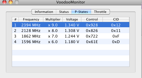

Ok, got speedstep working but in voodoomonitor I see:
But in my dsdt
Method (_PSS, 0, NotSerialized)
			Return (Package (0x04)
			Package (0x06) { Zero, Zero, 0x0A, 0x0A, 0x0920, 0x0922 },
			Package (0x06) { Zero, Zero, 0x0A, 0x0A, 0x081E, 0x0820 },
			Package (0x06) { Zero, Zero, 0x0A, 0x0A, 0x071A, 0x071C },
			Package (0x06) { Zero, Zero, 0x0A, 0x0A, 0x0616, 0x0618 }
But in my dsdt

You should have something like this depending on which of the last two sets of numbers are the correct values for your pstates.
			 Package (0x06) { Zero, Zero, 0x0A, 0x0A, 0x0920, Zero },
			 Package (0x06) { Zero, Zero, 0x0A, 0x0A, 0x081E, One },
			 Package (0x06) { Zero, Zero, 0x0A, 0x0A, 0x071A, 0x02 },
			 Package (0x06) { Zero, Zero, 0x0A, 0x0A, 0x0616, 0x03 }

It makes no difference if you use for example 0x616,0x616 or 0x616,0x3 but something like 0x616,0x618 might cause some problems
