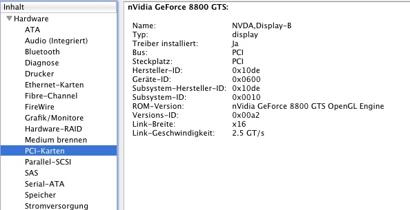

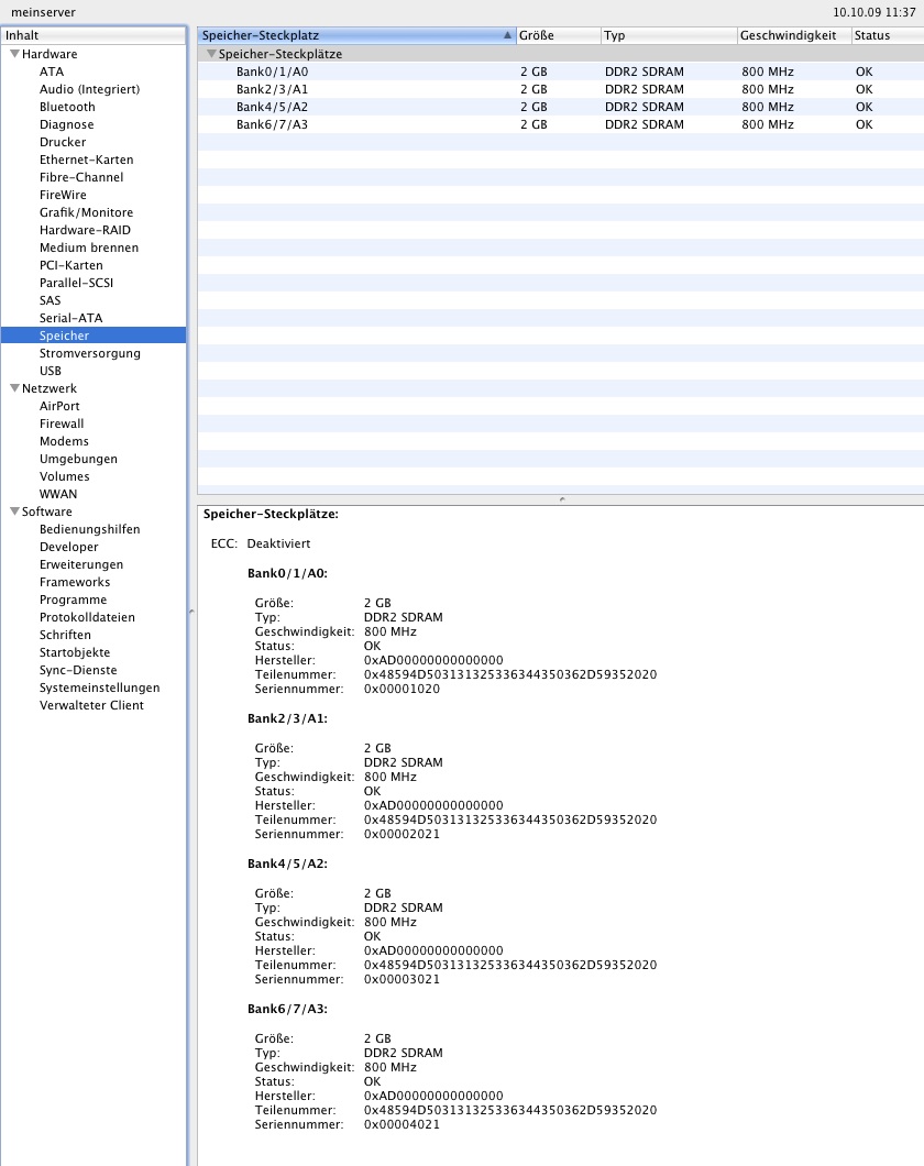

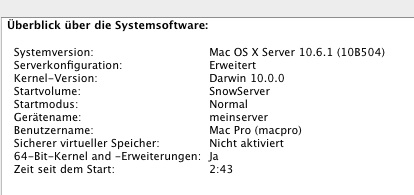

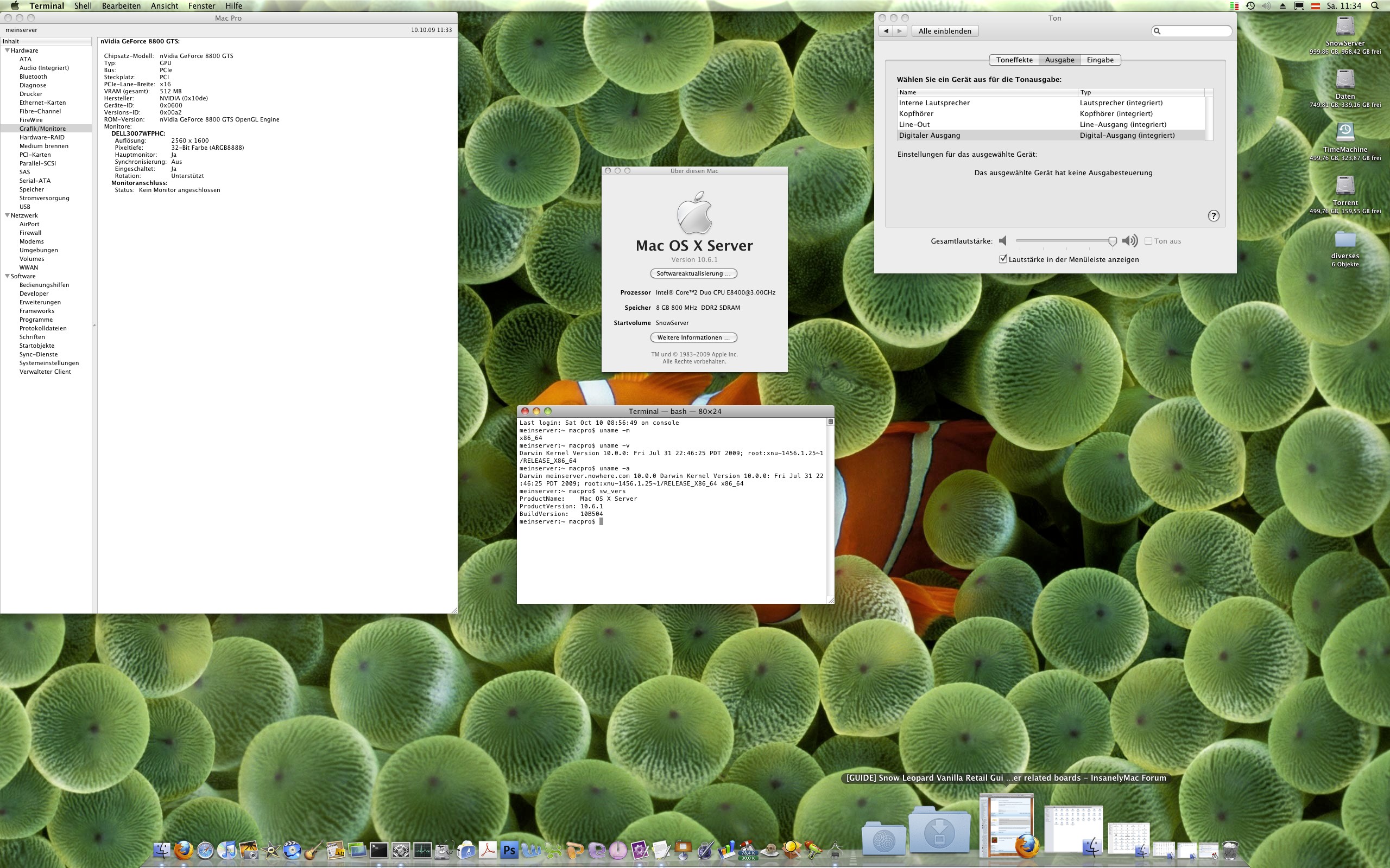

thanks 4 your guide ! :D
I did boot with your boot CD and installed retail Snow Leopard Server on my computer.
All running fine - except audio (889a) not your fault, it's those .kexts....
Edit: Audio now OK after DSDT "updating" (coax digital out on ALC889a / ALC885)
