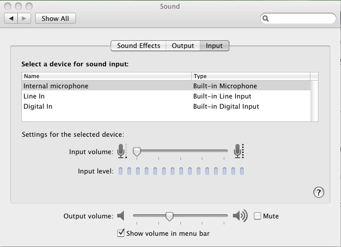

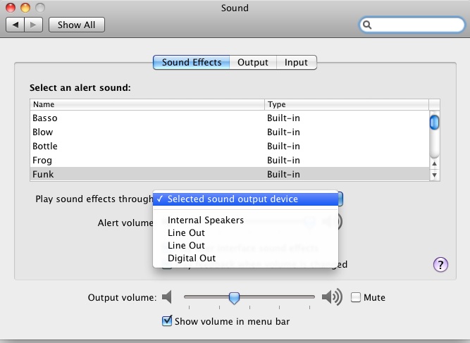

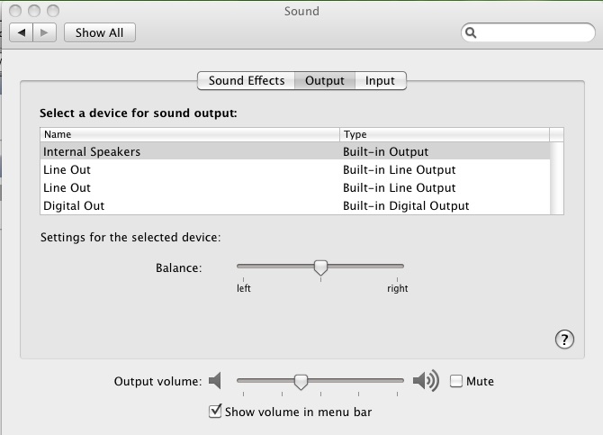

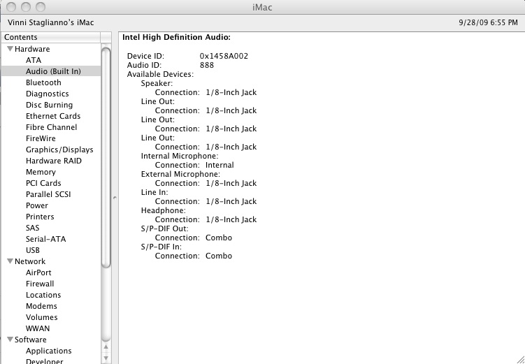

I posted this on the other threat but here it is for easy convinience.
Hi blackosx,
I managed to get the sound working. I downloaded a patched appleHDA file and and re did the dsdt audio part manually. worked like a charm. Thanks again for your support.
For those who'd like to try the kext file (ALC888) go here: http://www.mediafire.com/download.php?y2wdmyt3yiw.
also add the audio to the dsdt.aml file. here is my dsdt.aml. this is a clean dsdt.aml with audio and cmos fix only, nothing else.
http://www.mediafire.com/?sharekey=1d6f88d...04e75f6e8ebb871
If anybody wants the dsdt part from my file. disassemble the dsdt to .dsl and open it. search for HDEF. (device part) and copy that part.(blackosx DSDT guide explains more in detail here : http://www.insanelymac.com/forum/index.php?showtopic=177497) save and re compile. Good luck smile.gif

Hi blackosx,
Heres what you requested:
Where did you get this patched AppleHDA from?
I got it from here : http://wiki.osx86project.org/wiki/index.ph...10.6.0#Gigabyte
search for GA-965P-DQ6.
Its an AppleHDA.kext file for the ALC888 ICH8, works for the ICH10 as well, because I have that one and I'm currently using it.
what audio options does it give you?
I have regular audio and mic. Haven't tried the rest.
does it work from /E/E allowing you to leave the retail install untouched?
It works from /E/E and S/L/E I tried both. so yes u can have an untouched system.
Let me know if you need anything else.

Hi uketommyv, thanks for supplying the details for the patched AppleHDA.kext.
From the screenshot's it looks like it gives identical options to the DSDT ALC888-0 HDEF + LegacyHDA.kext method.
I will try it to weigh up the possibility of including it in the guide/support files.. So what do I need to do to get it working?
I had a quick go this morning before I came to work. I tried removing my current LegacyHDA.kext from /E/E and adding the AppleHDA.kext in to /E/E in it's place. Rebooted, but no audio, the SystemPrefs are all empty and greyed out.
