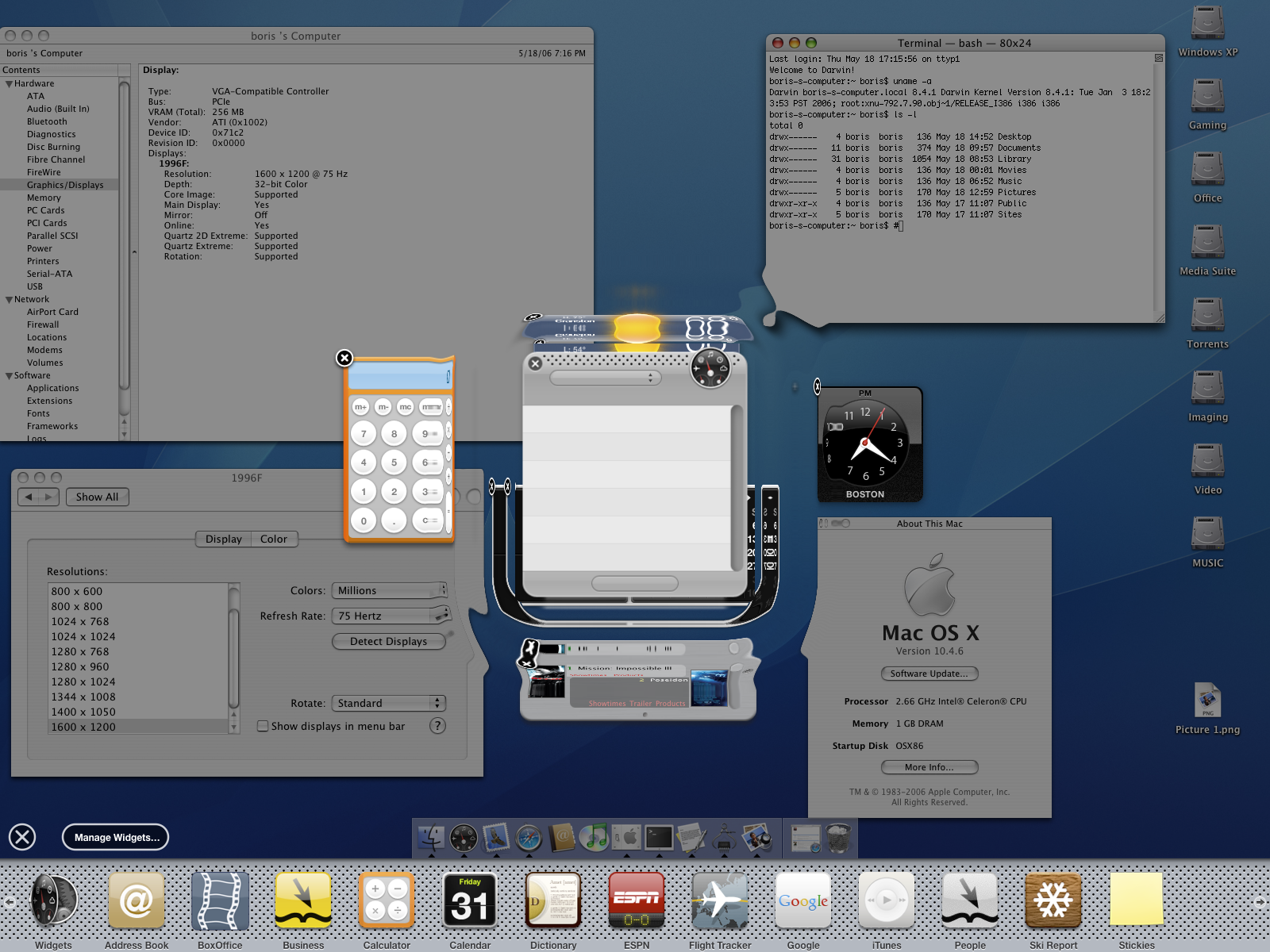

munky Posted May 18, 2006 Share Posted May 18, 2006 MacBlac and Quietglow - maybe our problem is that we're all running 10.4.6, whereas boris is running 10.4.5 (as can be seen from his screenshot). i'm going to reinstall myzar's 10.4.4/10.4.5 DVD and retry this, as we all appear to have the same behaviour, and we all seem to be running 10.4.6 (mine's a JaS install - anyone else?) will post my findings. if im right, then i think i'll just do the 10.4.6 update manually using quixos method - seems to be the safest. Link to comment https://www.insanelymac.com/forum/topic/17767-borisbadenov-ati-x1000-series-solution/page/3/#findComment-115317 Share on other sites More sharing options...

cyclonefr Posted May 18, 2006 Share Posted May 18, 2006 i think the problem comes from the fact ATINDRV seek for a string named "X1600" and it doesnt work so on X1800 and 9XXX maybe using IDA on the main ATINDRV file into the kext can help ... i'll try tommorrow but i dont have IDA Btw ATINDRV may possibly needs of X1000.kext but it doenst only need that else it would work on X1800 eheh Link to comment https://www.insanelymac.com/forum/topic/17767-borisbadenov-ati-x1000-series-solution/page/3/#findComment-115326 Share on other sites More sharing options...

munky Posted May 18, 2006 Share Posted May 18, 2006 update on the 10.4.4/10.4.5 theory. i just copied the 10.4.4 ATINDRV and X1000 kexts to my Jas 10.4.6 fresh install (as installed, except with IOPCIFamily from 10.4.3 installed to fix autologin and twirl), did boris' changes and booted up. i got a weird corrupt screen with loads of blocks of colour, but it was definitely running (ie there was a discernible block at the bottom which behaved like the dock, and blocks at the top for menus etc). boris got back to me to say he's *upgraded* his installation "with the 10.4.6 Jas patch", and everything still works fine. however, due to my above experiences, im still working on the theory that this will NOT work on a fresh 10.4.6 Jas install. gonna take me a little while to copy the 10.4.4/5 dvd iso off my fileserver ({censored} wireless connection only) but once its copied and burnt and installed i'll try again. Link to comment https://www.insanelymac.com/forum/topic/17767-borisbadenov-ati-x1000-series-solution/page/3/#findComment-115338 Share on other sites More sharing options...
MacBlac Posted May 18, 2006 Share Posted May 18, 2006 Interesting, kseelbo got it going under 10.4.5, I have 10.4.6 Jas here as well and it does not. If this proves to be a workaround I'll try 10.4.5 as well, although I'm very curious what the difference between the two is regarding the X1000. Link to comment https://www.insanelymac.com/forum/topic/17767-borisbadenov-ati-x1000-series-solution/page/3/#findComment-115339 Share on other sites More sharing options...

borisbadenov Posted May 18, 2006 Share Posted May 18, 2006 update on the 10.4.4/10.4.5 theory. i just copied the 10.4.4 ATINDRV and X1000 kexts, did boris' changes and booted up. i got a weird corrupt screen with loads of blocks of colour, but it was definitely running (ie there was a discernible block at the bottom which behaved like the dock, and blocks at the top for menus etc). boris got back to me to say he's *upgraded* his installation "with the 10.4.6 Jas patch", and everything still works fine. however, due to my above experiences, im still working on the theory that this will NOT work on a fresh 10.4.6 Jas install. gonna take me a little while to copy the 10.4.4/5 dvd iso off my fileserver ({censored} wireless connection only) but once its copied and burnt and installed i'll try again. Yes, Munky, you are correct that I am running my 10.4.6 from the Jas patch from an installed 10.4.5 from Myzar. I tried the direct Jas 10.4.6 DVD but it would not recognise my sata drive. But I did look at the ati kexts and they looked the same but I cannot confirm 100% without trying. Good luck Link to comment https://www.insanelymac.com/forum/topic/17767-borisbadenov-ati-x1000-series-solution/page/3/#findComment-115343 Share on other sites More sharing options...

munky Posted May 18, 2006 Share Posted May 18, 2006 hi boris - thanks for the info. even if the ATI kexts are the same, there are a lot of supporting kexts (IOPCIFamily and the frameworks etc) which could make a big difference. i'm keeping my fingers crossed that installing the myzar disk will solve the problem. otherwise... well.. does anyone want to buy a nearly-new X1800XL PCI-E? Link to comment https://www.insanelymac.com/forum/topic/17767-borisbadenov-ati-x1000-series-solution/page/3/#findComment-115345 Share on other sites More sharing options...
borisbadenov Posted May 18, 2006 Share Posted May 18, 2006 hi boris, thanks for the update. is that a fresh JaS 10.4.6 or did you *upgrade* your 10.4.5 ? Wig, buy me a nice LCD display and I will be very happy to test it out for you, LOL Munky, as I just wrote, I upgraded my existing 10.4.5 because I could not get the Jas10..6 to boot off my sata drive. Link to comment https://www.insanelymac.com/forum/topic/17767-borisbadenov-ati-x1000-series-solution/page/3/#findComment-115348 Share on other sites More sharing options...

munky Posted May 19, 2006 Share Posted May 19, 2006 can anyone who has boris's solution working under a JaS 10.4.6 install (that is, installed from scratch using JaS 10.4.6 DVD) please make themselves known? alternatively, could those who do have it working confirm they are on 10.4.4, 10.4.5 or 10.4.6 upgraded from one of the older versions (ie not a fresh JaS install) ? EDIT: I dont {censored} beleive this. I just sat and watched that ISO copy over my wlan FOR AN HOUR, and when it completed, it... vanished. Its just... gone. {censored} it, too late, off to bed. {censored}. Link to comment https://www.insanelymac.com/forum/topic/17767-borisbadenov-ati-x1000-series-solution/page/3/#findComment-115375 Share on other sites More sharing options...
Deetman Posted May 19, 2006 Share Posted May 19, 2006 This just in! This method works and provides a fully supported graphics card on my x1600 Pro AGP. Best $100 I've ever spent! my device ID is the same as boris' and it is the 256MB version made by Sapphire. I am running JaS 10.4.6 as well... Link to comment https://www.insanelymac.com/forum/topic/17767-borisbadenov-ati-x1000-series-solution/page/3/#findComment-115391 Share on other sites More sharing options...
