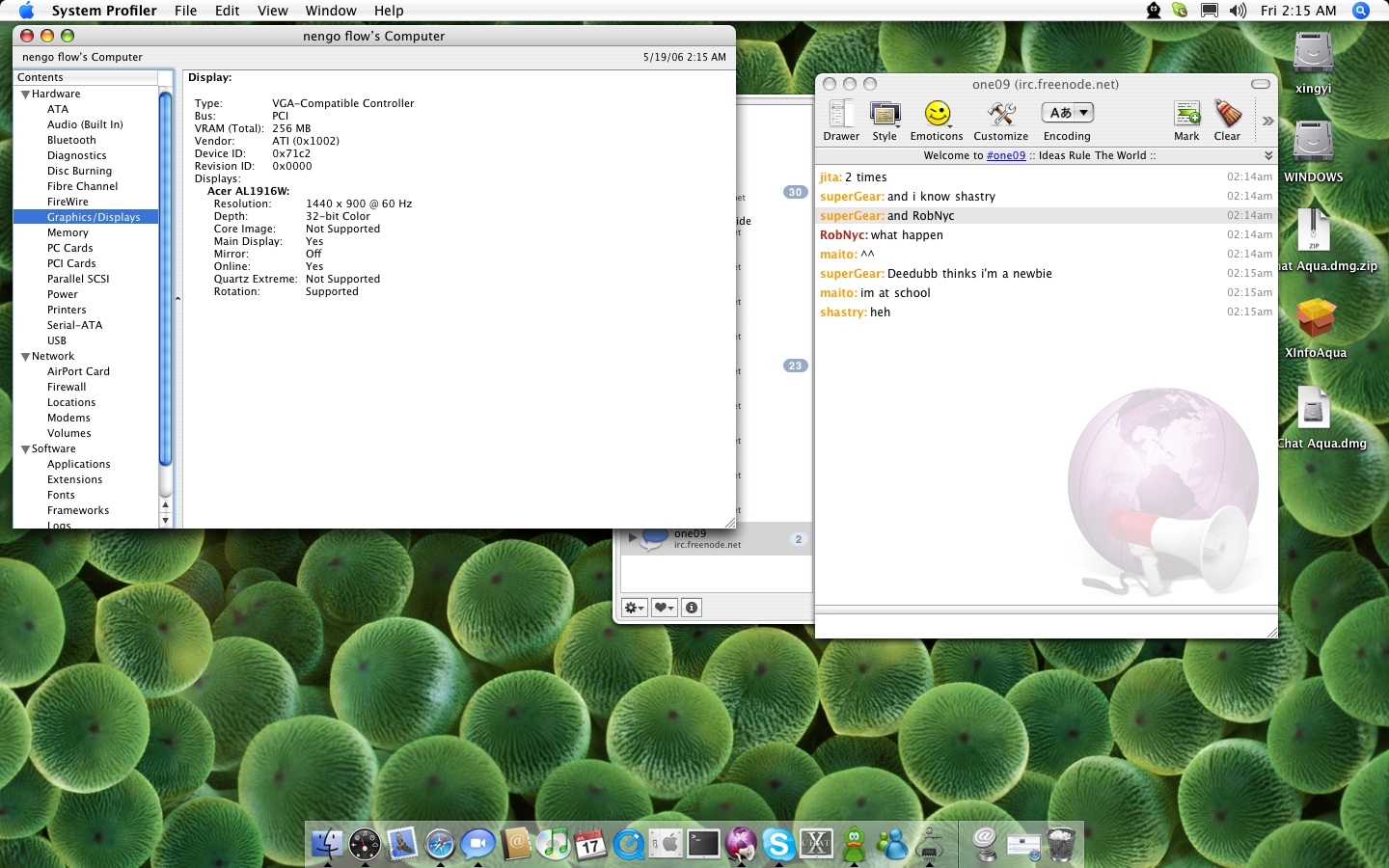

RobNyc Posted May 19, 2006 Author Share Posted May 19, 2006 With Callisto b003 + modified Callisto.kext from omni made on May 17, 2006 while I was testing some stuff for him for the X1kseries cards. System profiler detects my 512mb *NOW* and it says the proper name *THANKS* to callisto/omni. Radeon X1600 PRO (AGP): Chipset Model: Radeon X1600 PRO (AGP) Type: Display Bus: PCI VRAM (Total) : 512 MB Vendor: ATI (0x1002) Device ID: 0x71c2 Revision ID: 0x0000 Display: Display: Resolution: 1024 x 768 @ 60 Hz Depth: 32-bit Color Core Image: Not Supported Main Dsiplay: Yes Mirror: Off Online: Yes Quartz Extreme: Not Supported Jas 10.4.6 Link to comment https://www.insanelymac.com/forum/topic/17767-borisbadenov-ati-x1000-series-solution/page/4/#findComment-115464 Share on other sites More sharing options...

oldschool Posted May 19, 2006 Share Posted May 19, 2006 System profiler detects my 512mb *NOW* and it says the proper name *THANKS* to callisto/omni. Radeon X1600 PRO (AGP): Chipset Model: Radeon X1600 PRO (AGP) Type: Display Bus: PCI VRAM (Total) : 512 MB Vendor: ATI (0x1002) Device ID: 0x71c2 Revision ID: 0x0000 Display: Display: Resolution: 1024 x 768 @ 60 Hz Depth: 32-bit Color Core Image: Not Supported Main Dsiplay: Yes Mirror: Off Online: Yes Quartz Extreme: Not Supported Jas 10.4.6 I have read so many of your postings... This posting is a joke. Is this what you want to have? A 512MB g-card without QE and CI and only 1024 x 768 @ 60 Hz ? Let me tell you here are many people who get a fully supported and working X1600. You must have made something wrong or haven´t understood how it works... Rgds. Link to comment https://www.insanelymac.com/forum/topic/17767-borisbadenov-ati-x1000-series-solution/page/4/#findComment-115475 Share on other sites More sharing options...

RobNyc Posted May 19, 2006 Author Share Posted May 19, 2006 Here's mine I been seeing a lot of question on 10.4.6.. I have it working under Jas 10.4.6 folks.. Sapphire Radeon X1600 Pro 512mb AGP (only 256mb detected though) LCD/Widescreen is finally detected via VGA = Acer AL1916W and I finally have a proper native widescreen resolution 1440x900 But for some reason I didn't get qe/ci like others. A suggestion, opening a temporary irc channel for ATI-X1000 would be good for fast answers and keeping this thread with the tools. Link to comment https://www.insanelymac.com/forum/topic/17767-borisbadenov-ati-x1000-series-solution/page/4/#findComment-115500 Share on other sites More sharing options...

cyclonefr Posted May 19, 2006 Share Posted May 19, 2006 RobNYC u dont get CEQI cause i bet uve modified the X1000GA.plugin ahaha remove CAllistoFB to it and switch back to IONDRVFramebuffer enjoy Link to comment https://www.insanelymac.com/forum/topic/17767-borisbadenov-ati-x1000-series-solution/page/4/#findComment-115524 Share on other sites More sharing options...
