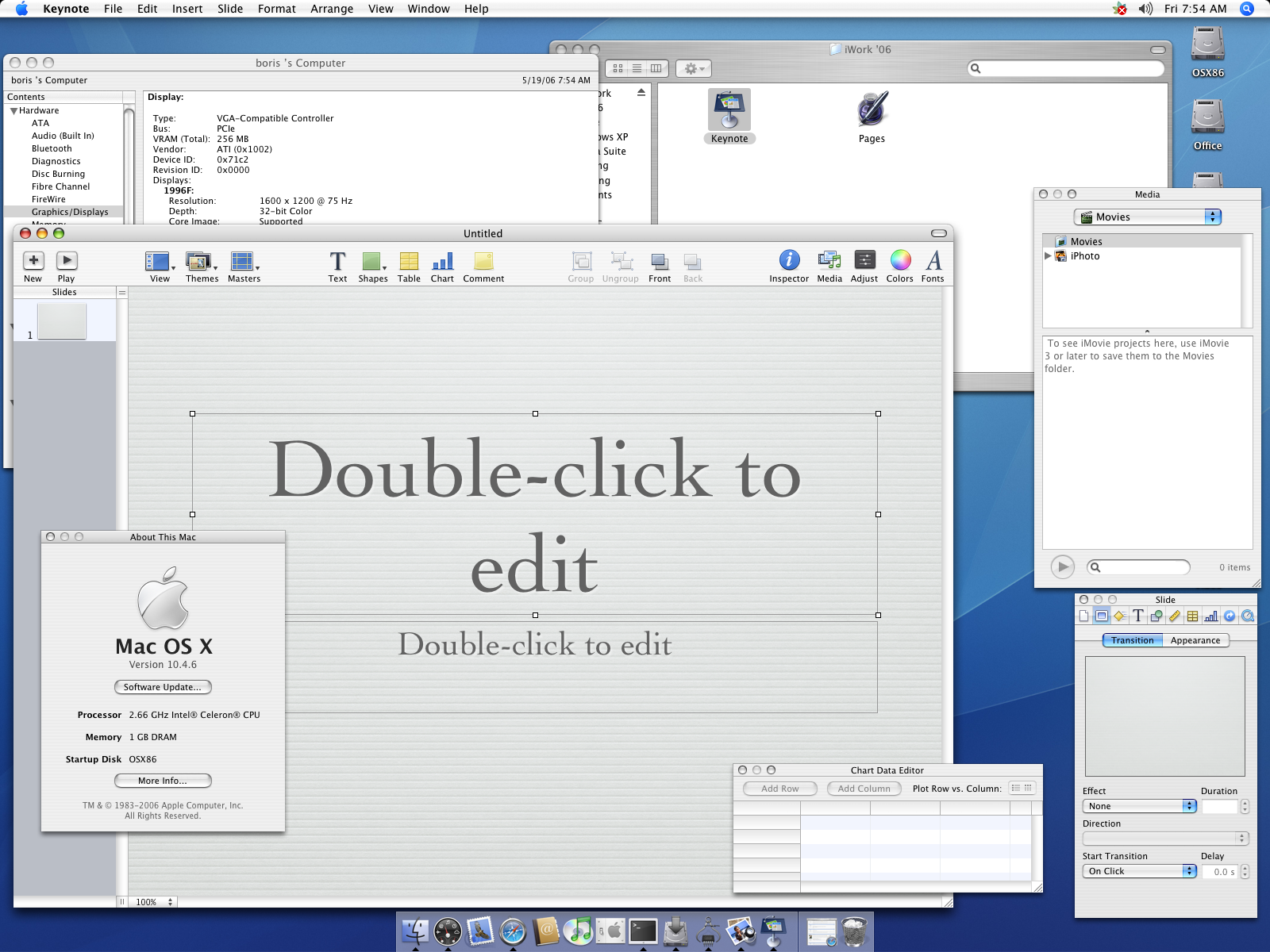

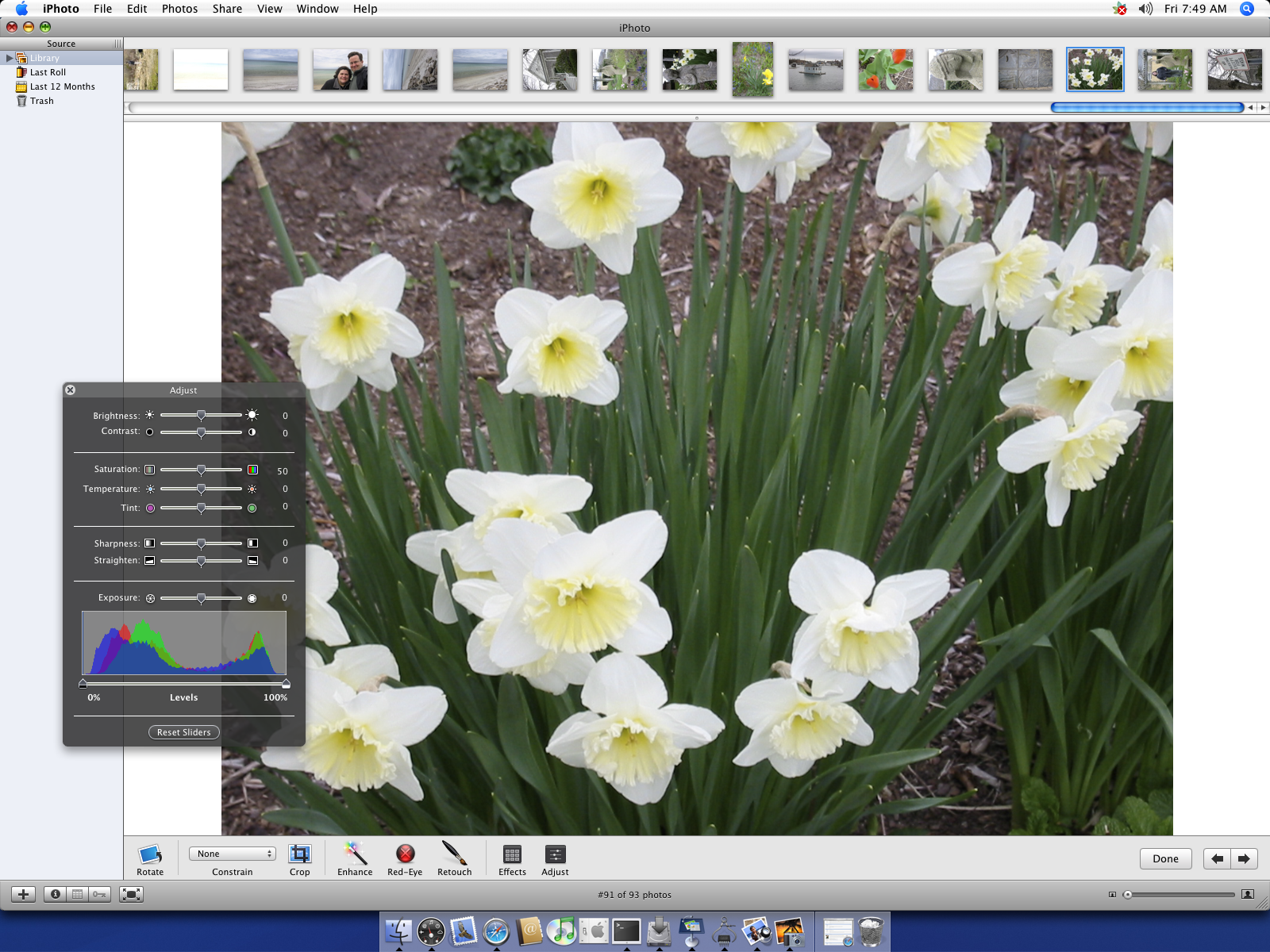

borisbadenov Posted May 19, 2006 Share Posted May 19, 2006 Hi, can someone try if after full screen OpenGL app (like KeyNote and iPhoto) mouse is still scrambled???? If not I will buy immediately this card! Thanks Hey, I tried out both Keynote and iPhoto and in both cares, the mouse was perfect. I have the screen shots but in them, the mouse is not shown, but believe me, it works perfect Link to comment https://www.insanelymac.com/forum/topic/17767-borisbadenov-ati-x1000-series-solution/page/6/#findComment-115642 Share on other sites More sharing options...
cyclonefr Posted May 19, 2006 Share Posted May 19, 2006 the fact the mouse isnt shown in screenshot is normal : like this on real mac to make perfect screenshot boris is the gui really faster? what else scrolling give u better result on website? Link to comment https://www.insanelymac.com/forum/topic/17767-borisbadenov-ati-x1000-series-solution/page/6/#findComment-115643 Share on other sites More sharing options...
merak Posted May 19, 2006 Share Posted May 19, 2006 Type: VGA-Compatible Controller Bus: PCIe VRAM (Total): 256 MB Vendor: ATI (0x1002) Device ID: 0x71c0 Revision ID: 0x0000 Displays: SyncMaster: Resolution: 1440 x 900 @ 75 Hz Depth: 32-bit Color Core Image: Supported Main Display: Yes Mirror: Off Online: Yes Quartz Extreme: Supported Rotation: Supported mine working flawlessy Link to comment https://www.insanelymac.com/forum/topic/17767-borisbadenov-ati-x1000-series-solution/page/6/#findComment-115644 Share on other sites More sharing options...
borisbadenov Posted May 19, 2006 Share Posted May 19, 2006 Hi, can someone try if after full screen OpenGL app (like KeyNote and iPhoto) mouse is still scrambled???? If not I will buy immediately this card! Thanks Hey, I tried out both Keynote and iPhoto and in both cares, the mouse was perfect. I have the screen shots but in them, the mouse is not shown, but believe me, it works perfect. Link to comment https://www.insanelymac.com/forum/topic/17767-borisbadenov-ati-x1000-series-solution/page/6/#findComment-115645 Share on other sites More sharing options...
borisbadenov Posted May 19, 2006 Share Posted May 19, 2006 the fact the mouse isnt shown in screenshot is normal : like this on real mac to make perfect screenshot boris is the gui really faster? what else scrolling give u better result on website? To answer you question, yes. I have noticed that my GUI is much fatser, more responsive. Also, with games like Civilization 3, Call of Duty, Rise of Nations, I can play full screen, full resolution om all games and not a glitch at all. I had a friend play CoD last night, did not let him know it was on my OSX86 til we finished the game, he was amazed. Always with my GMA900, it was a bit sluggish and never when settings were pushed to the max. The only downside so far is a longer boot time; it is now as long as XP, gasp!!! Still, as JaS said, I can live with that small discomfort. Everry other aspect to this card is wonderful, makes it respond visually and in speed to a real mac (but much cheaper) and besides, I have looked at the new intels and they only offer 128mb. Also, FInal Cut, iMovie, iPhoto, iDVD, all work great too Link to comment https://www.insanelymac.com/forum/topic/17767-borisbadenov-ati-x1000-series-solution/page/6/#findComment-115650 Share on other sites More sharing options...
