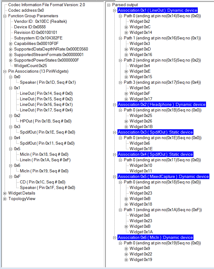

dgsga Posted June 2, 2009 Share Posted June 2, 2009 Hi All Anyone else having problems with sound input after update to 10.5.7? I've tried importing plists from 10.5.6 slim kext to 10.5.7 AppleHDA but only input working is now Rear Mic. Line In shows up in System Prefs but does not seem to be active (no changes in volume levels when sound coming in). Link to comment https://www.insanelymac.com/forum/topic/161430-realtek-alc1200-ich10-working-kext-on-yosemite-1010-from-106/page/4/#findComment-1168352 Share on other sites More sharing options...
marionez Posted June 3, 2009 Author Share Posted June 3, 2009 You would work on 10.5.7 info.plist directely. I can't figure out why can't get input working, but seems like with this 10.5.7 shutd/reb is more reliable. Anyway we have verbs and input scheme, now I think we have just to try some new settings good for 10.5.7, I've not so many time to work on this, so help is very appreciated, I already spent much. Things to check: Pathmaps and Layouts inside AppleHDA.kext/Contents/PlugIns/AppleHDAPlatformDriver.kext/Info.plist Verbs inside AppleHDA.kext/Contents/PlugIns/AppleHDAController.kext/Contents/Info.plist I would think that verbs are not the problem. ALC1200_1057.zip Link to comment https://www.insanelymac.com/forum/topic/161430-realtek-alc1200-ich10-working-kext-on-yosemite-1010-from-106/page/4/#findComment-1168908 Share on other sites More sharing options...
dgsga Posted June 3, 2009 Share Posted June 3, 2009 Marionez I've also spent hours on this! Have found that line in shares same input/mixer as rear mic (see attachment) and have set up pathmaps exactly as in this picture. My Asus ALC1200 codec is parsed as ALC888 but you'll see the Nodes (Pin Associations) in the picture are the same as yours. All works great except for LineIn and FrontMic (shows up as 'None' in System Profiler). I can only think it's to do with MuteGPIO values, have tried loads of different combinations with no success. I agree verbs are unlikely to be the cause, I've been using ones which are virtually identical to yours. The AppleHDA.kext has always been a pain in the a**e, if only it was more universal like otherHDA drivers. VoodooHDA is heading in the right direction (great work) but has a way to go with inputs! Link to comment https://www.insanelymac.com/forum/topic/161430-realtek-alc1200-ich10-working-kext-on-yosemite-1010-from-106/page/4/#findComment-1169112 Share on other sites More sharing options...
