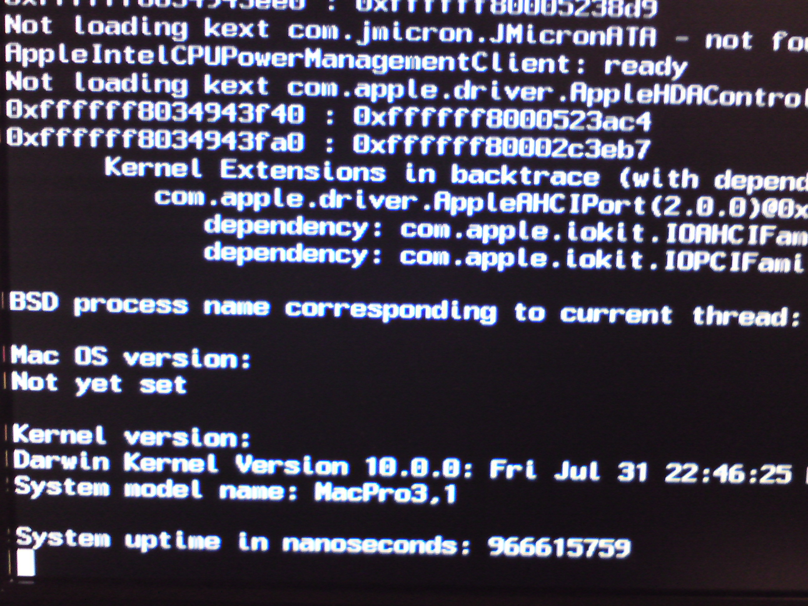

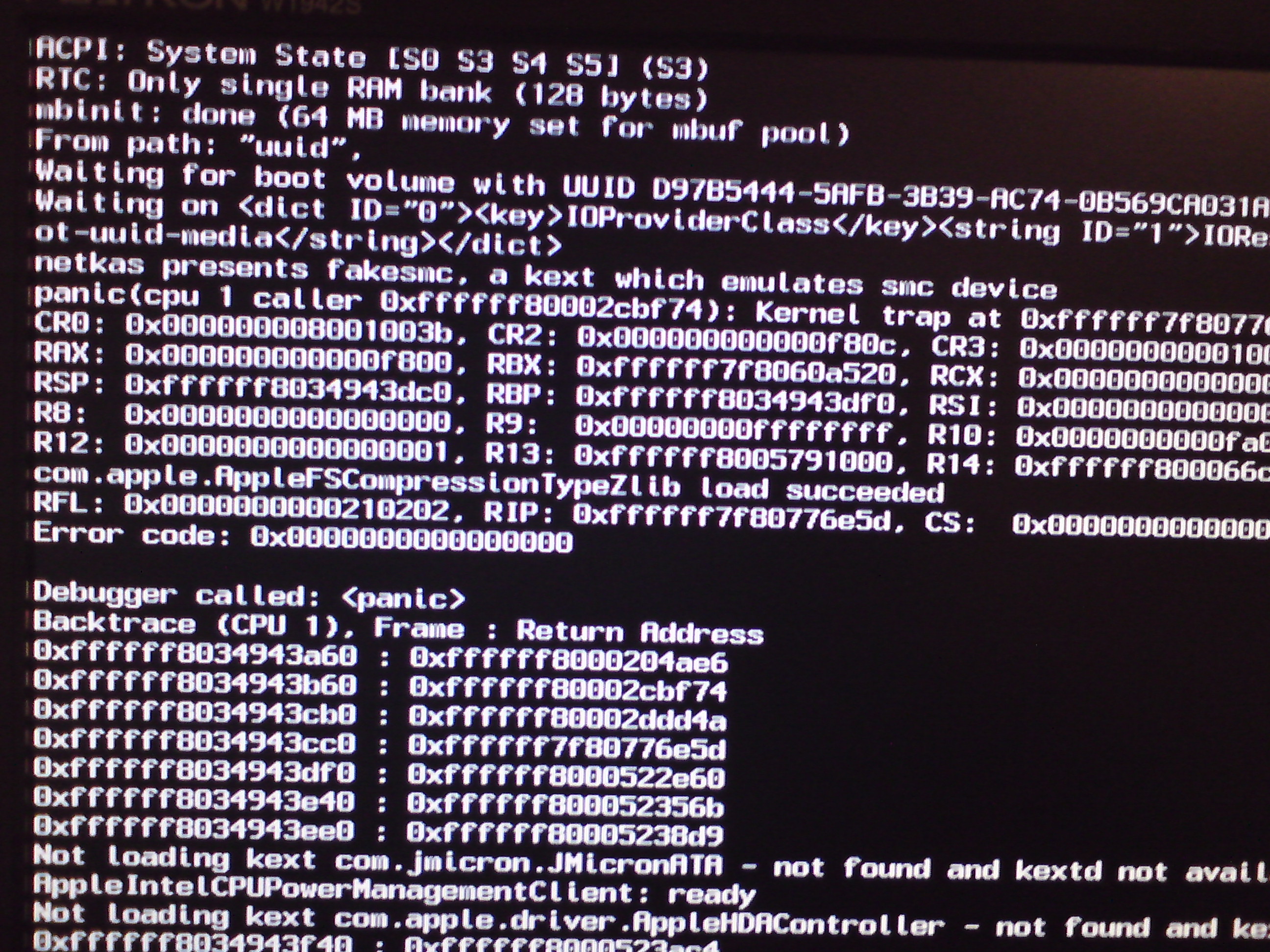

I am running SL using onboard IDE, I am using this JMicronATA.kext in /Extra/Extensions. Let us know if it worked for you.
I'm looking for a way to boot in IDE mode (I don't like AHCI mode). Your kext didn't work for me. I replaced the kexts /System/Library/Extensions/JMicronATA.kext (just in case) and /Extra/Extensions/JMicronATA.kext with "your" JMicronATA.kext. Booting in verbose mode, I see following messages:
Not loading kext com.jmicron.JMicronATA - not found and kextd not available in early boot
Mac OS version:
not yet set
Need help!

hi,
what does that mean, you don't like AHCI mode? As I see, you have a SATA-HDD, so use AHCI mode.
You will only need the JMicronATA.kext, if you're using an IDE-Device on your IDE-Port.

After switching to AHCI mode I can no longer boot into Windows XP. I have to change back to IDE mode each time I need to use Windows. Also my DVD drive sometimes becomes unresponsive until I totally shutdown my computer and turn it on again.
Regarding the difference between /S/L/E and /E/E, I've googled but haven't found any information on that. So I asked here.
So there's no way of booting in IDE mode because my HDD is SATA?
Thank you.
Of course. I have the same setup. I set IDE mode, installed XP, everything worked fine then I installed a second hard drive, changed to AHCI mode, installed Mac OS X and all works, except that I can't boot Win XP in AHCI mode because I did not install the AHCI drivers when I installed XP.
I am not sure I want to reinstall Win XP, so most likely I'lll leave the setup as is for now. You can go to the Gigabyte website, locate the page for your motherboard, download the AHCI driver, make the floppy disk and have them ready next time you install Win XP. Hit F6 when the setup is loading drivers.
There are procedures online that show you how to install AHCI drivers in Windows XP after the install, but I have not been able to get any one of them to work. At this time my DVD ROM drive, Mac OS X drive and Win XP drive are all SATA. Regards, SGarcia

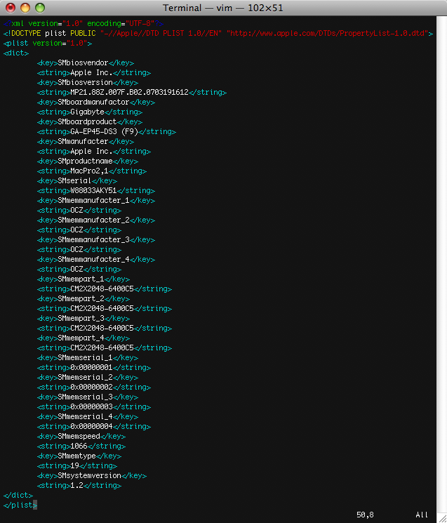

Also e60, the smbios, how do we know what specifications are available? Obviously you use GEIL memory, but how did you know that...
<key>SMmemmanufacter_4</key>
<string>G.E.I.L.</string>
<key>SMmempart_1</key>
<string>CM2X2048-6400C5</string>
would be correct?
Let me quote AsereBLN´s declaration of the smbios.plist, it might help you to find your specifications:
My Chameleon-EFI Mac already works perfectly for me, but there are still some cosmetic issues, like the Serialnumber or the information about the installed memory. This can be adjusted with a file called smbios.plist in the Extra folder of the Chameleon USB-stick. The values in this property-list defines the hardware on which Mac OS X is running. You will find more information about the SMBIOS in Wikipedia here. Mine smbios.plist looks like this:
The values "SMexternalclock" and "SMmaximalclock" will be set by Chameleon automatically with the real values. As I know these values are the only important ones, but thanks to Chameleon you don't have to care about it. I selected a Mac Pro for the values in smbios.plist because this Mac is very close to my PC.
  • SMboardmanufactor: the mainboard manufactor
  • SMboardproduct: the mainboard type
  • SMmemmanufacter_X: the memory manufactor
  • SMmempart_X: the memory part number
  • SMmemserial_X: the memory serial number
  • SMmemspeed: the memory speed in Mhz
  • SMmemtype: the memory type DDR2=19, DDR3=24
