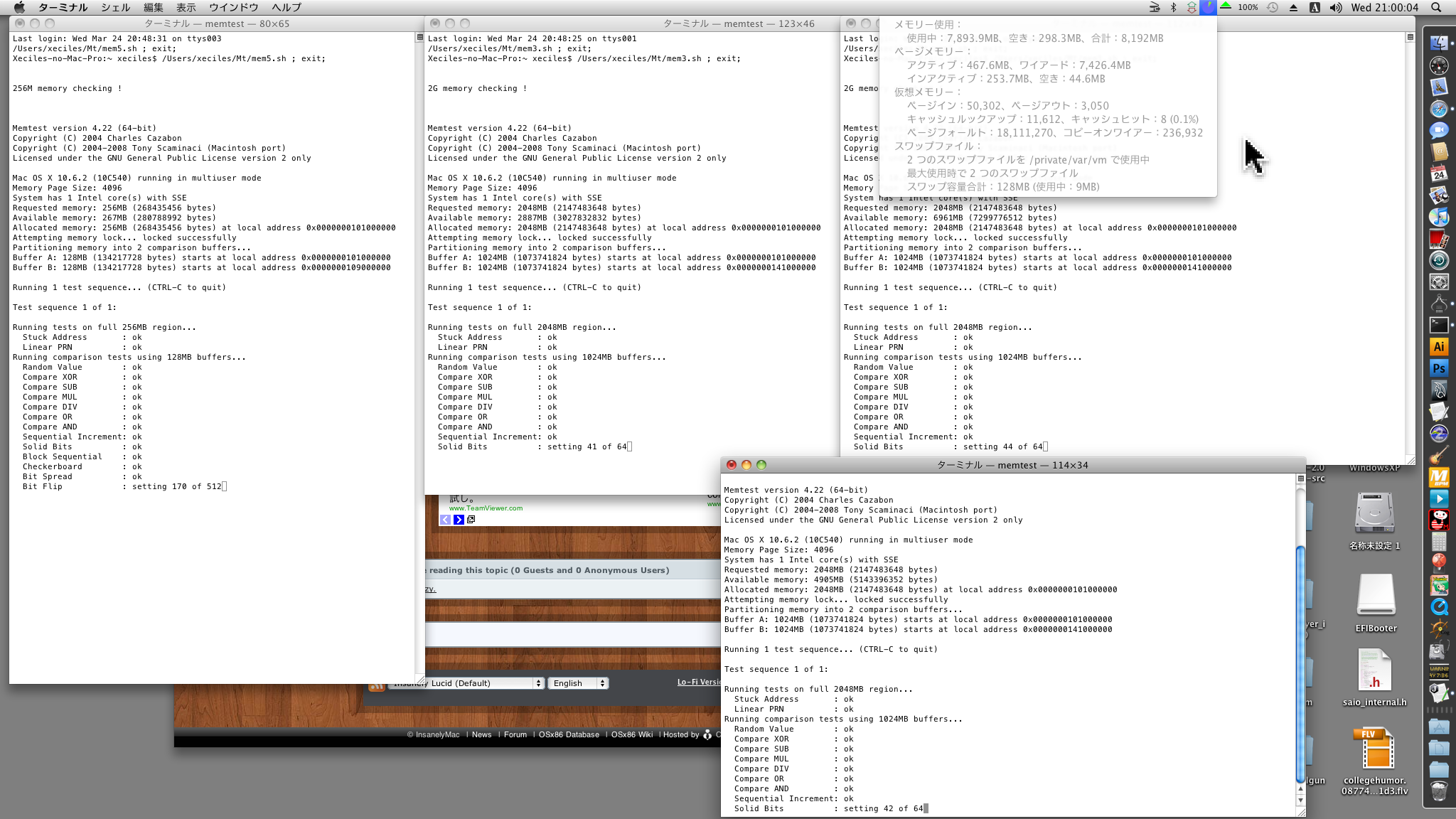

Kzzy. Posted March 24, 2010 Share Posted March 24, 2010 I succeeded, GA-E7AUM-DS2H on 8GB memory. I am Japanese. sorry ,Broken English. fast look, I use memory test tools, memtest.zip This tool is "Allocated Memory Lock" in use . but ,over 4096MBytes is Darwin Kernel said, ' Ouch !! , Don't Lock.... ' "Dah~~~~!! Terminal Multi Starting!!!!! " ....I Said. 7893.9M,succeeded.... and, No Kernel panic. Phase 1, BIOS = F4E BIOS Setting, Onboard VGA(Geforce9400M) not use. Video Memory Disable(0MByte) COM Port & PRT Port Disable SATA mode "AHCI" Phase 2, My PCIex Graphic card is "Geforce 9800GTX+ 512MB". Boot partition "USB Card reader"on "SD-Card Volume" Phase 3, Com.Apple.boot.plist "Use "device-properties" with Geforce . Snow Leopard 10.6.2 Vanilla Kext." Phase 4, adidasprince's POSTed Keyword, "Fedora11 iomem" & "Chameleon Patch" And.... single-User mode & Safe mode is non memory problem. !!! "Confrict is PCI Address & Memory Address Interstice Undefined Address??” look it! iomem.8G.0M.rtf iomem_fix.pdf and, Chameleon 2.0 RC4 r684 patched file.(PCI Grabo 512M only?) PCIex512M_Card_source.zip Caution!!!! lspci -v PCI address 0xd0000000 0xe8000000 0xec000000 only!!! Happy Hacking!! oh!, Special Thx. Dr.adidasprince. Link to comment https://www.insanelymac.com/forum/topic/161348-guide-installing-snow-leopardleopard-retail-dvd-on-the-ga-e7aum-ds2h/page/16/#findComment-1433961 Share on other sites More sharing options...
