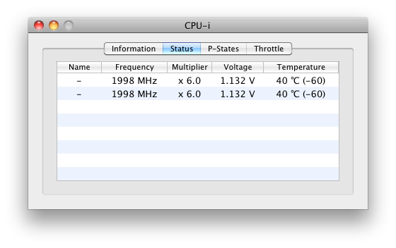

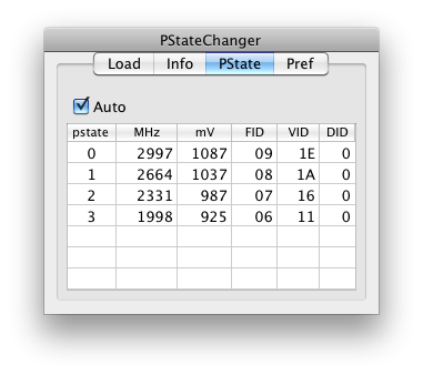

hi e60,
speedstep with your new DSDT is working!
I attached some screenhots:
PStates with VoodooPState.kext by PStateChanger and CPU-i (they shows different proposals)
and Status with CPU-i (normaly both Cores are at 40°C)
Status with your DSDT.
Don't know how exactly these Voltage values has to be, but I think there will be a tolerance.

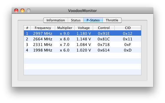

Hmm... strange. Your P-States look different to mine ...
Which DSDT did you use? The newest one I have uploaded today @ 08:27 PM or the one before? And could you please make a screenshot using VoodooMonitor and voodoopstate.v4? CPU-i is not more up to date.
... using your latest DSDT (8:27)
here are the results from VoodooMonitor (they are the same).
May be this results from our different CPU stepping (mine is E0)? That would mean, that OSX override the P-State givin by your DSDT?

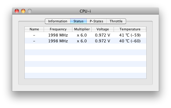

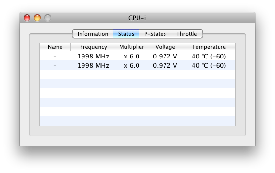

Edit: And an other test - making my own DSDT with the P-State values proposed by the PState-Changer (attached screenshot above). Perhaps you could test this one.
It brings the same values in VoodooMonitor for P-States but the Voltage in Status is lower. (screenshot attached)

... yes, they are - I took the proposal from PState-Changer.
In PState 3 the voltage is lower now (0,972), nearly the same as under win7 (0,992), but hasn't the value of PState-Changer (0,925).
Edit: under win7 PState 0 shows 1,152 vs. 1,180 under OSX (which is the proposed value from VoodooMonitor - the value from PState-Changer (so in my DSDT) is 1,087)
So I assume, OSX takes the correct one?

... Before I forget I have one last request. Could you please make a screenshot from PState-Changer "in action"? ;)
... first screenshot here. PStateChanger needs the VoodooPState.kext. You can load and unload it with your new DSDT too. (on the fly without reboot)
