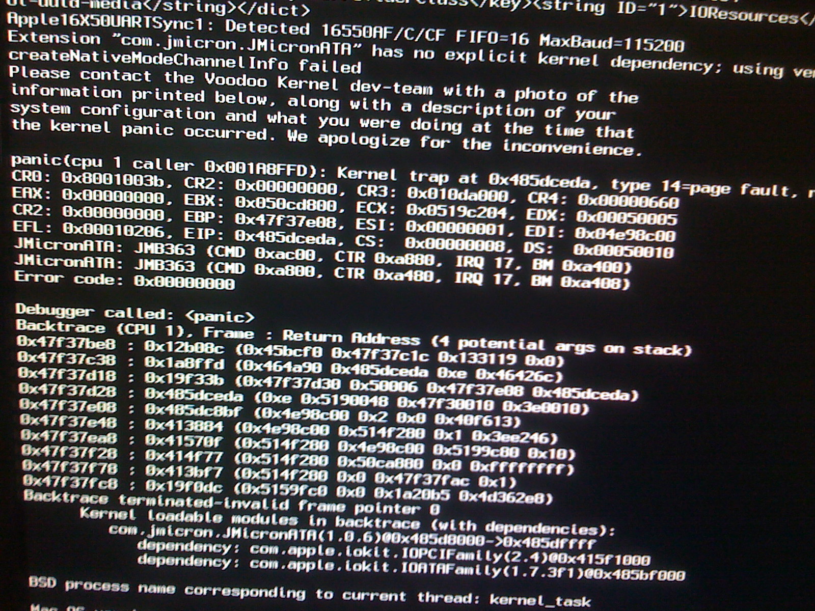

Dragos1900 Posted February 9, 2009 Share Posted February 9, 2009 I assume you get this booting the DVD (you are not clear about that).Try booting with the following flags: -mach_kernel_2 -platform=acpi Hi BlackCH and thanks for the reply. I tried your advise and got the same error. I am trying to boot from the SATA DVD and it stops after 2 seconds with the error I attached earlier. Thank you once again and if you have some other ideas, please let me know. Cheers, Dragos Link to comment https://www.insanelymac.com/forum/topic/142876-xxx_x86_1056_install_disc_universal_finalv2/page/15/#findComment-1074496 Share on other sites More sharing options...

BlackCH Posted February 9, 2009 Author Share Posted February 9, 2009 Hi BlackCH and thanks for the reply.I tried your advise and got the same error. I am trying to boot from the SATA DVD and it stops after 2 seconds with the error I attached earlier. Thank you once again and if you have some other ideas, please let me know. Cheers, Dragos Seems your ATA controller (Jmicron363) is giving you trouble. Try disabling it on the BIOS or disconnect any plugged ATA devices. This is wierd 'cos I have a Jmicron controller myself (Jmicron368 though) and the DVD is booting fine here. Link to comment https://www.insanelymac.com/forum/topic/142876-xxx_x86_1056_install_disc_universal_finalv2/page/15/#findComment-1074535 Share on other sites More sharing options...

Dragos1900 Posted February 9, 2009 Share Posted February 9, 2009 Seems your ATA controller (Jmicron363) is giving you trouble. Try disabling it on the BIOS or disconnect any plugged ATA devices. This is wierd 'cos I have a Jmicron controller myself (Jmicron368 though) and the DVD is booting fine here. I will try this later today and I will let you know. Thank you very much. Dragos Link to comment https://www.insanelymac.com/forum/topic/142876-xxx_x86_1056_install_disc_universal_finalv2/page/15/#findComment-1074648 Share on other sites More sharing options...
Dragos1900 Posted February 9, 2009 Share Posted February 9, 2009 I will try this later today and I will let you know. Thank you very much. Dragos Hi BlackCH, You were right, the Jmicron controller was the issue. I have no ATA devices so it was no problem to disable it in BIOS. The installation went with no problems or issues and everybody who said that your version was fast, were right. It is the FASTEST I ever seen. GREAT WORK!!!! There are some small issues after install but they are not that important: - Time machine is not working, but I didn't try to find a fix yet. Maybe there is one on the DVD that I didn't select. The output in the console is: 2/9/09 11:47:42 PM System Preferences[1498] Time Machine: Error setting backup path: Error Domain=com.apple.TimeMachine.Preferences Code=-1 UserInfo=0x17cbdb20 "Time Machine could not be configured. The built-in network interface could not be found." 2/9/09 11:47:42 PM [0x0-0x26026].com.apple.systempreferences[1498] _CSBackupGetMachineMACAddress - IOServiceGetMatchingServices did not find an ethernet service with kIOPrimaryInterface true The second one is the sound that does not work yet, because I didn't select the apropriate kext. I have SoundMAX® ADI AD1988 adn I know that the stereo output works with Azalia kext. I tried to use another kext (and still trying) so that I can make the input also to work. I would realy want to make the microphone work too. If you know the the answers for these I would very much appreciate it, but otherwise, please try to help some other people that have serious problems. I will try to find a solution myself and I will come back with a comment. Once again, thank you very much for this great OS and for the help. Cheers, Dragos Link to comment https://www.insanelymac.com/forum/topic/142876-xxx_x86_1056_install_disc_universal_finalv2/page/15/#findComment-1075281 Share on other sites More sharing options...
