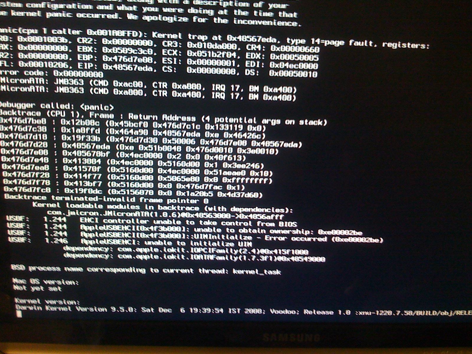

Cannibul Posted February 6, 2009 Share Posted February 6, 2009 This is what I'm getting trying to boot from the unmodified disc. Motherboard is a Gigabyte EP-45-UD3P. I've had no problem installing Kalyway in the past. Thanks. Link to comment https://www.insanelymac.com/forum/topic/142876-xxx_x86_1056_install_disc_universal_finalv2/page/14/#findComment-1071925 Share on other sites More sharing options...

Cannibul Posted February 6, 2009 Share Posted February 6, 2009 Figured out what my problem was. Had the Gigabyte SATA controller enabled in the BIOS and that was causing the panic. Link to comment https://www.insanelymac.com/forum/topic/142876-xxx_x86_1056_install_disc_universal_finalv2/page/14/#findComment-1072019 Share on other sites More sharing options...
