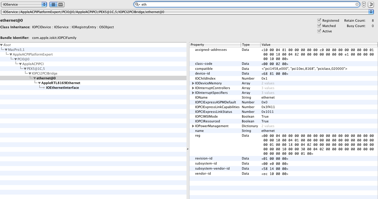

harbri Posted January 18, 2009 Share Posted January 18, 2009 Finally found some time to test the patcher with my EP35-DS4 with partial succes. My Geforce 8800GTS is now fully working without injector or efi-string. This is excellent, thanks koalala! What I can't get working though is the onboard networkcard, I still need the patched IONetworkingFamily kext to connect to my Apple Airport Router in the Airport Utility or to use the printer attached to it. I've tried all the options and combination of options but it simply won't work. According to the IOreg tool it should be on PEX5 but that doesn't work. I've also tried PCI0 but that also doesn't work. Anyone with a EP35-DS4 got this working or knows what to do? Attached is a screenprint of IORegistryExplorer (with the ethernet entry) and the dsdt file. dsdt.aml.zip Link to comment https://www.insanelymac.com/forum/topic/142434-acpi-dsdt-patcher-for-bios-and-aml/page/13/#findComment-1046217 Share on other sites More sharing options...
atka Posted January 18, 2009 Share Posted January 18, 2009 Finally found some time to test the patcher with my EP35-DS4 with partial succes. My Geforce 8800GTS is now fully working without injector or efi-string. This is excellent, thanks koalala! What I can't get working though is the onboard networkcard, I still need the patched IONetworkingFamily kext to connect to my Apple Airport Router in the Airport Utility or to use the printer attached to it. I've tried all the options and combination of options but it simply won't work. According to the IOreg tool it should be on PEX5 but that doesn't work. I've also tried PCI0 but that also doesn't work. Anyone with a EP35-DS4 got this working or knows what to do? Attached is a screenprint of IORegistryExplorer (with the ethernet entry) and the dsdt file. I have the same problem with a network card (addon)on my P5k. The one thing that I notice that is the name of your card is ethernet and so is mine. This might be causing some kind of problem. Link to comment https://www.insanelymac.com/forum/topic/142434-acpi-dsdt-patcher-for-bios-and-aml/page/13/#findComment-1046354 Share on other sites More sharing options...
