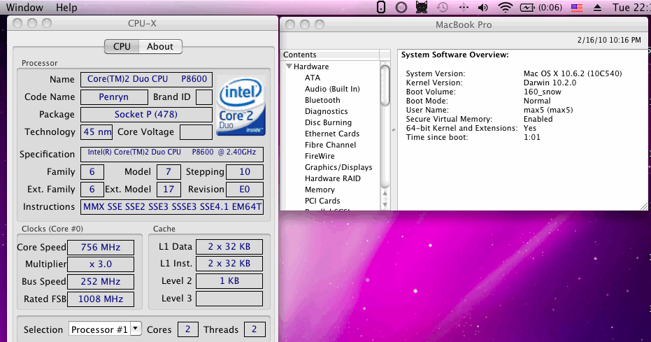

max5 Posted February 16, 2010 Share Posted February 16, 2010 E6400 10.6.2 64/32bit enable sound :output ok speedstep:ok wifi:ok lan:ok graphic:nv160 qi/ce ok ,vga output ok shutdown:can stop hdd,but cant poweroff touchpad+trackpoint:ok bluetooth:ok ,i use magic mouse battery:ok,3hr (nearby) Link to comment https://www.insanelymac.com/forum/topic/134430-install-dell-latitude-e6400-e6500/page/15/#findComment-1411373 Share on other sites More sharing options...
