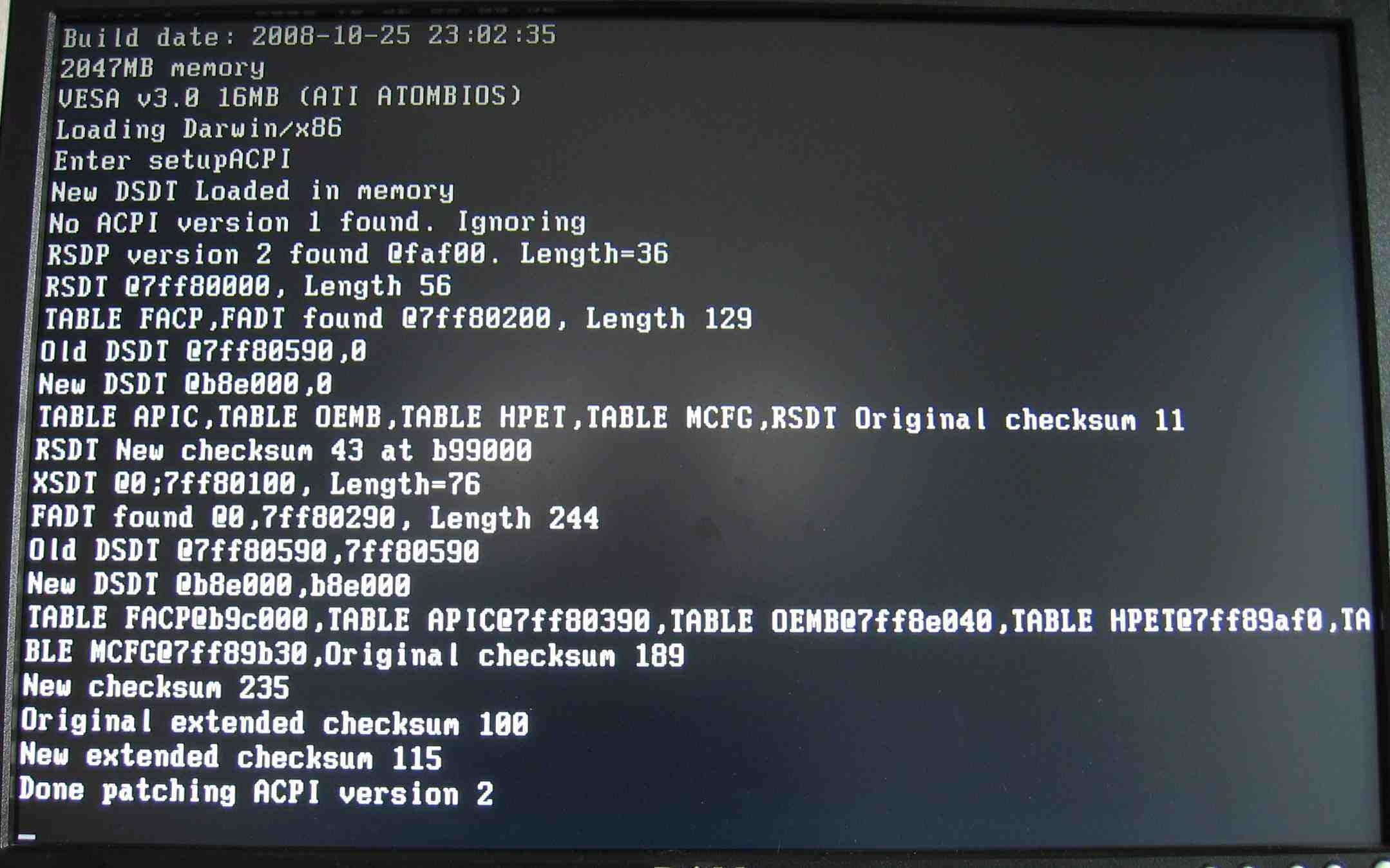

Signal64 Posted January 12, 2009 Share Posted January 12, 2009 Using the debug patch I see what looks like my DSDT.aml is getting loaded (see pic) I get a "No ACPI version 2 found" and after the debug timeout it reboots piratically right away as if it didn't process the DSDT.aml. This is for an MSI P7NGM-Digital which uses an AMI bios. I have an ASUS P57NA-VM which shares the same chipset with an AMI bios and an almost identical DSDT. I can take the DSDT made for the MSI and boot the ASUS just fine (it also generates a No ACPI version 2 found message). So I'm not sure where this is going wrong. It looks like it isn't paying attention to the changes on the MSI. Normally just the CPU Alias and a RTC fix should be enough for it to boot with a PM disabler. But again, I get the reboot instead. Any ideas? msimod1_dsdt.zip Link to comment https://www.insanelymac.com/forum/topic/132757-chameleon-with-dsdt-override/page/10/#findComment-1037487 Share on other sites More sharing options...
