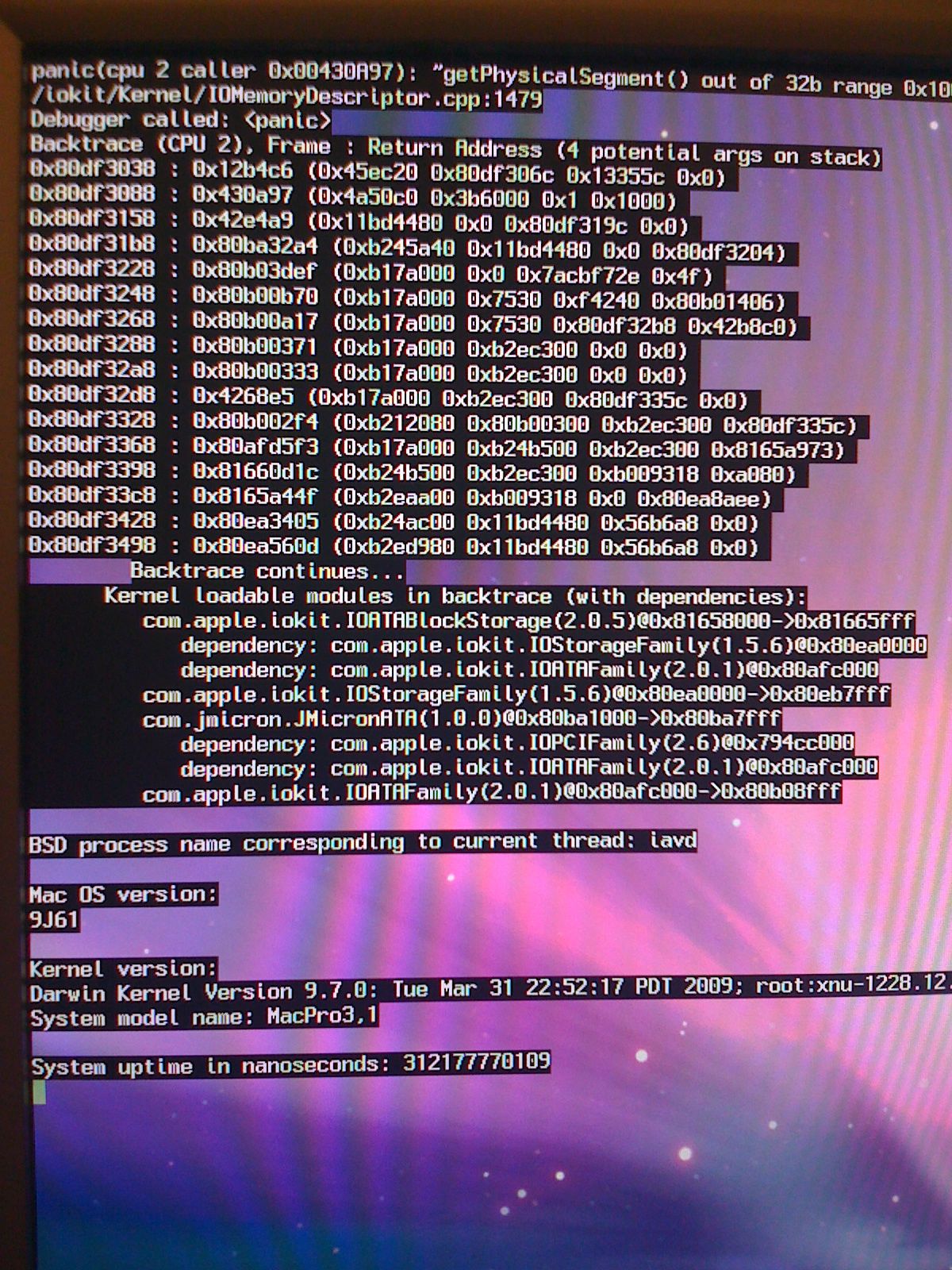

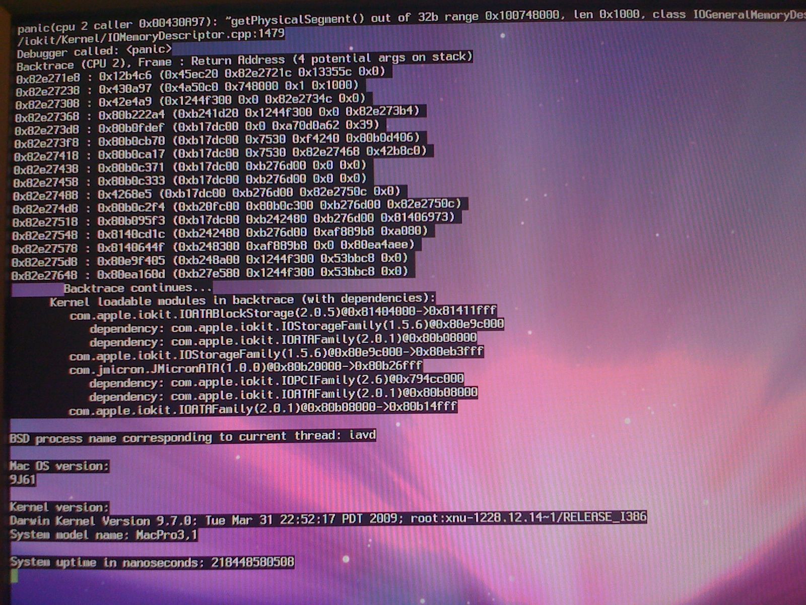

macwars Posted June 29, 2009 Share Posted June 29, 2009 Can you tell me which one i should take?I tried JMicron but with 6GB it doesn't work. Thx! Here is my dump.txt Still need help, please! Link to comment https://www.insanelymac.com/forum/topic/127611-appleviaata-over-4gb-ram-bug-solved-at-least-i-believe-so-jmicron-and-applenforceata-at-development/page/20/#findComment-1188465 Share on other sites More sharing options...
slashack Posted June 29, 2009 Author Share Posted June 29, 2009 Still need help, please! So if u need help, then tell us what happens. We cant guess. We need more than just a dump. What happens with modified JMicronATA.kext? Link to comment https://www.insanelymac.com/forum/topic/127611-appleviaata-over-4gb-ram-bug-solved-at-least-i-believe-so-jmicron-and-applenforceata-at-development/page/20/#findComment-1188654 Share on other sites More sharing options...

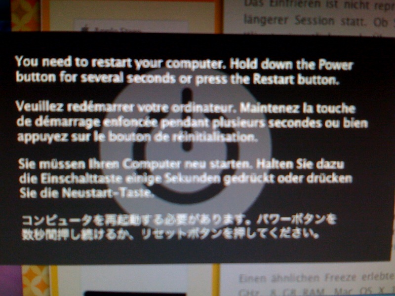

macwars Posted June 30, 2009 Share Posted June 30, 2009 Ok, sorry! My System run for 1-2 hours very fine. After this time the PC freezes with this Screenshot and i have to hardreset it. Link to comment https://www.insanelymac.com/forum/topic/127611-appleviaata-over-4gb-ram-bug-solved-at-least-i-believe-so-jmicron-and-applenforceata-at-development/page/20/#findComment-1189083 Share on other sites More sharing options...
slashack Posted June 30, 2009 Author Share Posted June 30, 2009 Ok, sorry!My System run for 1-2 hours very fine. After this time the PC freezes with this Screenshot and i have to hardreset it. Boot with -v debug=0x100. What happens when u try modified kext from darwin-ata? Link to comment https://www.insanelymac.com/forum/topic/127611-appleviaata-over-4gb-ram-bug-solved-at-least-i-believe-so-jmicron-and-applenforceata-at-development/page/20/#findComment-1189150 Share on other sites More sharing options...
