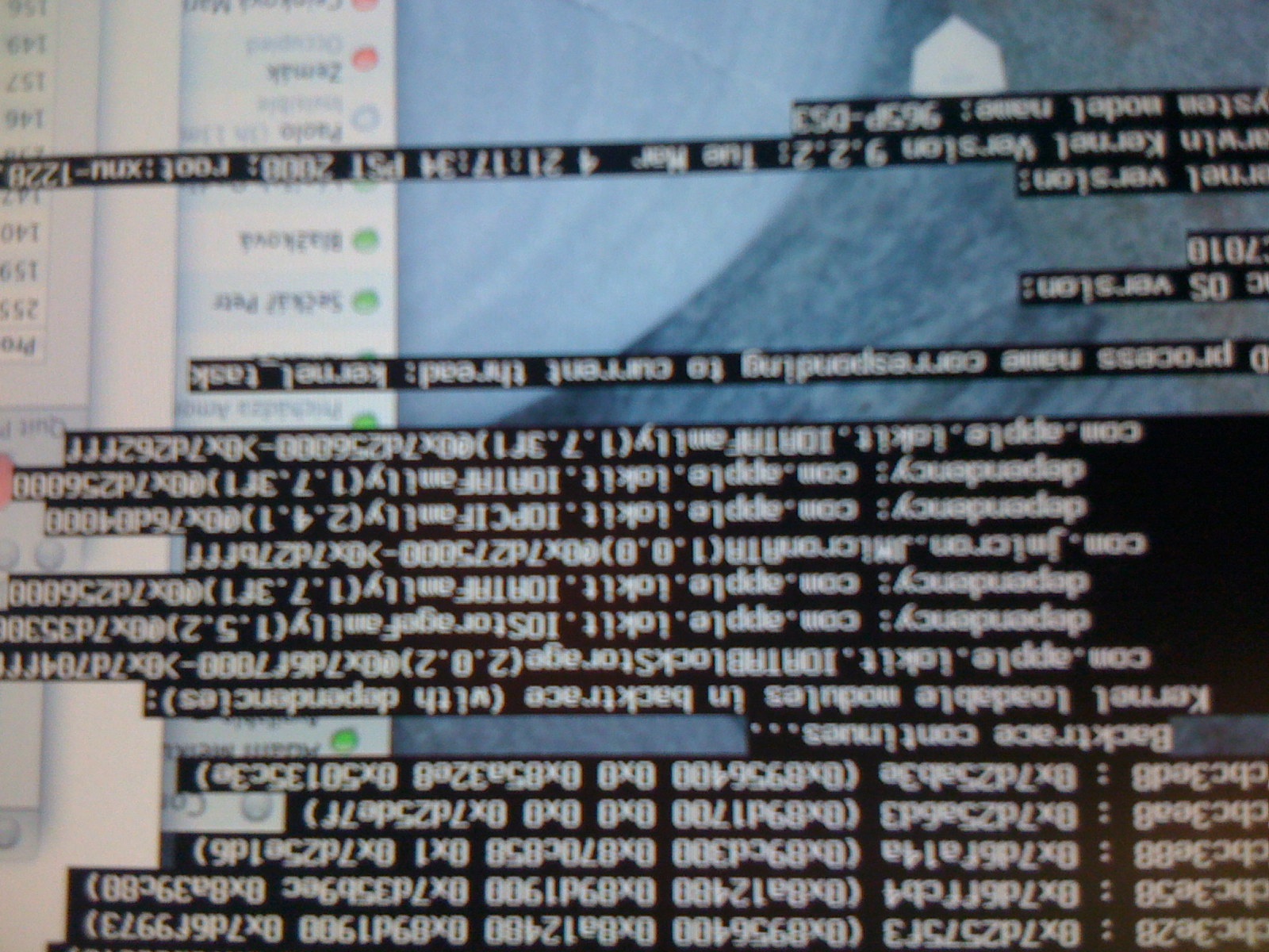

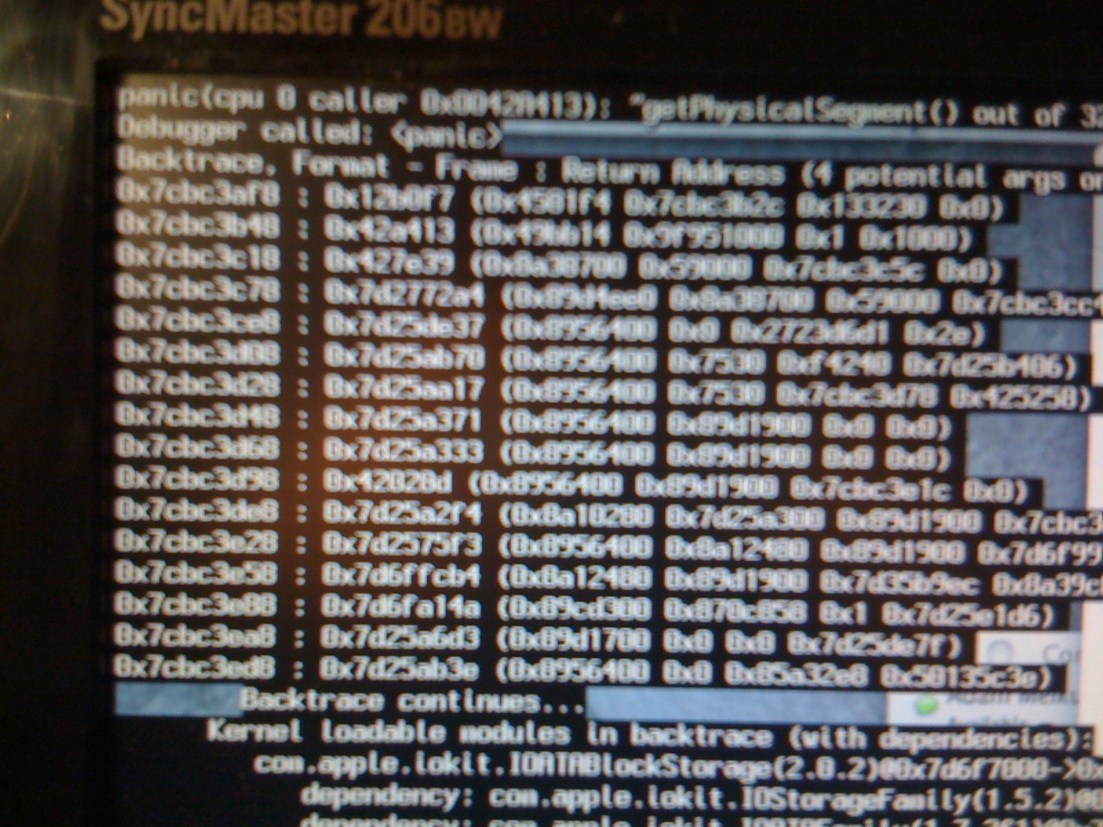

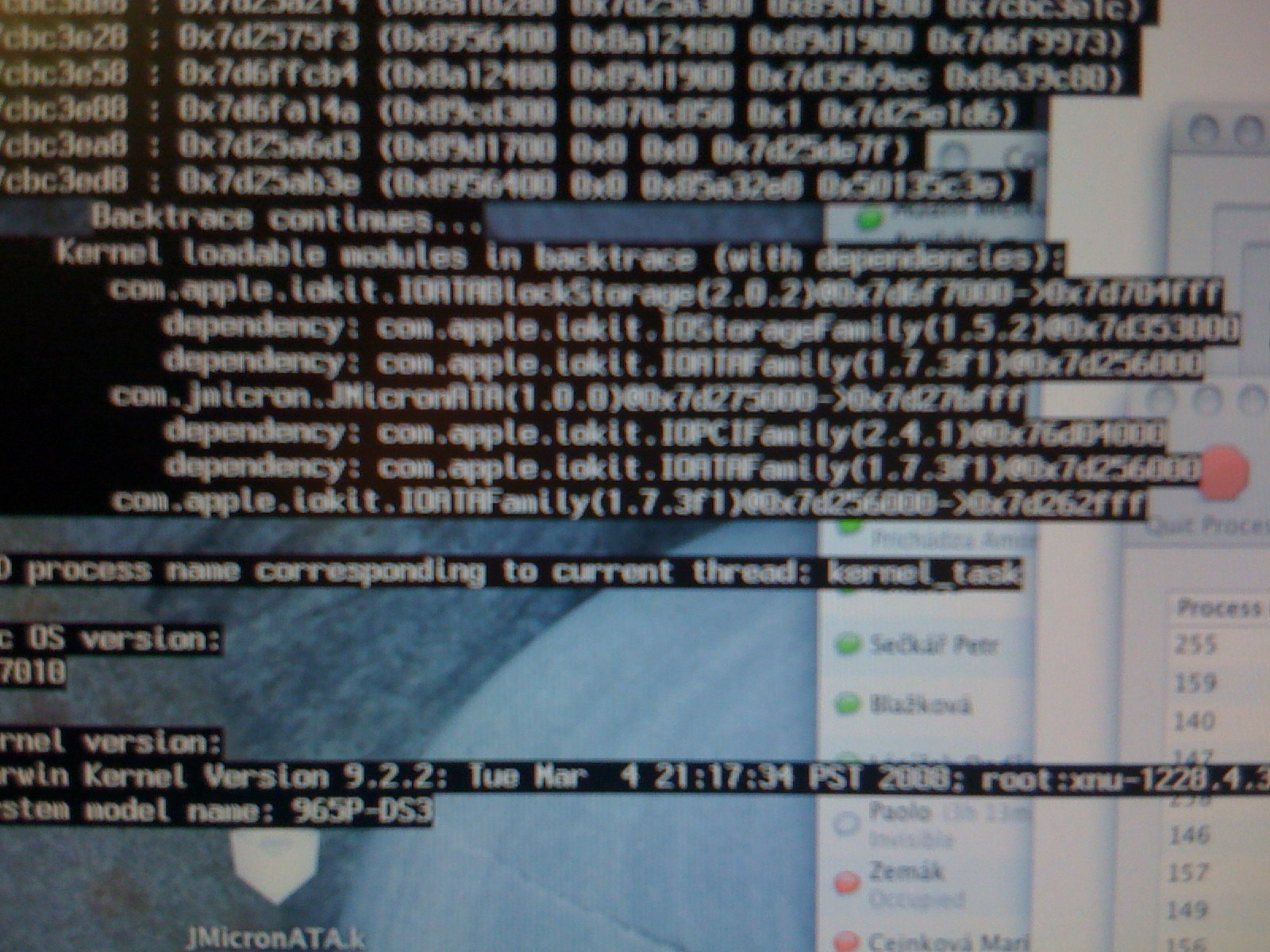

adusak Posted October 7, 2008 Share Posted October 7, 2008 Hi have problems with jmicron controller but only with my PATA drive SATA works fine. I get panic only if i use PATA drive and if i delete jmicron kext i dont see my PATA drive but i get no panics. I include pictures of the screen and dump.txt dump.txt Link to comment https://www.insanelymac.com/forum/topic/127611-appleviaata-over-4gb-ram-bug-solved-at-least-i-believe-so-jmicron-and-applenforceata-at-development/#findComment-921554 Share on other sites More sharing options...
slashack Posted October 7, 2008 Author Share Posted October 7, 2008 Hi have problems with jmicron controller but only with my PATA drive SATA works fine. I get panic only if i use PATA drive and if i delete jmicron kext i dont see my PATA drive but i get no panics. I include pictures of the screen and dump.txt Thanks! That´s the same issue, i´ll try and correct it today or tomorrow. Wait for my post. Link to comment https://www.insanelymac.com/forum/topic/127611-appleviaata-over-4gb-ram-bug-solved-at-least-i-believe-so-jmicron-and-applenforceata-at-development/#findComment-921627 Share on other sites More sharing options...

slashack Posted October 8, 2008 Author Share Posted October 8, 2008 Hi have problems with jmicron controller but only with my PATA drive SATA works fine. I get panic only if i use PATA drive and if i delete jmicron kext i dont see my PATA drive but i get no panics. I include pictures of the screen and dump.txt I think the problem is solved, test them and in case they don't work, send me more pictures (with the debugging kext). I cannot test them, i don't have that hw. AppleNForceATA.kext (http://forum.insanelymac.com/index.php?showtopic=77071) has exacly the same problem! It randomly freezes with 4gb and I always have to boot with maxmem=2048. I booted with debug=0x100 and saw that the error is related to this kext. Would love to use 4gb ram, do you think that it can be fixed? If the problem is the same as JMicron and AppleVIA, i can solve it, send me screen photos of your kernel panic booting with -v debug=0x100. Try to include the whole screen. In the first line you can see where the problem is. If the problem is using 32 bits addresses in stead of using 64 bit, i could try and fix it. Link to comment https://www.insanelymac.com/forum/topic/127611-appleviaata-over-4gb-ram-bug-solved-at-least-i-believe-so-jmicron-and-applenforceata-at-development/#findComment-922646 Share on other sites More sharing options...
adusak Posted October 8, 2008 Share Posted October 8, 2008 I think the problem is solved, test them and in case they don't work, send me more pictures (with the debugging kext). I cannot test them, i don't have that hw. I just installed your kexts using the kexthelper and after restart my PATA hdd is not found and when the system boots with -v there is no reference to jmicron as it always was with the original kext. Link to comment https://www.insanelymac.com/forum/topic/127611-appleviaata-over-4gb-ram-bug-solved-at-least-i-believe-so-jmicron-and-applenforceata-at-development/#findComment-922675 Share on other sites More sharing options...
slashack Posted October 8, 2008 Author Share Posted October 8, 2008 I just installed your kexts using the kexthelper and after restart my PATA hdd is not found and when the system boots with -v there is no reference to jmicron as it always was with the original kext. Can you post your old JMicron kext Info.plist? Try booting with -v -f debug=0x100 The driver is not loading for some reason. 1 Link to comment https://www.insanelymac.com/forum/topic/127611-appleviaata-over-4gb-ram-bug-solved-at-least-i-believe-so-jmicron-and-applenforceata-at-development/#findComment-922680 Share on other sites More sharing options...
