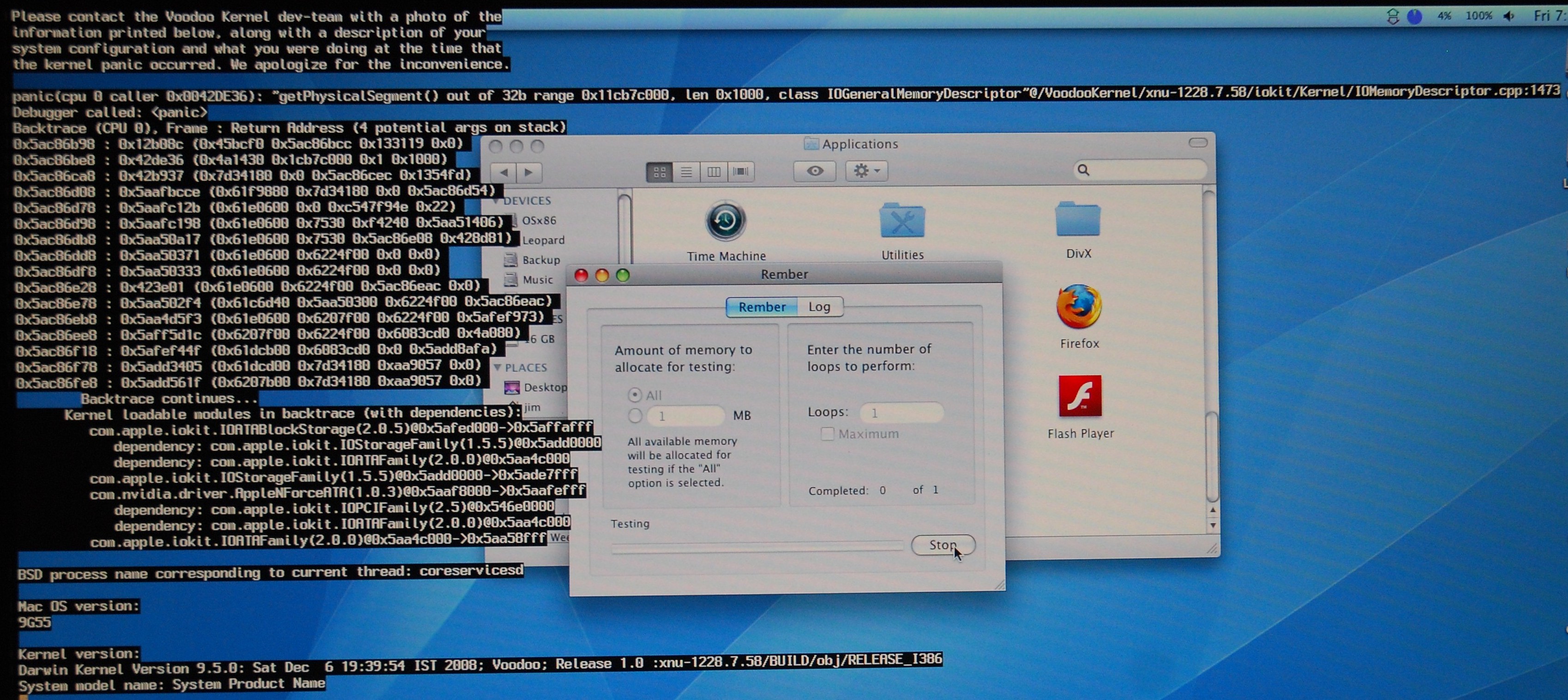

Eddie Turfboer Posted April 8, 2009 Share Posted April 8, 2009 Using a Intel DP43TF (Intel P43 Southbridge - ICH10) on 2 x 2Gb Corsair DDR2 PC2-6400 memorry and had kernel panics. Used the Debug item to startup and Rember to test. Found that (see attached picture) JMicronATA.kext was responsible. Loaded JMicronATA.kext using an mkext with Chameleon 2.0 RC1 and all is well. Link to comment https://www.insanelymac.com/forum/topic/127611-appleviaata-over-4gb-ram-bug-solved-at-least-i-believe-so-jmicron-and-applenforceata-at-development/page/17/#findComment-1127701 Share on other sites More sharing options...
