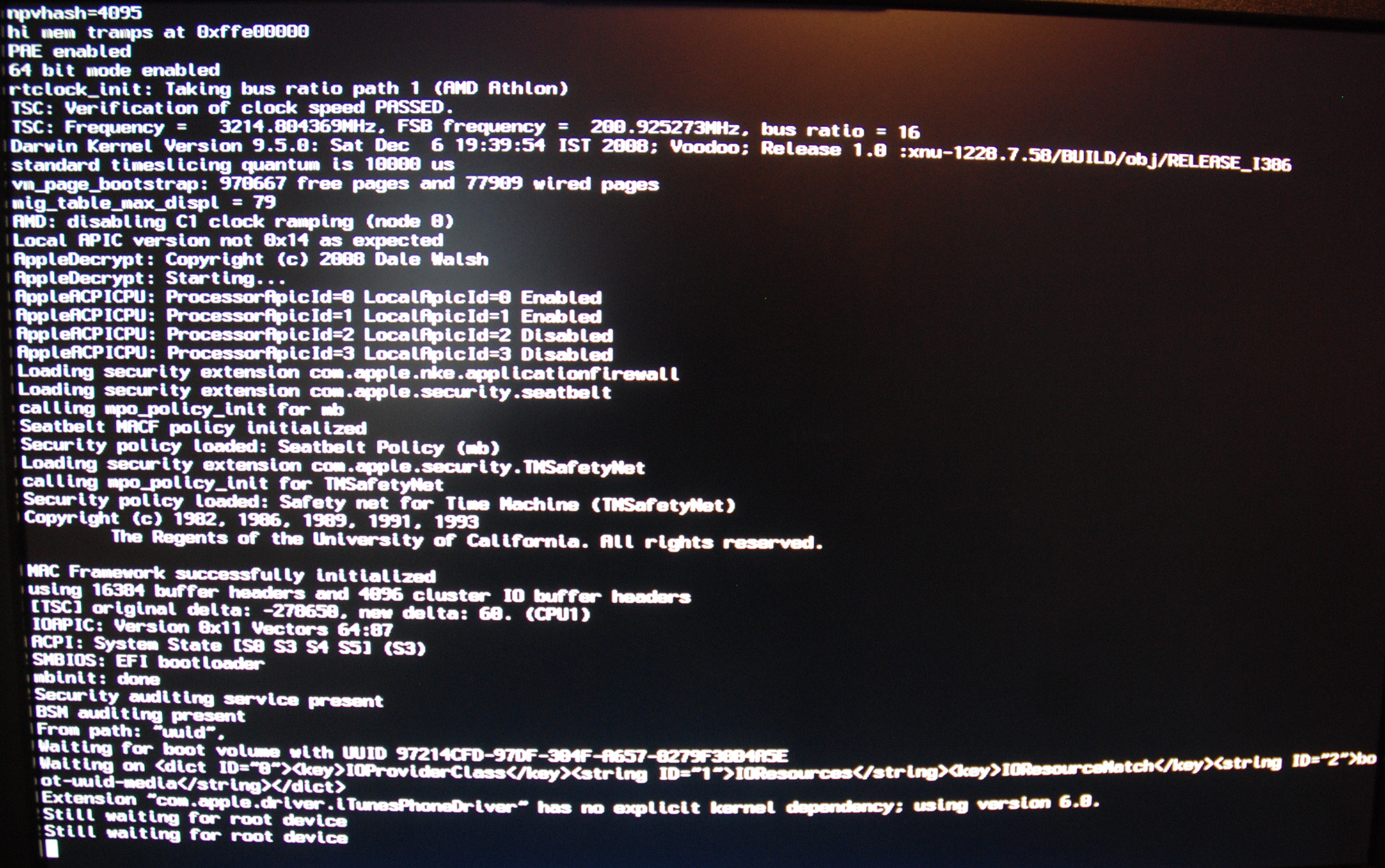

Yes I tried your modified nforceata but like I said, it made my computer not boot
I get the "still waiting for root device" problem
Try my modified kext again. But this time, boot with -v -f and then take a photo of the screen to see why the kext is not loading or failing.

If i only add device id's then i won't make such a topic like this. I've modified the kexts in order to make them work with > 2gb of ram (64 bit memory addresses). MeDevil's test kext source never appeared, so i cannot patch that.
If the one i've modified works for you, then u should use that.

I tried the latest one and I got more or less the same results, lots of (debug?) mesages on system log, slow boot times and iokitwaitquiet messages and the same problem with cable detection:
Apr 29 09:18:12 localhost kernel[0]: AppleNForceATA: 80-conductor cable not detected
Apr 29 09:18:12 localhost kernel[0]: AppleNForceATA: selected Ultra mode 2
If I understand that right, 80-conductor cable detection is not working with my drive/board (its actually a UDMA4 drive on a 80-conductor cable) and the driver seems to default to PIO4/UDMA2 in that case, if thats a generic bug and not just happens for me, that can cause a serious performance hit on hard drives.
At least the drive is detected and working fine, I managed to test DVD writing and its also working 100% OK, considering you dont have the time nor the hardware to develop this any further, I must say its a great work, so thanks for the effort! :-)

If u can boot with another AppleNForceATA.kext, then check what's inside Info.plist and compare with the one I modified. They should be the same. If not, just make them be the same.
How exactly would I do that since I can't boot?
Good point. Not sure. In my case, I only needed to use the JMichron kext in this topic for fixing my 4Gb memory issue. The 'still waiting for root device' was fixed by another kext (see signature).
Any chance this device ID could be added to the kext? Adding it to the info.plist dosen't do enough, it just says it's unsupported. The device ID is '07f8'. It's for the SATA MCP73 chipset.
Check if you have other kexts loaded that could cause the kp panic, maybe something inside the IOATAFamily plugins you are using?
MCP73 supports AHCI mode, use that and you need no third party driver for the SATA (you still need it for the IDE ports).
I can't set ACHI in the motherboard, it's an OEM Gateway motherboard, that option is disabled.
Alrighty
I coppied the contents of the original nforceata plist to your modified one, saved it, and then fixed permissions and deleted extensions mkext. Now it boots. I ran remember with all 4 gigs and no kp. This issue appears to now be resolved. Thank you very much slashack and others for the help.
minor note: my computer will only boot with -f flag
any idea why?
