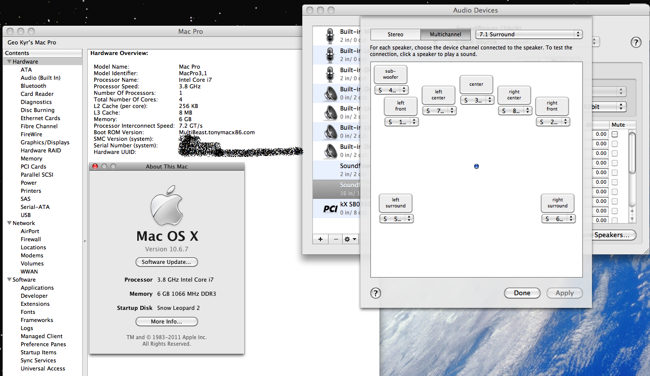

Odd, I think I'm getting the rear 2 channels when I have a 5.1 source. I don't have any problems when listening to anything in stereo. My 2.0 speakers are definitely hooked up to the correct output. I've tried the other outputs as well, but they didn't give me any sound at all. Any ideas? :unsure:
10.5.8
Gigabyte EP35-DS3L
Sound Blaster Audigy 2 (SB0240)
