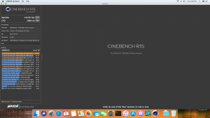

Philterino Posted September 22, 2017 Share Posted September 22, 2017 Enabling CPU EIST in bios seemed to give me a big performance jump.... I had voodoo set to 19 and had built a custom ssdt... but I will try yours to see if it's better. Thanks! I'm getting about 30k on geekbench and 2300 on cinebenvh. Which is close to my windows score. 2 Link to comment Share on other sites More sharing options...
surfinchina Posted September 28, 2017 Author Share Posted September 28, 2017 Enabling CPU EIST in bios seemed to give me a big performance jump.... I had voodoo set to 19 and had built a custom ssdt... but I will try yours to see if it's better. Thanks! I'm getting about 30k on geekbench and 2300 on cinebenvh. Which is close to my windows score. I tried the EIST and you're right! I'm still getting the speedsteps and the computer is a lot faster. Temps have gone up from mid 80s to low 100s in cinebench though. Here we were just carrying on with the old X99 conventions without sufficient testing... Nice find! 1 Link to comment Share on other sites More sharing options...

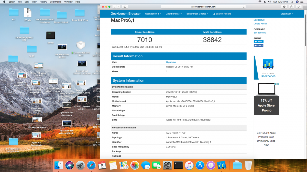

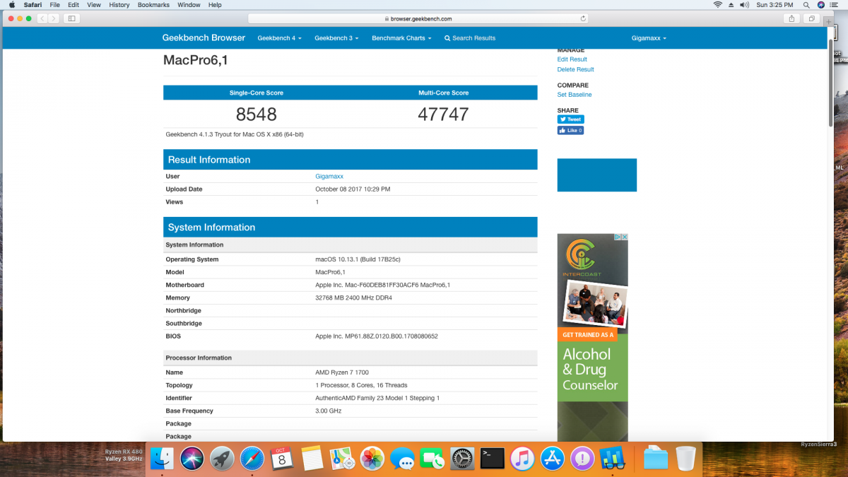

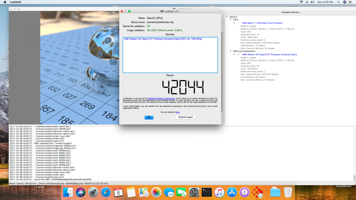

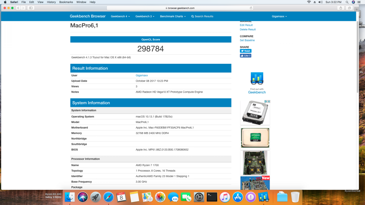

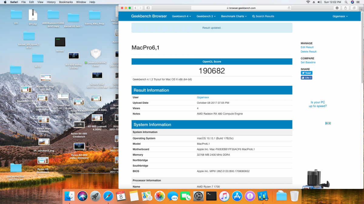

Gigamaxx Posted October 8, 2017 Share Posted October 8, 2017 Off topic here but I have stumbled onto a sudo overclock for my Ryzen 7 1700 Vega 64 system. Although the drivers for Vega are not quite there yet the RX 480 is kicking some serious booteeh! I bet I can top your Luxmark and Geekbenches with it. looky here! It thinks its running at 4.9GHz. 1 Link to comment Share on other sites More sharing options...
PunkNugget Posted October 8, 2017 Share Posted October 8, 2017 Off topic here but I have stumbled onto a sudo overclock for my Ryzen 7 1700 Vega 64 system. Although the drivers for Vega are not quite there yet the RX 480 is kicking some serious booteeh! I bet I can top your Luxmark and Geekbenches with it. looky here! It thinks its running at 4.9GHz. Although I do appreciate your enthusiasm, I was able to beat that score a few months ago with a multicore GB score of 59,104 using Dual 2697 v2 CPUs. In fact, there are others on here that reached a little over 50,000 with one i9 7900X CPU. I haven’t tried the other tests yet, but once I get my system going again (which hopefully will be within the next week), I will reveal the newest GB scores. Thanks for your post. Link to comment Share on other sites More sharing options...

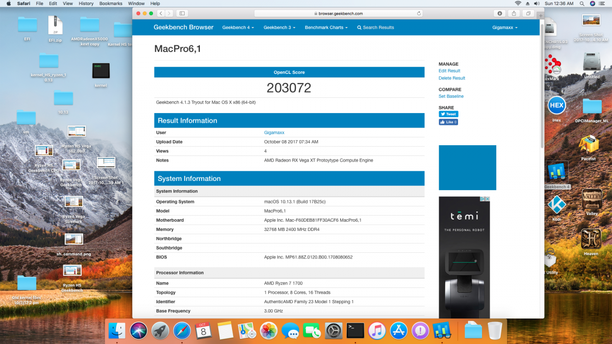

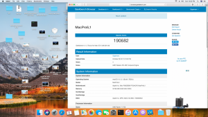

surfinchina Posted October 9, 2017 Author Share Posted October 9, 2017 Off topic here but I have stumbled onto a sudo overclock for my Ryzen 7 1700 Vega 64 system. Although the drivers for Vega are not quite there yet the RX 480 is kicking some serious booteeh! I bet I can top your Luxmark and Geekbenches with it. looky here! It thinks its running at 4.9GHz. You may have. I can't get much more than 160000 for my vega and I'm pretty sure geekbench GPU scores aren't affected by CPU, so how did you get 200000 on your vega? Link to comment Share on other sites More sharing options...

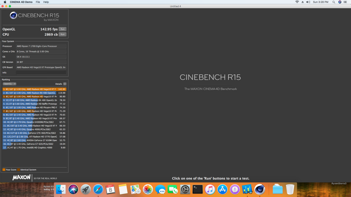

Gigamaxx Posted October 9, 2017 Share Posted October 9, 2017 You may have. I can't get much more than 160000 for my vega and I'm pretty sure geekbench GPU scores aren't affected by CPU, so how did you get 200000 on your vega? Its a mystery for now but if we configure it out it could be a sudo overclocking method. There are skeptics but it seems to grade perfectly. The frequency (sudo) shows up in Uningine openGl app. Check these out, sudo 6.0Ghz. set in clover. If I set to 3.0Ghz I get the normal sub par 160,000 scores, as I scale up the benches follow. My Vega run on 30bit color in Uningine no problem just need to disable AA. Punknugget check out my Lux Vega 64 single card score. You may have. I can't get much more than 160000 for my vega and I'm pretty sure geekbench GPU scores aren't affected by CPU, so how did you get 200000 on your vega? Its a mystery for now but if we configure it out it could be a sudo overclocking method. There are skeptics but it seems to grade perfectly. The frequency (sudo) shows up in Uningine openGl app. Check these out, sudo 6.0Ghz. set in clover. If I set to 3.0Ghz I get the normal sub par 160,000 scores, as I scale up the benches follow. My Vega run on 30bit color in Uningine no problem just need to disable AA. Punknugget check out my Lux Vega 64 single card score. Link to comment Share on other sites More sharing options...
PunkNugget Posted October 9, 2017 Share Posted October 9, 2017 Punknugget check out my Lux Vega 64 single card score. Once I get my system up and running I'll have to run my LuxMark Test and see what score results show. Thanks for sharing... Link to comment Share on other sites More sharing options...

surfinchina Posted October 9, 2017 Author Share Posted October 9, 2017 Its a mystery for now but if we configure it out it could be a sudo overclocking method. There are skeptics but it seems to grade perfectly. The frequency (sudo) shows up in Uningine openGl app. Check these out, sudo 6.0Ghz. set in clover. If I set to 3.0Ghz I get the normal sub par 160,000 scores, as I scale up the benches follow. My Vega run on 30bit color in Uningine no problem just need to disable AA. Punknugget check out my Lux Vega 64 single card score. Its a mystery for now but if we configure it out it could be a sudo overclocking method. There are skeptics but it seems to grade perfectly. The frequency (sudo) shows up in Uningine openGl app. Check these out, sudo 6.0Ghz. set in clover. If I set to 3.0Ghz I get the normal sub par 160,000 scores, as I scale up the benches follow. My Vega run on 30bit color in Uningine no problem just need to disable AA. Punknugget check out my Lux Vega 64 single card score. Is it possible to attach your config.plist? If that's where you made the changes Link to comment Share on other sites More sharing options...

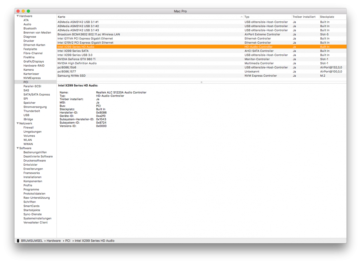

apfelnico Posted October 10, 2017 Share Posted October 10, 2017 Any luck with getting 1220 audio to work on the X299 platform without the use of VoodooHDA? Of course that is possible (Lilu+AppleALC+DSDT/SSDT): 1 Link to comment Share on other sites More sharing options...
unknown1221 Posted October 10, 2017 Share Posted October 10, 2017 Of course that is possible (Lilu+AppleALC+DSDT/SSDT): That is excellent news. Could you please share how you did that? I notice that 1.14 version of AppleALC doesn't have X299 patches only X99 ones I already have the CAVS to HDEF SSDT which makes HDEF show in IOReg, what other SSDTs or patches do I need? My Codec is the Asus 1120 variant which is the 1120A Could you please share your EFI folder Link to comment Share on other sites More sharing options...
apfelnico Posted October 10, 2017 Share Posted October 10, 2017 No special AppleALC patches are required. • CAVS -> HDEF is the first step (Clover ACPI patch (or directly in the DSDT)) • The second is is a big change: PC00 -> PCI0 (and PC01->PCI1 and so on) • And now set the layout ID to "7" • optional you can describe the device "HDEF" with a "_DSM method" Link to comment Share on other sites More sharing options...
send2moran Posted October 10, 2017 Share Posted October 10, 2017 No special AppleALC patches are required. • CAVS -> HDEF is the first step (Clover ACPI patch (or directly in the DSDT)) • The second is is a big change: PC00 -> PCI0 (and PC01->PCI1 and so on) • And now set the layout ID to "7" • optional you can describe the device "HDEF" with a "_DSM method" hey, can you explain how to change layout ID to "7" ? Link to comment Share on other sites More sharing options...
maleorderbride Posted October 11, 2017 Share Posted October 11, 2017 Is it possible to attach your config.plist? If that's where you made the changes I don't think it is real performance. Geekbench is partially a synthetic benchmark that takes some system values at face value instead of actually testing for performance. I am sure that if Gigamaxx and you compare Luxmark and Cinebench scores then there will be no discrepancy. Link to comment Share on other sites More sharing options...

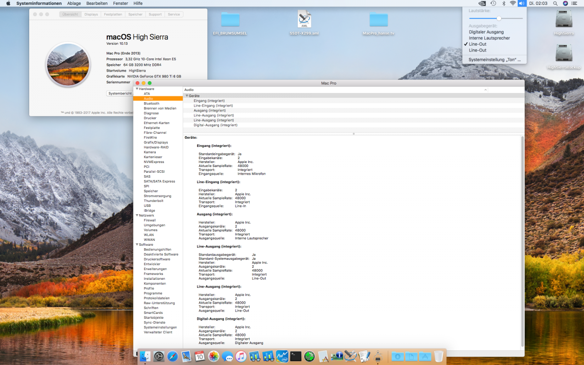

Sasha Medovarski Posted November 11, 2017 Share Posted November 11, 2017 I need little help. I instaled 10.13.1 on my custom machine: gigabyte X299 aorus gaming 3, i7 7820X, GTX 980Ti. I used clover from first page of this post. Problem is: when I played video without audio, works fine. When I played audio file, works. fine. When I played video with audio, machine crashes. Any idea? Link to comment Share on other sites More sharing options...
maleorderbride Posted November 11, 2017 Share Posted November 11, 2017 I need little help. I instaled 10.13.1 on my custom machine: gigabyte X299 aorus gaming 3, i7 7820X, GTX 980Ti. I used clover from first page of this post. Problem is: when I played video without audio, works fine. When I played audio file, works. fine. When I played video with audio, machine crashes. Any idea? Do you have the onboard audio working? Is your CPU at stock speeds? 1 Link to comment Share on other sites More sharing options...
