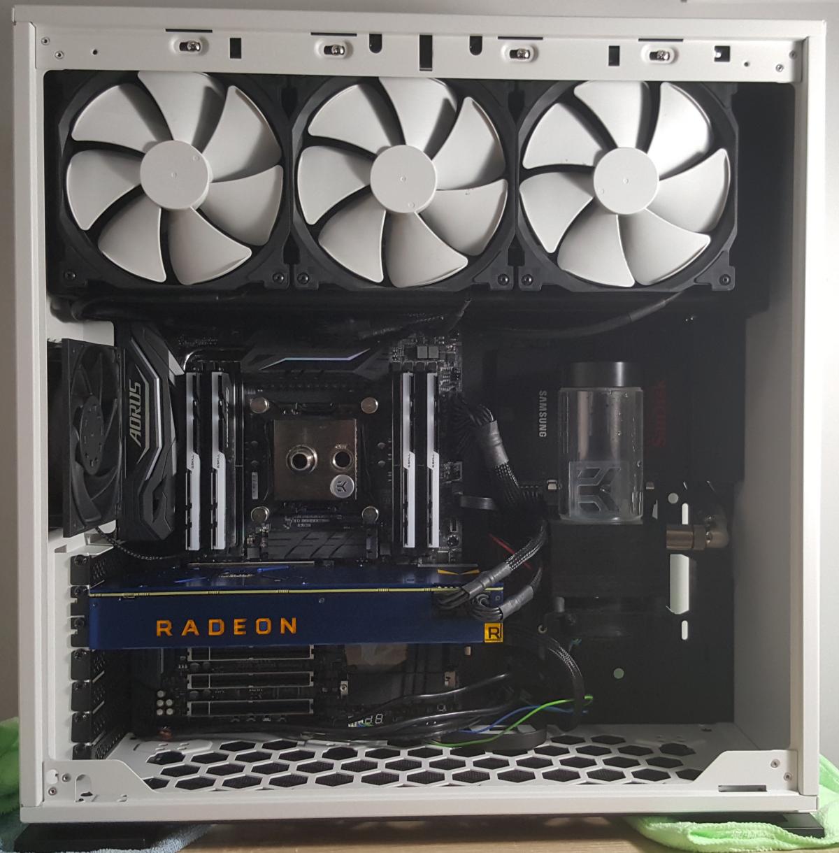

X299 HackinCAD specs:
Gigabyte X299 Aorus Gaming 9
i9-7900x
Radeon Vega Frontier Edition
Samsung NVME 960 evo (1tb) and backup Samsung 850 evo (1tb) SSD
32Gb 4x8gb Gskill DDR4 RGB (colourful!)
EKWB 420 + 360 rad for cooling (which is really necessary for this CPU)

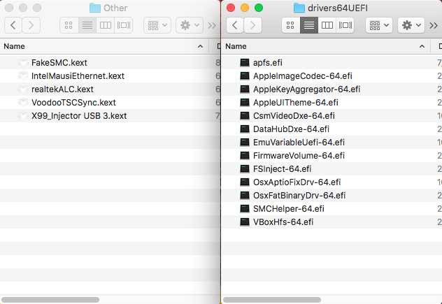

On my X99 hack I copied the whole EFI onto the most current Clover bootloader EFI. I pretty well stripped out the kexts and patches from that EFI and made a new and vanilla High Sierra install.
Things to watch -
Something on my previous HS install was borking it, possibly some modified kexts in S/L/E to do with my Nano, hence the new install. I used migration assistant after that, so all good.
HWSensors in the plugins folder in FakeSMC was causing kp, had to remove.

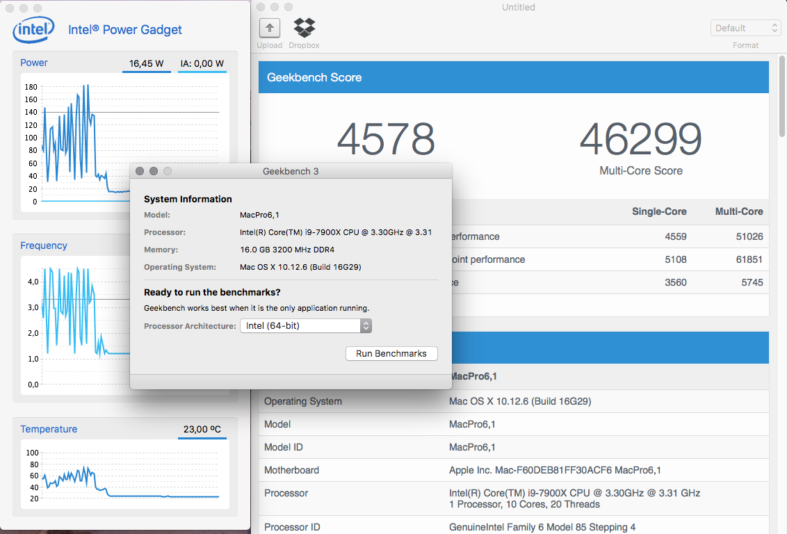

Still no Power management. The i9-7900 is sitting on full noise, using 140 watts and 60 deg even with my loop!
I'm working on this but as I've pointed out, I'm not very technical, just stubborn.
It's winter here and the CPU is warming my entire office, so it's not all bad.
I have to use the normal heater now. Full speedstep working! Thanks again fabiosun :)
The vega worked oob. I have nothing flagged or ticked. Boot screen is good, clover menu good. No boot to black or helper or igpu. BUT! It's less than half as fast in Cinebench as my old Nano. I'm hoping it'll get better as the drivers mature.
My only boot flags are -V and npci=0x2000.

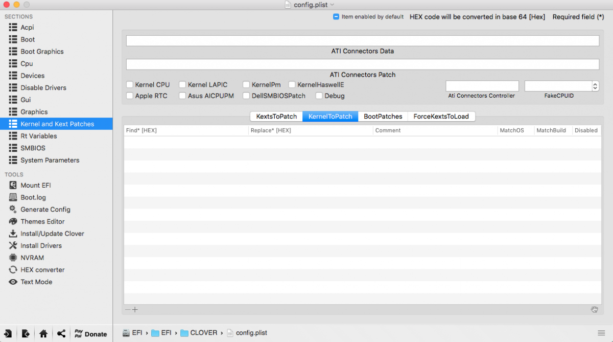

Note 1: Some of the patches, efis and kexts might not be needed, I haven't tested them all yet.
Note 2: Kernel patches to do with power management didn't work and can be removed.
Note 3: I've since changed back to Mac Pro 6,1 with no issues.
Since updated the SMBIOS to iMac 19,1 - you'll see it in the clover attachment.
I've removed ALL of the kext and kernel patches and some of the kexts.
Next up I'll do an overclock, now that idle has gone from 61 to 21 degrees.
edit: head on over to guides to see my "How to overclock the skylake x" now running at 4.8Ghz
http://www.insanelymac.com/forum/topic/327056-guide-how-to-overclock-your-skylake-x/
After that I'll test the drivers.
edit: drivers pruned down, still no patches and now no speedstep kext, still have 10 speedsteps. Check in the clover attachment for kexts and drivers.

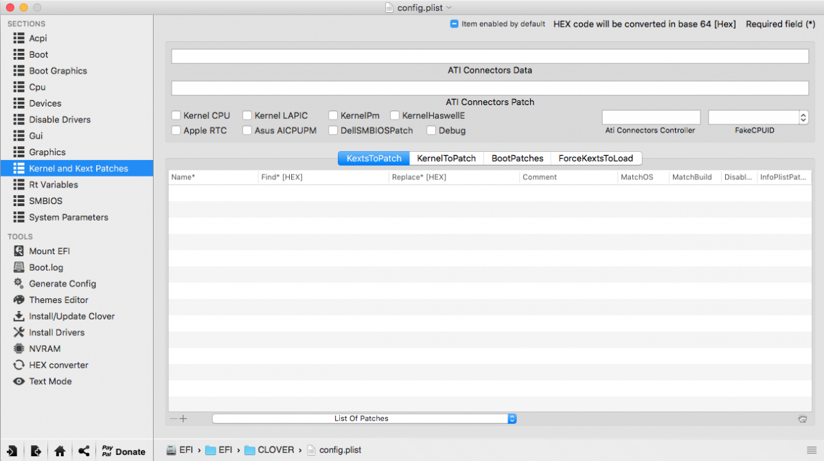

Hi surfinchina
in this attachment you have some work to do:
you have two performance fix kernel patches and you have to investigate for the latest 5 if they are all necessary to you to boot
Performance fix in x99 system is useful only if you have eist enabled in bios
This fix helps to reach higher performance but you loose some lower steps for your cpu

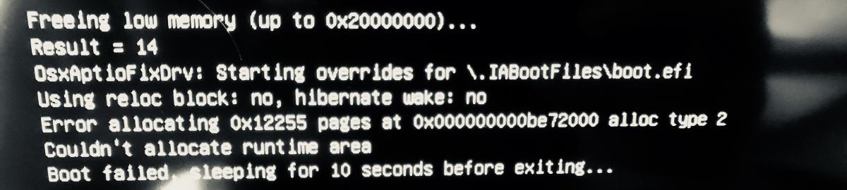

Any idea how to fix this? Could you maybe upload your full efi Folder ?
Yes, @surfinchina, your EFI folder please!
Many thanks in advance!

I now have full speedstep!
Following fabiosun's advice I removed patches - all of them actually, checked C states in clover (I don't know if this is necessary.
I also have all USB ports without patches and HDMI sound. No onboard sound but I don't use that (have a USB DAC).
edited my instructions at top and added attachment - my clover
Wait though. I'm getting a logoff and once even a freeze when I do certain things on my browser - Chrome.
Which patch fixed this on my old list...  Any ideas?

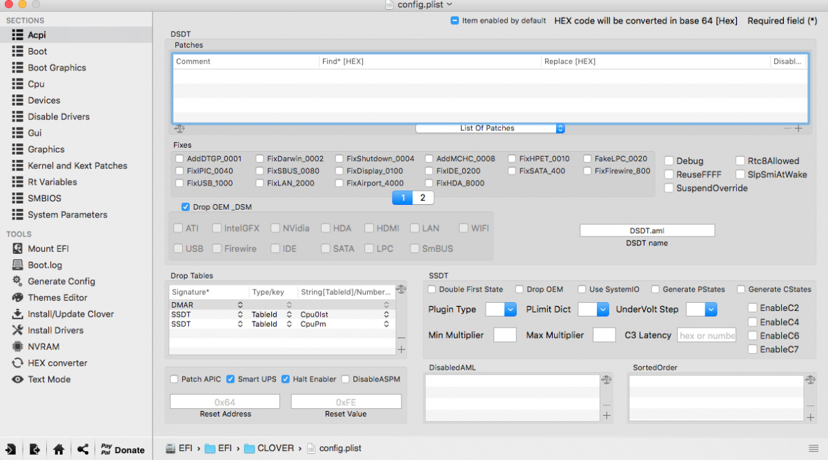

Hi
I see your clover folder in other post you did..it is full of config.plist files
To be sure of what you are really using you have to start only with one config.plist in your system..and maybe with only an efi partition...
In my experience with some clover version it can be a problem

Hi fabio,
It's a habit that I backup the plist when I make changes. That way I can revert to the backup one in clover / configs.
I don't understand maybe only an efi partition? :P
One problem I'm having since I deleted all patches is that sometimes it'll hang or logout when I do certain things in Chrome browser... Today's job is to fix that...

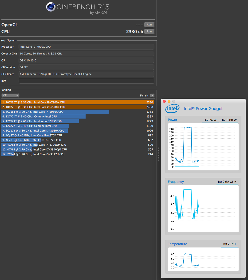

I like to use cinebench to benchmark because my CAD software uses cinerender.

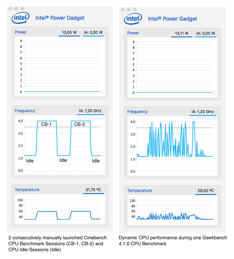

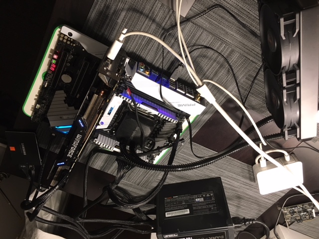

First test setup, nothing optimized, but it runs ...

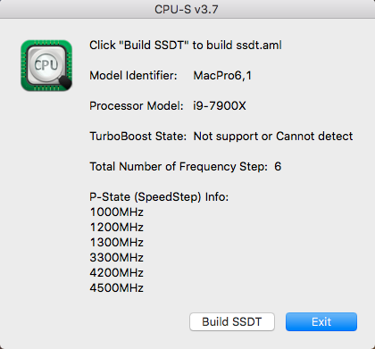

Which mobo do you use?? An did you configure XCPM (ssdt.aml) to have these nice Idle frequencies?

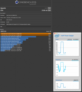

Hi surfinchina
Hi hope IPG power value are not real at all...above 240 Watt ....If I don't mind your cpu has a TDP of about 140...
It should be however an IPG problem..if not your cpu should be very powerful...and hot! :-)
Share this post
1. ASUS PRIME X299 DELUXE
2. Nope. I use the "PMDrvr.kext". Simple but effective.
Share this post
Link to post
Anyway the important answers is  ASUS PRIME X299 DELUXE! clean idle and max. load frequencies! In any case on the ASUS PRIME X299 DELUXE PMDrvr.kext is obsolete! Same results without xcpm kerneltopatch entries but ssdt.aml in EFI. The ASUS PRIME X299 DELUXE is amazing and I returned it because of this promising but misleading thread!  :(

Hi Fabio,
The IPG power is real, tests on windows as well. These things can pull 400! Even at stock they're doing 250, so you really need a lot of cooling.
My overclock of 4.8 is probably too high even at just 1.25 volts it gets to 85deg which I don't like so much.
