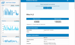

apfelnico Posted August 28, 2017 Share Posted August 28, 2017 Asus Prime X299 Deluxe It's moving forward ... 1 Link to comment Share on other sites More sharing options...

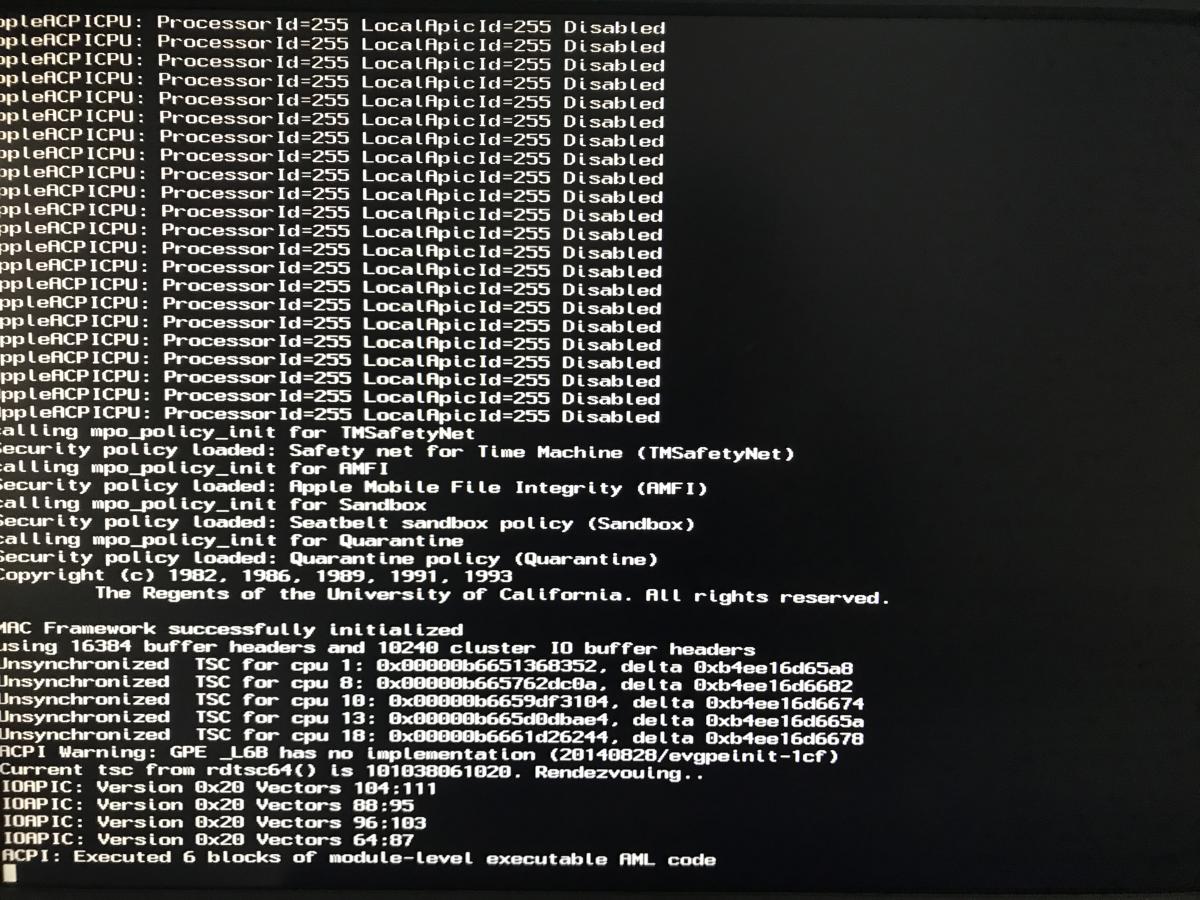

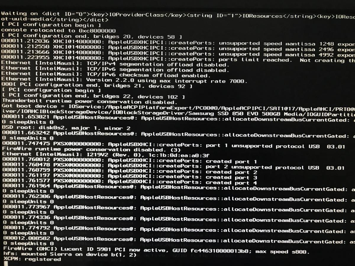

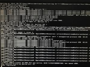

MacDavePro Posted August 31, 2017 Share Posted August 31, 2017 Asus Prime X299 Deluxe It's moving forward ... Tag Apfelnico, Was this a clean install or did you transfer an existing Sierra install to your new X299 and upgrade? I can't get past +++++++++++++++++ on a clean install of HS DP7 to my 7900X / X299 Deluxe / Samsung 960 Evo. Using mobo firmware 0031 (special hack by Raja) because my X299 Deluxe wont even POST using 0503 or 0702. Any help would be much appreciated. Dave Link to comment Share on other sites More sharing options...
joedm ru Posted September 2, 2017 Share Posted September 2, 2017 Same for me, can't get over +++++++ using Sierra flash drive. Link to comment Share on other sites More sharing options...
surfinchina Posted September 3, 2017 Author Share Posted September 3, 2017 Tag Apfelnico, Was this a clean install or did you transfer an existing Sierra install to your new X299 and upgrade? I can't get past +++++++++++++++++ on a clean install of HS DP7 to my 7900X / X299 Deluxe / Samsung 960 Evo. Using mobo firmware 0031 (special hack by Raja) because my X299 Deluxe wont even POST using 0503 or 0702. Any help would be much appreciated. Dave Same for me, can't get over +++++++ using Sierra flash drive. Have you tried putting the apfs. efi in drivers64UEFI? Link to comment Share on other sites More sharing options...
Philterino Posted September 3, 2017 Share Posted September 3, 2017 I couldn't boot installer from USB either so used my MacBook to install a copy on to a clean SSD in a caddy then I used (the beast of which we must not speak) then cloverconfgurator with Surfchinas earlier EFI as a base... just had to change from Amd to nvidia graphics. First boot with nv_disable =1 then use nvidiafixup kext Once web drivers are installed. Will attach a proper file later as I'm just on my phone but here's a drop box link to my booting EFI https://www.dropbox.com/sh/nngfpp27t08jd1j/AAAFaYIFLcGGlAn3BVvQKdNTa?dl=0 1 Link to comment Share on other sites More sharing options...
surfinchina Posted September 3, 2017 Author Share Posted September 3, 2017 One little reminder, because I haven't mentioned it on this thread: Repair permissions. Every time you make a change, repair permissions. I just had the boot fail sleeping for 10 seconds thing, booted from my backup disk (I CCC to it every week), I repaired permissions on the main boot drive and now it's fine. Some utilities no longer work, the latest KCPM is fine with HS. 1 Link to comment Share on other sites More sharing options...
joedm ru Posted September 4, 2017 Share Posted September 4, 2017 Have you tried putting the apfs. efi in drivers64UEFI? Yes I did - just in case. Because I don't use APFS filesystem on my boot flash drive. Anyway, it didn't help. I use your clover config(slightly modified). The difference is that I'm using GA X299 Aorus Gaming 3 mb and I tried to install 10.12 instead of 10.13 beta. I'm going to wait for 10.13 to be released and then I'll get back here (hopefully with good news). Link to comment Share on other sites More sharing options...

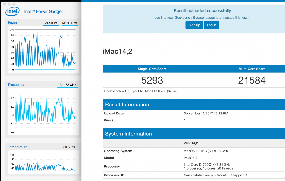

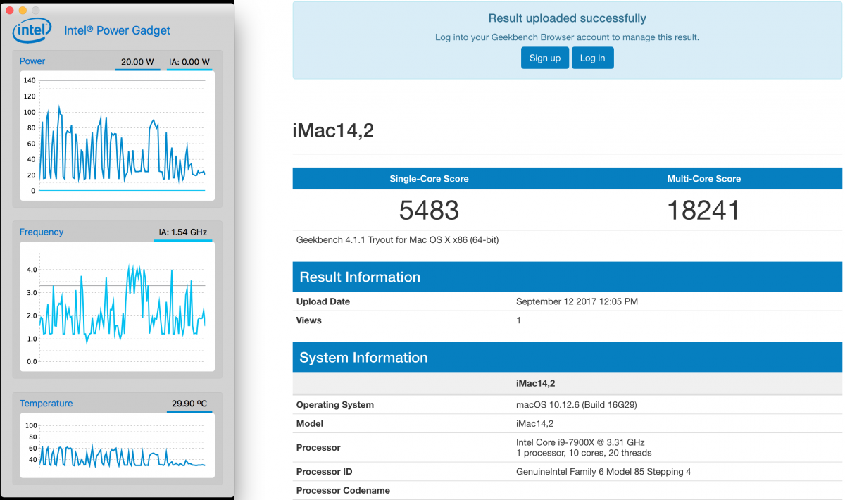

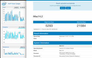

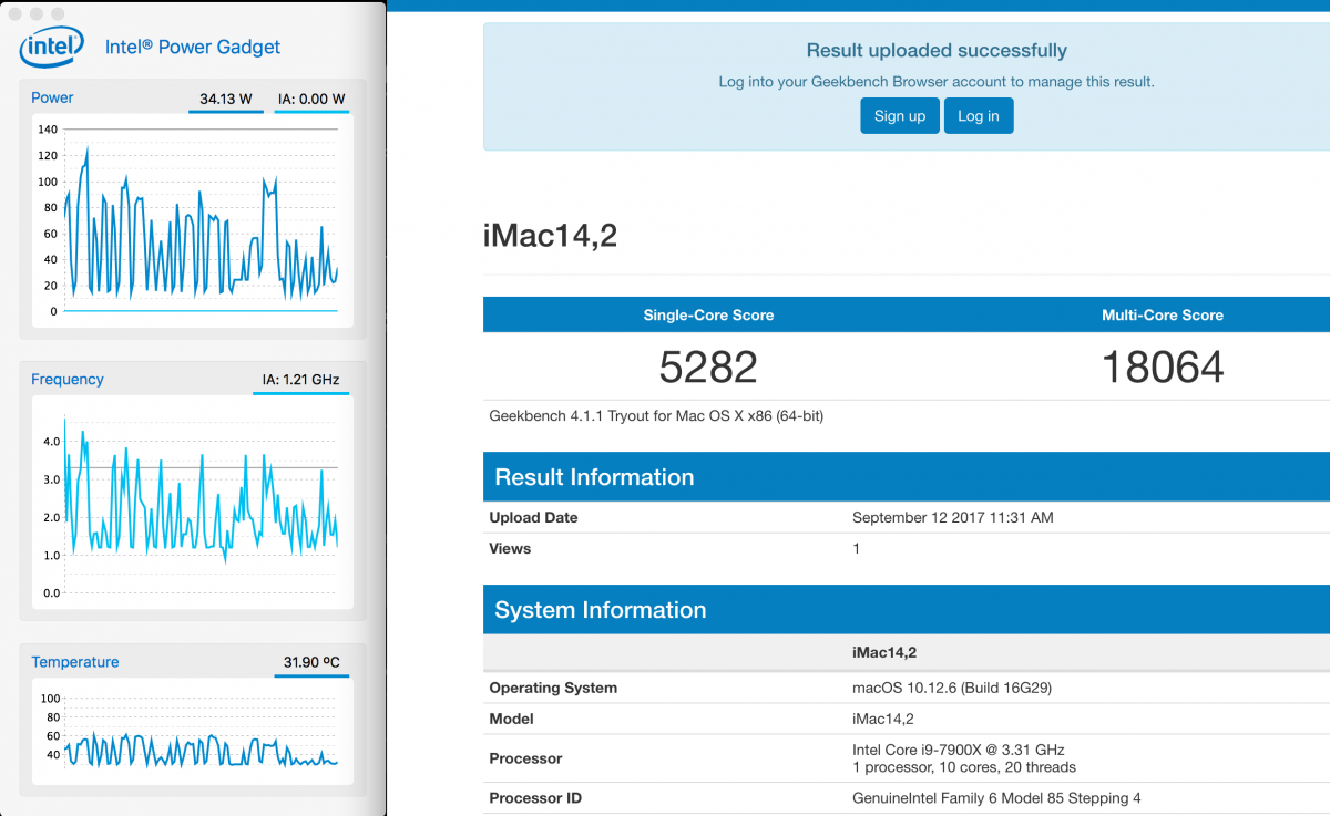

Philterino Posted September 12, 2017 Share Posted September 12, 2017 So i haven't made any progress on the power management but i was able to finally get my Alpine ridge thunderbolt card running.... took a clean install of windows and a lot of turning things on in th right way to get it to show up so i could update firmware... but once that happened it worked first time in Sierra... Winn... I now have my UA apollo back.. woo. So back to power management.... Ive Followed Surfchinas over clocking guide (well i added the relevant stuff in my BIOS)... and it didnt seem to make much differnce. Im still hovering around the 20k mark with Geek bench. Ive tried a whol bunch of stuff but it never gets anywhere near my score in windows... which seems about right. Im sure its something stupid im doing or not doing... as this is my first non standard hackintosh ive never had to deal with power management so i dont really know where to look. Ive attached a bunch of stuff including Various tests with different stuff on and off. Any help is very much appreciated. Link to comment Share on other sites More sharing options...

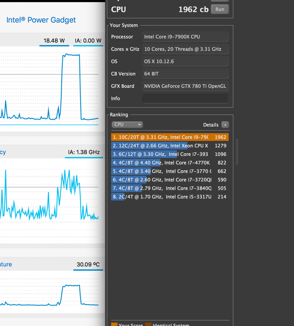

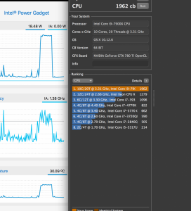

Philterino Posted September 12, 2017 Share Posted September 12, 2017 Took nullcpupowermanagement.kext out... similar results... i think it was in Surfchinas EFI which i used as a base Ive attached a cinebench too... which looks a bit better... but im getting 2500 on Windows. so still something up 1 Link to comment Share on other sites More sharing options...

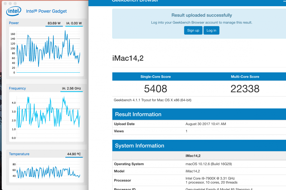

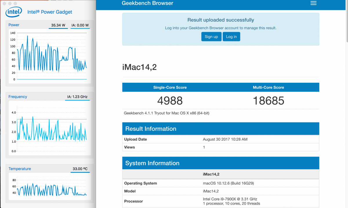

Gigamaxx Posted September 12, 2017 Share Posted September 12, 2017 in my rig I have in windows 3165 and in osx 2940 from cinebench test it seems you have a very poor performance in multiprocessing (and from your ipg graph in higher frequency clock is not stable @max values Nullcpu i think it is not usefull at all for new Osx and cpu What about clover ACPI folder could there be the original default dsdtaml files causing low performance? Link to comment Share on other sites More sharing options...
surfinchina Posted September 12, 2017 Author Share Posted September 12, 2017 Took nullcpupowermanagement.kext out... similar results... i think it was in Surfchinas EFI which i used as a base Ive attached a cinebench too... which looks a bit better... but im getting 2500 on Windows. so still something up Sorry about that, I took the nullcpupowermanagement.kext out ages ago and only just updated that EFI in the thread. I agree with gigamax and fabio, your cores aren't maxed out. It's possible your bios needs work, I got that kind of frequency signature and performance when I disabled speedstep. You can also try to set the turbo for each core at your max overclock. After you've removed all your SSDT and DSDT (if any) from patched, remember to hit F4 at the clover boot screen to update the origin folder. 1 Link to comment Share on other sites More sharing options...

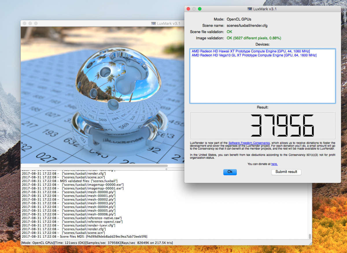

PunkNugget Posted September 14, 2017 Share Posted September 14, 2017 I used Aomei Partition assistant. When I had 2 GPU the only rendering benchmark that used them together was Luxmark. Screenshot 2017-08-31 17.22.24.png Okay, cool. I'll try that later tonight. And post my pics. Thanks. Link to comment Share on other sites More sharing options...
Gigamaxx Posted September 14, 2017 Share Posted September 14, 2017 Apple doesn't support crossfire, thats a Windows setup we can only use two cards for some openCl apps with the openGl apps like uningine, cinebench and general gaming apps only one card is utilized. It sucks, but its the apple way. Link to comment Share on other sites More sharing options...
