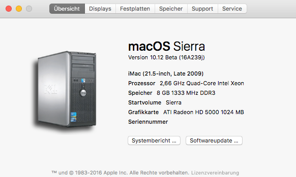

Attached File  dell_optiplex_780.png   192.97KB   681 downloads Attached File  dell_sierra.png   87.16KB   630 downloads Attached File  dell_sierra_gm.png   73.48KB   152 downloads Attached File  beta1_10_12_6.png   72.54KB   64 downloads
the Optiplex story:
10.10: http://www.insanelym...tiplex-780-760/
10.11: http://www.insanelym...60-755-790-990/
10.12: this guide
10.13: http://www.insanelym...tiplex-780-760/
Note: Sierra supports only CPUs with SSE4 support, example: my Q9400 or my Q8200 working with Sierra. Core2Duo E7200 / Core2Quad Q8200 or higher works as well. See CPU-X.app for your CPU !!! SMBIOS MacPro3,1 is no longer supported with Sierra. Change to iMac10,1 and generate Serial, MLB and board serial number! HD5450 works with Sierra without problems, GT610 not more works with Sierra!!!

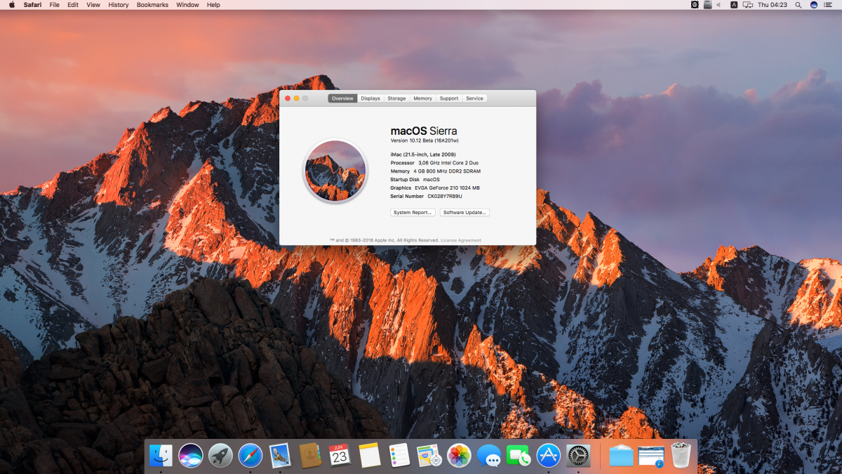

My EVGA Nvidia GT210: works with Inject Nvidia with Sierra, but no HDMI audio possible

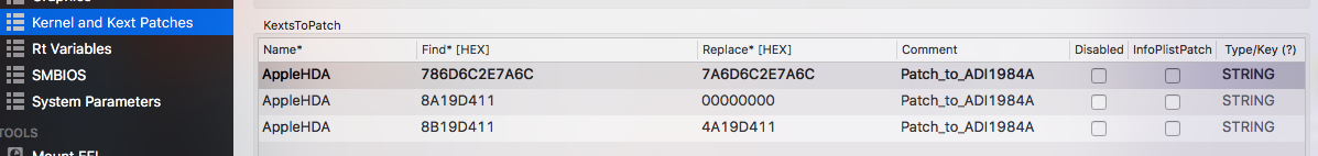

here is on the fly Package: http://www.insanelym...1012-sierrazip/
(AppleHDA+realtekALC+patch)
Install this AppleHDA and rebuild Cache (SIP 0x67)
copy realtekALC to Clovers kexts 10.12
and this for config.plist:
Attached File  patch.png   92.13KB   547 downloads
Here new value at Sierra:
8319D411 to 00000000 was at Capitan
now at Sierra 8A19D411 to 00000000
CloverConfigurator 4.27 works with Sierra (4.28/4.29 not)

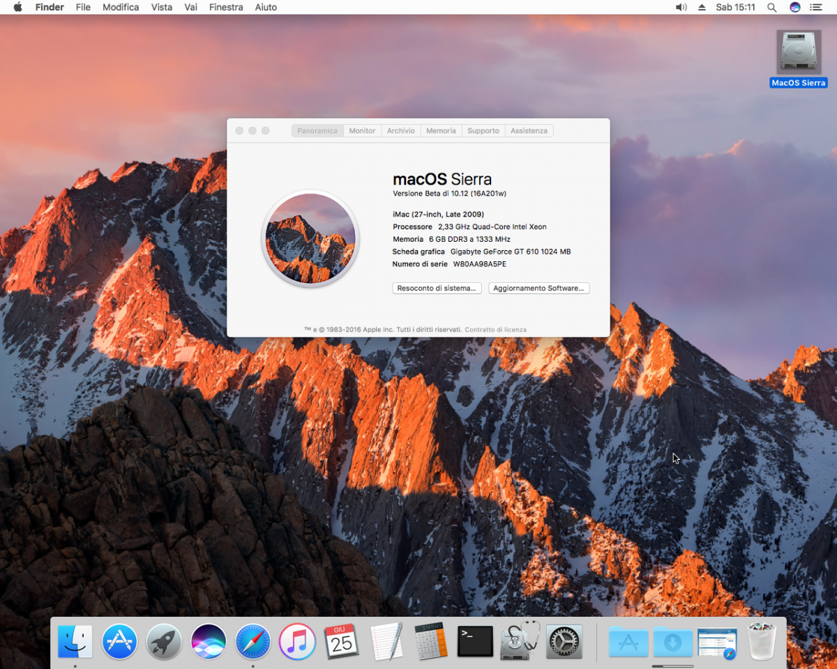

Nothing solution for GT-610? I have installed with nv_disable=1 in config.plist and work, but without acceleration.

GT610 is not working with Sierra.

my GT610 also does not work with Sierra, we hope to DP2
I removed all nvidia and geforce kext and replaced with nvidia and geforce kext from El Capitan 10.11.5 and system boot without nv_disable=1 and i have all resolution for mine 1680x1050, only problem now is acceleration

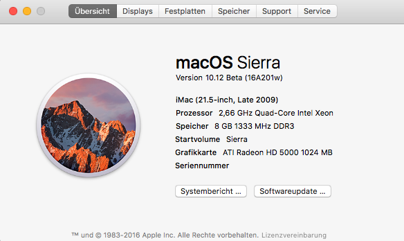

Public Beta is probably the DP2
with Clover 3589 or later and instructions Post # 1 it should work

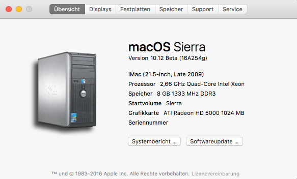

DP3 works without problems:
Attached File  dell_sierra_dp3.png   75.37KB   69 downloads
@Deanor30
no way for the GT610, will not work with DP1, DP2, DP3 and rollback not working. Webdriver not working.
GT610 is probably out.

Update macOS Sierra DP4 (16A270f) works without problems (my Clover is 3650)
Update macOS Sierra DP5 (16A286a) works (my Clover is 3650)
Attached File  dell_sierra_dp5.png   74.16KB   31 downloads
Update macOS Sierra DP7 (16A304a) works (my Clover is 3650)
