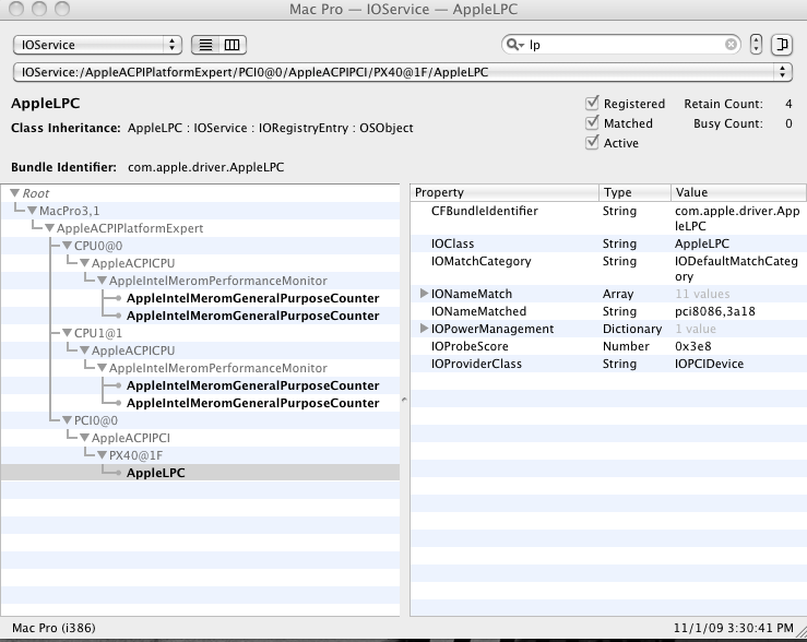

Ok with help from MM67, the lpc got loaded and aslo put cpu info from stell in the dsdt
no more error regarding Sms platform plugin CST, temps are down and sleep is still working
of course no speedstep at this point (i need to read more on this part)
Thnx for the help
