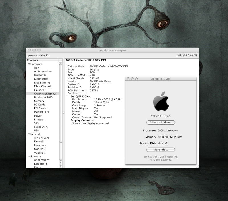

paratox Posted September 22, 2008 Share Posted September 22, 2008 chameleon efi & strings. the methode you posted in this thread. com.apple.Boot.plist is the same like befor update. sfx string works. gfx string should also work, in the attachment you can see the model name and 512mb. this wouldn`t appear whithout a working string. Link to comment https://www.insanelymac.com/forum/topic/98666-9800-gtx-working-in-osx86/page/12/#findComment-901675 Share on other sites More sharing options...

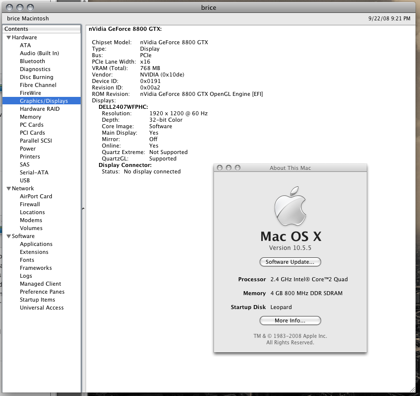

i4get Posted September 22, 2008 Share Posted September 22, 2008 same issue here, no way to get QE/CI with my 8800GTX since I've updated to 10.5.5 and yeah, no injectors, proper GFX String, everything done correctly. edit: will try doing the update with the 600meg file this time instead of the 300mb one. Link to comment https://www.insanelymac.com/forum/topic/98666-9800-gtx-working-in-osx86/page/12/#findComment-901695 Share on other sites More sharing options...
paratox Posted September 22, 2008 Share Posted September 22, 2008 same issue here, no way to get QE/CI with my 8800GTX since I've updated to 10.5.5and yeah, no injectors, proper GFX String, everything done correctly. edit: will try doing the update with the 600meg file this time instead of the 300mb one. i`ve also did the update with the 600mb combo update. i think this is not the solution. i don`t want to do a fresh install. Link to comment https://www.insanelymac.com/forum/topic/98666-9800-gtx-working-in-osx86/page/12/#findComment-901727 Share on other sites More sharing options...

paratox Posted September 28, 2008 Share Posted September 28, 2008 i got QE/CI working! yeah! i got QE/CI working! but not with this update methode. the methode i choosed worked for my hardware, so don`t think this would be the solution for everyone with lost QE/CI! what i did: -kalyway 10.5.2 install -leopard graphics update -chameleon and my old backuped boot.plist with efi strings for audio and gfx -aqua-macs kexts (only needed specialy for my graphic card, look at sig wich one) -mysticus 10.5.3 update, after install desktop won`t appear whithout installing aqua-macs kexts again -10.5.4 update from apple -10.5.5 update 316mb, not the combo!!! installed manualy by netkas methode -reverted to audio and network kexts from 10.5.4, installed some kexts for specialy my mainboard from this post -shutdown fix (can`t find link, but it`s somewhere here in the forum posted) essentialy for me was to do not the combo update and to do it with the netkas methode to get QE/CI working. all other methodes i found in this forum didn`t work for my system/hardware. @mysticus: although your methode did not work for me i want to say thank you for the time you tried to help me! what is working: -QE/CI -audio -network -sleep -restart/reboot -shutdown what doesn`t work: -shutdown after sleep the only strange thing is that my model name/identifier is now "iMac7,1". other modified smbios with macpro hardcoded did not change this. but hey, this is only a aesthetic problem.^^ Link to comment https://www.insanelymac.com/forum/topic/98666-9800-gtx-working-in-osx86/page/12/#findComment-908894 Share on other sites More sharing options...

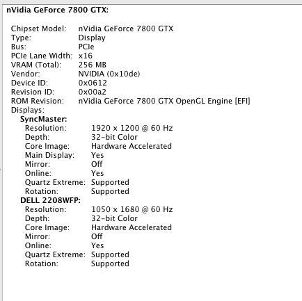

kai920 Posted September 28, 2008 Share Posted September 28, 2008 OK, I got my Inno3D 9800GTX+. I just took out the 7800GTX and put it in and to my surprise I can still boot into Mac OS X just fine - it just recognizes it as a 7800GTX. My question: Do I risk damage to my card by leaving it like this? What other disadvantages are there to leaving it as is - I assume I wouldn't get the full 3D speed benefits, but if I don't play any games in OS X I wouldn't be missing too much, correct? Just don't want to risk a perfectly working 10.5.5 installation in order to upgrade the video drivers Link to comment https://www.insanelymac.com/forum/topic/98666-9800-gtx-working-in-osx86/page/12/#findComment-909473 Share on other sites More sharing options...
