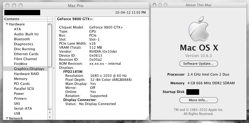

So?Crates Posted April 13, 2010 Share Posted April 13, 2010 I wasn't sure where to post this, but thought it signifigant news for anyone looking for an easy to install solution to a high end video card. I picked up the EVGA 9800 GTX+ today. It does NOT work with 10.6 or 10.6.1. In order to install the base OS, I used an OS X disc and Kakewalk on a 45-UD3L mobo. I then updated the OS to 10.6.3 and crossed my fingers that Apple's own updated graphics support files might do the trick. I powered down, plugged in the card, and it came right up! I've got full support right now for everything as far as I can tell/test for, and everything is really snappy. No DSDT editing, no funky kext updating. Enjoy! Got my 9800 GTX 512 Working in OSX 86 Leopard only! Download these Kexts: WITH 10.5.3 THERE IS NO NEED TO DOWNLOAD THE KEXTS BELOW! http://rapidshare.com/files/106584355/aquamac.zip.html and this version of NVInject: Click Here You need to swap these kexts into your Extensions folder. You may need to delete the original kexts as opposed to just replacing first on some of them. You must then run this permissions repair script -See Below: Let it run till finished, it takes a while. Then Delete the Extensions.mkext and reboot. You will regain your translucent menubar your drop down menus. EDIT: Dashboard now works correctly! The card is currently using the 8600 GTS open GL Engine but this does not hurt performance. We will probably have to wait for 10.5.3 for that to be fixed. Link to comment https://www.insanelymac.com/forum/topic/98666-9800-gtx-working-in-osx86/page/21/#findComment-1447311 Share on other sites More sharing options...

Beerkex'd Posted April 14, 2010 Share Posted April 14, 2010 You can use NVEnabler, ATY_Init or Chameleon 2.0's GraphicsEnabler. All three work with the 9800 GTX+ in Snow Leopard. You still need to manually add your device ID to NVDAResman.kext for full support though. Device ID of my 9800 GTX+ is 0612. If yours has a different ID you'll probably have to add it to NVDANV50Hal.kext as well. Link to comment https://www.insanelymac.com/forum/topic/98666-9800-gtx-working-in-osx86/page/21/#findComment-1448056 Share on other sites More sharing options...

So?Crates Posted April 17, 2010 Share Posted April 17, 2010 You can use NVEnabler, ATY_Init or Chameleon 2.0's GraphicsEnabler. All three work with the 9800 GTX+ in Snow Leopard. You still need to manually add your device ID to NVDAResman.kext for full support though. Device ID of my 9800 GTX+ is 0612. If yours has a different ID you'll probably have to add it to NVDANV50Hal.kext as well. And apparently today is my day to look like a noob. I was so happy that the video worked OTB with 10.6.3, along with CL/QE, that I didn't bother to test the second DVI. The second DVI is really there so I can run this to my TV later on. After your post, decided to try out the dual monitor feature. No go. blanked out both monitors and I had to reboot. I've tried NVEnabler, as well as patching just the card id for Resman, and then also for Resman and the supporting file you mentioned. No go. Took my card back to the stone age at 1024x768. If you could, I'd be forever grateful if you could give me step by step instructions on how to activate the second DVI. Even more helpful if you could just pass along any patched files for the 9800 GTX+ Cheers Link to comment https://www.insanelymac.com/forum/topic/98666-9800-gtx-working-in-osx86/page/21/#findComment-1450192 Share on other sites More sharing options...
So?Crates Posted April 17, 2010 Share Posted April 17, 2010 And apparently today is my day to look like a noob. I was so happy that the video worked OTB with 10.6.3, along with CL/QE, that I didn't bother to test the second DVI. The second DVI is really there so I can run this to my TV later on. After your post, decided to try out the dual monitor feature. No go. blanked out both monitors and I had to reboot. I've tried NVEnabler, as well as patching just the card id for Resman, and then also for Resman and the supporting file you mentioned. No go. Took my card back to the stone age at 1024x768. If you could, I'd be forever grateful if you could give me step by step instructions on how to activate the second DVI. Even more helpful if you could just pass along any patched files for the 9800 GTX+ Cheers Maybe you've got a dif brand of the 9800 GTX+. EVGA site boards say the ID is 0613. When I plugged in 0612 it mucked things up. Link to comment https://www.insanelymac.com/forum/topic/98666-9800-gtx-working-in-osx86/page/21/#findComment-1450588 Share on other sites More sharing options...
So?Crates Posted April 19, 2010 Share Posted April 19, 2010 You can use NVEnabler, ATY_Init or Chameleon 2.0's GraphicsEnabler. All three work with the 9800 GTX+ in Snow Leopard. You still need to manually add your device ID to NVDAResman.kext for full support though. Device ID of my 9800 GTX+ is 0612. If yours has a different ID you'll probably have to add it to NVDANV50Hal.kext as well. In doing some research, it looks like the EVGA version is ID 0613. Here's how I proceeded... Istalled NVEnabler 64 - tried it on it's own. No change. With NV64 still in place, tried editing Resman and 50Hal. Here's what I did to Resman (and then similarly to 50Hal)... Source: <key>IOPCIPrimaryMatch</key> <string>0x011010de&0xfff8ffff 0x017010de&0xfff8ffff 0x017910de 0x018010de&0xfff8ffff 0x018810de 0x018910de 0x020010de&0xfff8ffff 0x025010de&0xfff8ffff 0x028010de&0xfff8ffff 0x030010de&0xfff8ffff 0x031010de&0xfff8ffff 0x031910de 0x034910de</string> Changed to: <key>IOPCIPrimaryMatch</key> <string>0x0613de</string> Reinstalled via Kext Helper. Rebuilt via Kext Utility. Ran Disk Utility after, just to be double sure. Reboot. Kernal Panic upon logging in. Please, what am I missing? Link to comment https://www.insanelymac.com/forum/topic/98666-9800-gtx-working-in-osx86/page/21/#findComment-1451303 Share on other sites More sharing options...
ronalith Posted April 19, 2010 Share Posted April 19, 2010 In doing some research, it looks like the EVGA version is ID 0613. Here's how I proceeded... Istalled NVEnabler 64 - tried it on it's own. No change. With NV64 still in place, tried editing Resman and 50Hal. Here's what I did to Resman (and then similarly to 50Hal)... Source: <key>IOPCIPrimaryMatch</key> <string>0x011010de&0xfff8ffff 0x017010de&0xfff8ffff 0x017910de 0x018010de&0xfff8ffff 0x018810de 0x018910de 0x020010de&0xfff8ffff 0x025010de&0xfff8ffff 0x028010de&0xfff8ffff 0x030010de&0xfff8ffff 0x031010de&0xfff8ffff 0x031910de 0x034910de</string> Changed to: <key>IOPCIPrimaryMatch</key> <string>0x0613de</string> Reinstalled via Kext Helper. Rebuilt via Kext Utility. Ran Disk Utility after, just to be double sure. Reboot. Kernal Panic upon logging in. Please, what am I missing? you're missing the vendor (nvidia): 10de I don't know what means &0xfff8ffff but I think is better to use it: <string>0x061310de&0xfff8ffff</string> On a personal note, I have tried this with a 9800gtx and haven't been able to make work CL/QE Link to comment https://www.insanelymac.com/forum/topic/98666-9800-gtx-working-in-osx86/page/21/#findComment-1451751 Share on other sites More sharing options...
