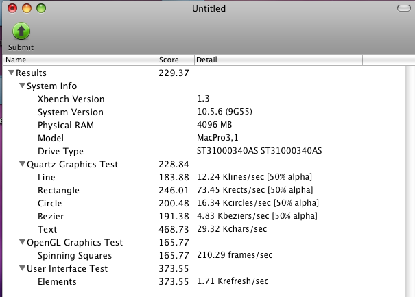

alexlyc Posted March 6, 2009 Share Posted March 6, 2009 What is the model of your 9800GTX? I have asus 9800GTX+ (512 mb) and have results that not differ from my preious card (palit 8800GT 512mb). I don`t understand why results from 9800 and 8800 are identifical What do you think about? Mine was a Evga 9800GTX. I am using a EVGA 9800GX2 now tho. 9800GTX+ and 8800GT both use the same G92 chip if I recall, I wouldn't be surprise they have similar benchmarks. Maybe try compare your old and new one at higher res like 1920x1200? I moved from 8800GT --> 8800GTS --> 9800GTX --> 9800GX2, base on my experience with wc3 on mac, they perform pretty much the same at 24" res. Link to comment Share on other sites More sharing options...

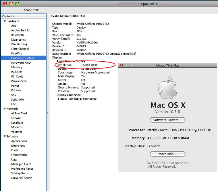

ThePerfectInstall Posted March 6, 2009 Share Posted March 6, 2009 My bad, I misname the plist file... Now I edited the com.apple.boot.plist file. I know it has taken effect because my grey apple loading screen is now at 1920x1200 resolution, but my QE is still not supported in system profiler and my dash board is still no good.Please tell me what I did wrong: 1. edited com.apple.boot.plist with the generated hex string 2. delete the old kexts 3. installed all the kexts and NVInject.kext from 1st page 4. repair disk permission command 5. delete Extensions.mkext 6. reboot To Aqua and anyone else who might know what my problem is thank you so much. I have followed the above and it's made zero difference (noticeable anyhow) I still have QE and Resolution, my problem is the blank white menus that you have to keep hitting escape click a million times and then memorize which pixel the item you want is on and then click in without seeing it. My Current HackPro Setup Kalyway 10.5.2 with pretty much generic settings, picked Nvinject 512 but I toasted them per instructions above. P5B (Or whatever it's called) PNY 512 9800GTX 30 Inch 2560x1600 Dell Quad Core Intel 2 Duo with 4 Gigs of ram @800Mhz This is my third card, I've been trying for some time. At first I had a 8500 Gt 1 gig of ram (512 showing) that was working fine but would always get a random kernel panic no matter how many perfect setups I had, then I got a 4870 but no matter what I tried nothing would work. Now I have the 9800GTX, I have been trying to register forever but the database has been messed up. Thank you so much if you can offer me some advice on what I"m doing wrong. THANK YOU!!! NVIDIA GeForce 9800 GTX DDL: Chipset Model: NVIDIA GeForce 9800 GTX DDL Type: Display Bus: PCIe PCIe Lane Width: x16 VRAM (Total): 512 MB Vendor: NVIDIA (0x10de) Device ID: 0x0613 Revision ID: 0x00a2 ROM Revision: 3172a Displays: DELL 3007WFP: Resolution: 2560 x 1600 Depth: 32-bit Color Core Image: Hardware Accelerated Main Display: Yes Mirror: Off Online: Yes Quartz Extreme: Supported Rotation: Supported Display Connector: Status: No display connected Link to comment Share on other sites More sharing options...
aqua-mac Posted March 6, 2009 Author Share Posted March 6, 2009 The perfect Install, You need to update from 10.5.2. Certainly you will not have this problem in 10.5.6 or install these kexts with kext helper - Link. Don't forget though, you will have to reinstall any kexts that make Leopard work with your board if you go the 10.5.6 route. Link to comment Share on other sites More sharing options...

ThePerfectInstall Posted March 8, 2009 Share Posted March 8, 2009 AquaMac, I wanted to tell you thank you, from the bottom of my geek heart. I haven't done any benchmarks, or I haven't used this config long enough to say it won't ever panic but I am set up perfect, and I might consider myself part of the 9800GTX+ club. I think I found out why I was getting the white menus, I will tell you what gave me white menu versus what didn't. First my config & setup. Config 1. Asus P5K 2. Nvidia 9800GTX+ 3. 4gigs of Ram at 800mhz 6. Intel Core 2 Quad @ 2.4Ghz (Any over clocking suggestions?) 7. USB Audio by Creative 8. Two monitors. a. Delll 30inch @ 2560x1600x32@60 b. Samsung 19inch Rotated 270degrees with 900x1400 resolution 9. IO Bluetooth 2.1EDR 10. Apple Wireless Keyboard & Wireless Mightmouse. (PS3 Wireless USB Keyboard for setups, auto recognized as keyboard and mouse on anything with a USB port & x86 arch) White Menu resulting Config Config Kalyway 10.5.2 Selected NVinject 512 from install. Booted up with QE and everything but white menus. Tried to run 10.5.2 graphics update (Got it from you) Ran String method to change apple boot.plist Changed my Apple spinning logo but nothing else changed. Got rid of white config menu. I did three things different, can you tell me which was the most likely culpurit? 1. Used NvInect (generic, the one at the top of the Nvidia selection.) This resulted in only 1024x768 graphics and no QE. 2. Did not run Leopard graphics Update. 3. Copied the 10.5.3 NV files and (Open GL dir) into /System/Library/Extensions before rebooting, repaired Permissions, and rebooted into greatness. Thank you again and hopefully this will help you help the next person with my problem. Link to comment Share on other sites More sharing options...

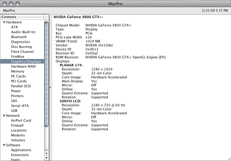

devDelay Posted March 15, 2009 Share Posted March 15, 2009 Here is the EFI code I used for my Sparkle 9800GTX+ 1GB w/ HDMI 700200000100000001000000640200000d00000002010c00d041030a010000000101060000030101 60000007fff04000e0000004e00560050004d0000002000000001000000000000000000000000000 00000000000000000000000000220000005600520041004d002c0074006f00740061006c00730069 07a006500000008000000000000401c0000006400650076006900630065005f00740079007000650 00000f0000004e5644412c506172656e740e0000006e0061006d00650000000b000000646973706c 17922000000400030002c006400650076006900630065005f00740079007000650000000b0000006 6973706c617922000000400031002c006400650076006900630065005f0074007900700065000000 b000000646973706c6179100000006d006f00640065006c0000001c0000004e56494449412047654 6f7263652039383030204754582b20000000400031002c0063006f006d0070006100740069006200 c00650000000e0000004e5644412c4e564d616314000000400030002c006e0061006d00650000001 0000004e5644412c446973706c61792d4114000000400031002c006e0061006d0065000000120000 04e5644412c446973706c61792d4220000000400030002c0063006f006d007000610074006900620 6c00650000000e0000004e5644412c4e564d6163100000004e005600430041005000000018000000 4000000000003000c00000000000007000000001e00000072006f006d002d0072006500760069007 0069006f006e000000300000004e5649444941204765466f7263652039383030204754582b204f70 56e474c20456e67696e65205b4546495d Link to comment Share on other sites More sharing options...
