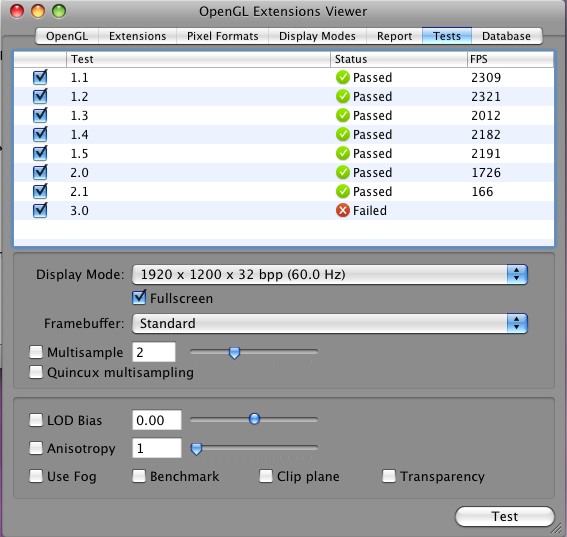

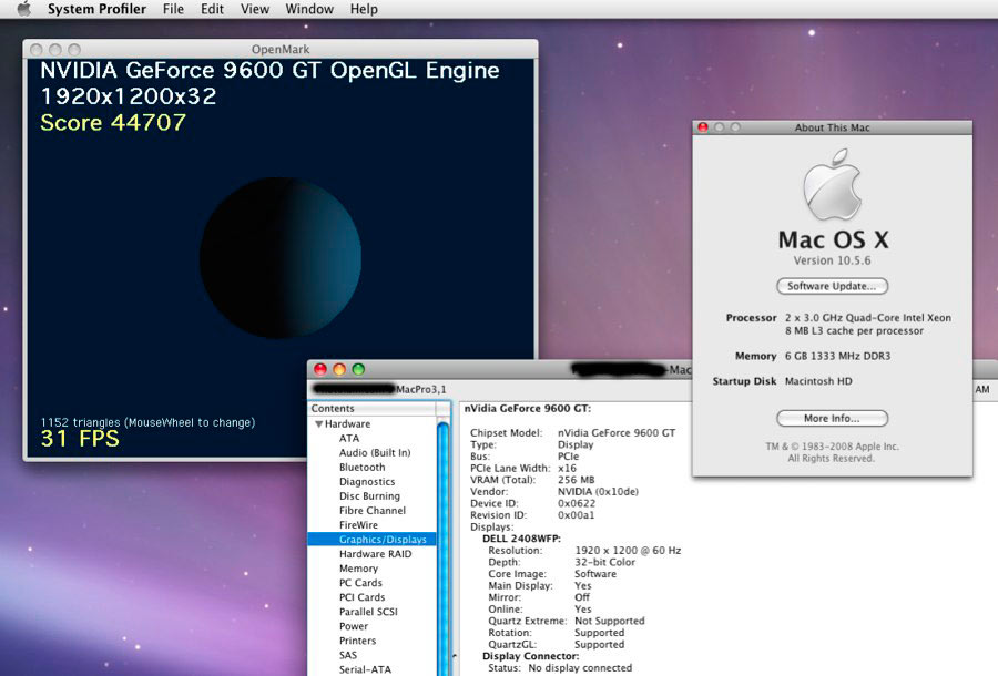

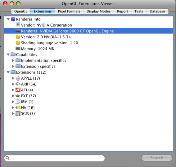

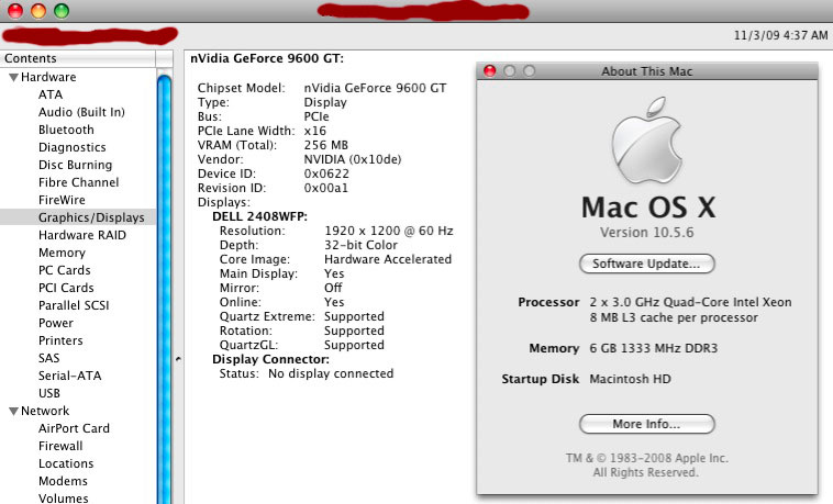

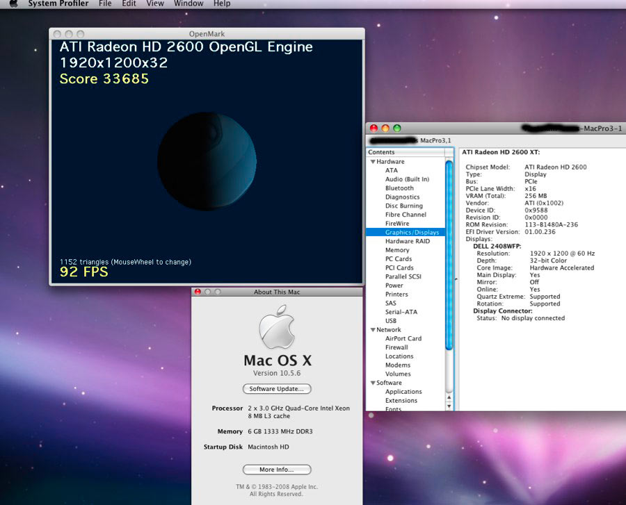

Joe S. Posted November 2, 2009 Share Posted November 2, 2009 I'm using Kernel.Voodoo 10.5.6 (by combo update) running on my i7 920/Asus P6T Deluxe V2 i have tried with 3 video cards and the result are... 1. ATI 4870 1G GDDR5 - Still not working 2. ATI HD2600XT 256M GDDR4 - Work great without any patch, OSX detected automatically & all functions work excellent 3. NVIDIA EN9600GT 1G GDDR3 - Just work! after many solution has tried ! Finally... i got my Asus EN9600GT 1G work with 3 simple steps... 1. Install ATY_init.kext (from netkas) 2. Install NVIDIA_9000_Series_Driver_v2 3. Then, Install device-properties string to com.apple.Boot.plist using OSX86Tools by... Run OSX86Tools Add EFI String / Boot Flag GFXString --> Custom GeForce --> NVIDIA 9600 GT --> Select VRAM --> Select NVCAP Import String To Boot Editor then, Press the button "Apply changes to com.apple.Boot.plist" then, i remove /System/Library/Extension.kextcache and repair permission using Disk Utility, reboot.... that look great after come back !! except CI/QE and QuartzGL not work... here my solution To Enable QuartzGL, using OSX86Tools... (up right button) To Enable Core Image / Quartz Extreme, try QE_CI_Exotic_cards_10.6.1.pkg then, i remove /System/Library/Extension.kextcache and repair permission using Disk Utility, reboot.... Then, everything work great for me *Please ignore the CPU information in About box - i'm using i7 920 Sample screen from test (before enable CI/QE) After install QE_CI_Exotic_cards_10.6.1.pkg package The result from GLViewer ...but, i've tested with GLView before/after enable CI/QE.. the result still the same number... it's just the word that make you smile, not the real CI/QE... i still waiting for the real solution to get the real power from this card... and this is the test result from my ATI HD2600XT 256M Link to comment Share on other sites More sharing options...
