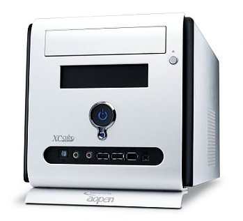

ISSUE RESOLVED:
128GB Hard Disk (PATA) limit issue on my XC Cube by Aopen, Spec below (different from my sig)
SPECIFICATION:
AOpen
XC Cube EZ855/EY855
ICH4-M
Pentium M 1.6GHz Processor
DDR PC3200 2GB
Chipset Intel 855GM
MSI GeForce 7600GS 512MB AGP8x DVI Passive Heatsink Mfr: NX7600GSTD512Z (working)
(QE & CI working by using kext posted on this website page. http://www.infinitemac.com/showthread.php?t=1851 (working)
Graphics and system speed got better after the 128GB limit issue got resolved!

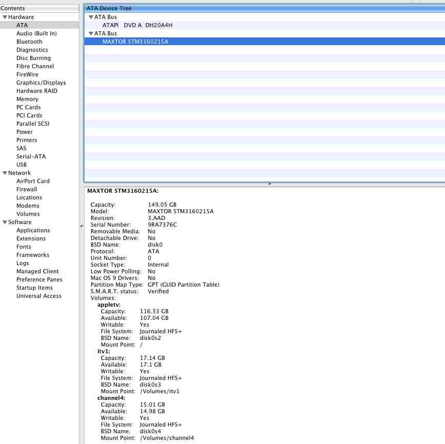

Hard Disk: Maxtor STM3160215A 160GB (IDE/PATA) (working)
128GB limit resolved by kext in this thread, you are reading. All partitions of 160GB showing now.
