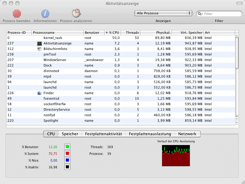

anyname Posted February 19, 2008 Share Posted February 19, 2008 I acidentally posted my question to the wrong forum part. It is here: http://forum.insanelymac.com/index.php?sho...t=0#entry631472 Can anyone confirm the kernel_task problem on a successfully installed Zephyroth installation? And yes, previous poster: I got this )or a very similar) problem trying to install on a VMWare Workstation, while it installed fine on my second real comuter. It seems to be a hardware problem (incompatibility issue). Link to comment https://www.insanelymac.com/forum/topic/88226-zephyroth-leopard-1052-for-amd-succes-or-problem-thread/page/3/#findComment-631633 Share on other sites More sharing options...

anyname Posted February 19, 2008 Share Posted February 19, 2008 I'll repost my question here: Has anyone of the successfull installers discovered a strange processor power behaviour of the Zephyroth installation? Can someone confirm, that the Zephyroth installation is constantly using abaout 50 percent processor power on an Athlon 64 4000+ processor? Installation was surprisingly successful (some minor screen refreshing issues while installing). And I was very happy at first. It even regognices an about 6 years old graphic tablet (for thre PC!) and supports it seemlessly !! Network, usb keyboard, sound, a windows trackball mouse ... all is working perfectly! But ...after a while playing arround with it, I discovered, that it uses constantly allot of processing power (even obviously doing nothing) ... That's a pitty, because a system which uses permanently 50 percent of a modern processor is quite a little bit useless to seriously work with, I think. Is there any workaround yet ??? Ah well, I forgot to say, that it is exactly the: kernel_task module, which uses constantly 50 percent of the power (seen in system profiler). Unfortunately I haven't installed some development tools yet to examine the problem in depth ... Link to comment https://www.insanelymac.com/forum/topic/88226-zephyroth-leopard-1052-for-amd-succes-or-problem-thread/page/3/#findComment-631670 Share on other sites More sharing options...

anyname Posted February 19, 2008 Share Posted February 19, 2008 So with EFI can we perform official updates? Also, is this only 32 bit, w/ only 1 core support? core and bit are completely different shoes. BUT YUCHHEEE !!! I got the kernel_task problem solved! If someone wants to know what I did, feel free to ask *smile* I'll publish the entire installation story later here ... Now I am really euphoric about that release! Link to comment https://www.insanelymac.com/forum/topic/88226-zephyroth-leopard-1052-for-amd-succes-or-problem-thread/page/3/#findComment-631684 Share on other sites More sharing options...

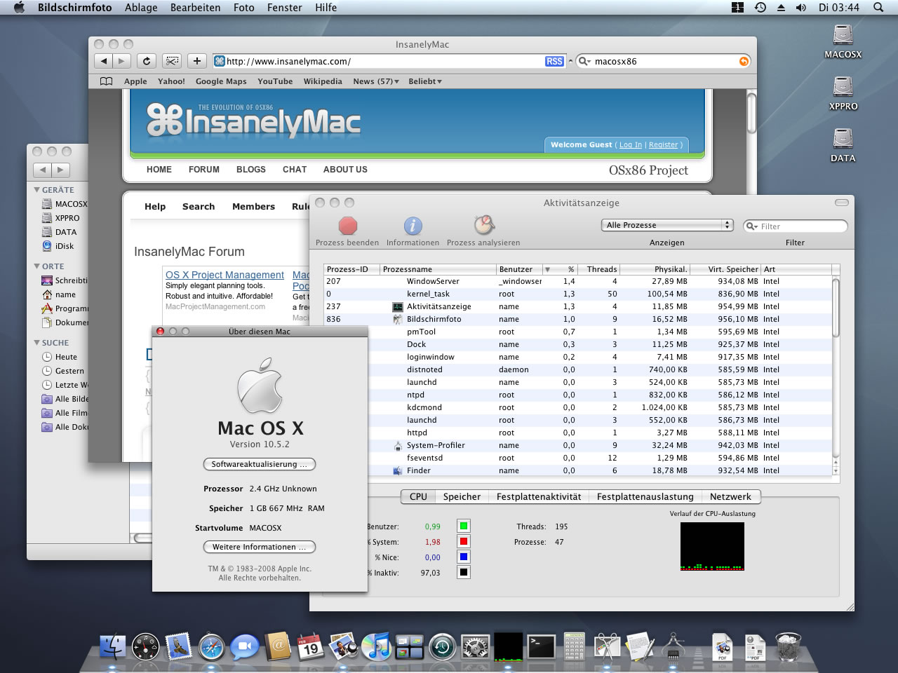

anyname Posted February 19, 2008 Share Posted February 19, 2008 Well, here is my success story! I installed on following constellation (there is a complete dumped out profile (MacOSX System Profiler) in PDF Format attached here): Motherboard: MSI K8T Neo2 v.2 (VIA K8T800 Pro + 8237R Plus Chipset based) Processor: AMD Athlon 64 4000+ (socket 939) Graphic: nVidia 6200 256MB DDR AGP8X, 64bit Dual RAMDAC 400MHz Drives: 2 IDE ATA Drives (IDE1 Master, Slave) MacOSX is installed on Slave Network: 1 = integrated on Motherboard, 2 = PCI Card (Realtec) Audio: 1 = AC97 (integrated on motherboard), 2 = SB (Creative) PCI 128 Mouse: 1 = Logitech USB Trackball Mouse, 2 = Noname USB Graphic Tablet by TCM (Tschibo Germany) Keyboard: Standard (illuminated) USB Keyboard (PC) DVD/CD: 2 LG SuperMulti DVD RAM Drives As mentioned, there is a complete and very detailled description in the attached "profile.pdf". All is working as expected. Even all the Quartz effects are performed smoothly! There seems to be a little problem when plugging in external USB memory devices. They are not recogniced obviously. And I did not manage to get Windows Filesharing and FTP via Network working ... but sharing via HTTP works fine. Shurely I have to test more intensively next. But it all works quite good, without the need of any manual intervention! Except one thingy so far: The second Network Adapter was not connected. This seemed to cause the processor to drive constantly about 50 percent ... I disabeled it and voila! The processor is acting normal now. profile.pdf Ok, so everything was running well , then I did some updates, consisted of mostly iLife stuff and Aperture, after restarting I can't even get the darwin loader, just a blinking cursor, what now?? For such reasons, one makes a system backup! I recommend "ACRONIS True Image 10". With this (PC) Tool you can boot up and save any partition (sector copy) to external or internal backup devices (including network and DVD) to save your propper installations. Even if you do updates like hell ... If anything goes wrong, you simply play back the backup and youre done! *smile* Link to comment https://www.insanelymac.com/forum/topic/88226-zephyroth-leopard-1052-for-amd-succes-or-problem-thread/page/3/#findComment-631750 Share on other sites More sharing options...

anyname Posted February 19, 2008 Share Posted February 19, 2008 Ah, well a screenshot of the insanely MacOSX86 Leopard 5.2 : i'm having issues after installing this...i goto reboot and it just sits at "verifying dmi pool data" and does nothing...any ideas? i should probably take out the second video card,that could be causing the problems right?dmi pool data ?that sounds like a BIOS dumpout, not a Darwin print ...maybe, it cannot boot from disk? Link to comment https://www.insanelymac.com/forum/topic/88226-zephyroth-leopard-1052-for-amd-succes-or-problem-thread/page/3/#findComment-631781 Share on other sites More sharing options...
