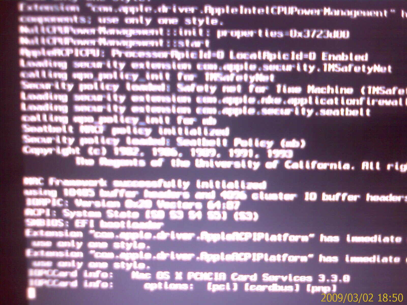

alh Posted March 3, 2009 Share Posted March 3, 2009 Hi. I got a device with id 1217:7135. I first tried the Leopard.kext with Jas 10.5.4 installation but it wouldn't work and would break my installation. Then I installed XxX 10.5.6 and with 10.5.6 kext I get the output in the image (sorry for the bad quality, all I had was my HTC phone) and then it freezes there. A couple of lines up, not seen in the image, are messages about using the newer versions of IOPCIFamily.kext and IOPCCardFamily.kext (I left the originals in the Extensions folder). Now I am also trying AnV's kext, and after adjusting memory ranges it also gives me an error Intel PCIC probe not found. Any ideas? Link to comment https://www.insanelymac.com/forum/topic/81036-cardbuspcmcia-pc-cards-for-leopard/page/39/#findComment-1096830 Share on other sites More sharing options...

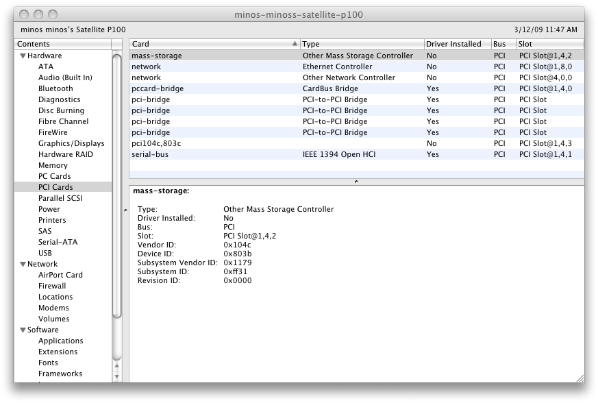

jazzminos Posted March 12, 2009 Share Posted March 12, 2009 Hi everyone! When I updated from 10.5.5 iATKOS 5i I experienced a problem with Intel Pro 100VE (0x10928086) Ethernet card. Card is always "cable unplugged" state. I tried everything from the topic about Intel Pro 100VE ( http://www.insanelymac.com/forum/index.php...4840&st=160 ) I installed LATEST IOPCMCIAFamily.kext (10.5.6 ONLY). After using dmesg | grep PC as root Terminal says: ********************************************************************* sh-3.2# dmesg | grep PC OpenHaltRestart: 2008 \M-B\M-) COPYRIGHT PSYSTAR CORPORATION (www.psystar.com)Extension "com.apple.driver.ApplePCIConfigurator" has immediate dependencies on both com.apple.kernel and com.apple.kpi components; use only one style. IOPCCard info: Mac OS X PCMCIA Card Services 3.3.0 IOPCCard info: options: [pci] [cardbus] [pnp] IOPCCard info: Intel ISA/PCI/CardBus PCIC probe: IOPCCard info: TI XX12 rev 00 PCI-to-CardBus phys mem 0xd0108000 virt mem 0x48269000 IOPCCard info: host opts [0]: [serial pci & irq] [pci irq 17] [lat 168/176] [bus 2/2] IOPCCard info: PCI card interrupts, PCI status changes Got boot device = IOService:/AppleACPIPlatformExpert/PCI0@0/AppleACPIPCI/SATA@1F,2/AppleIntelPIIXATARoot/PRID@0/AppleIntelICHxSATA/ATADeviceNub@0/AppleATADiskDriver/IOATABlockStorageDevice/IOBlockStorageDriver/Hitachi HTS545050KTA300 Hitachi HTS545050KTA300/IOFDiskPartitionScheme/Untitled 1@1 sh-3.2# ********************************************************************** Can this help understanding problem with network adapter? Thanks for attention. With great respect, jazzminos. Link to comment https://www.insanelymac.com/forum/topic/81036-cardbuspcmcia-pc-cards-for-leopard/page/39/#findComment-1105149 Share on other sites More sharing options...
